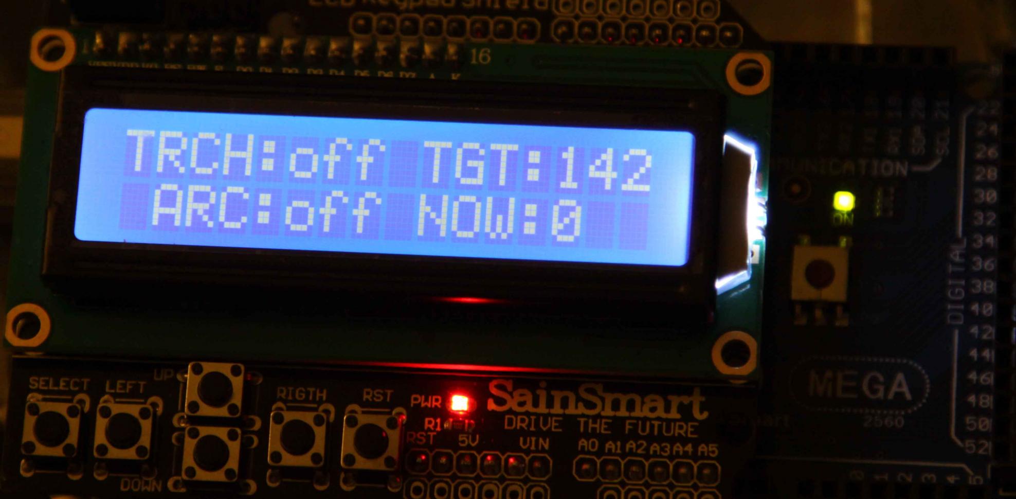

    During operation I would display the target voltage and the current measured voltage with a display updating time that allows you to read it, say somewhere around 2 to 4 updates per second, and the typical up down indicators for torch motion signals. Other than that, I like your menu structure.
    Thanks Ram.
    I menu I have now gives:
    • Torch on Status (on/off)
    • Arc good status (on/off)
    • target voltage
    • current voltage
    The display is too small to show the up/down arrows, but that makes sense. I'll have to abbreviate more.
    Sean's question made me realize that I should have an option to set the cutting voltage based on what's current. That would allow you to start cutting manually and hit the button to get the initial voltage setting.
    You comment on tip deterioriation over age makes a "cut time" timer make sense. Once that's in place and its understood, it could be compensated for automatically. Would you only track the time on the tip or would you also track electrode or swirl ring time separately?

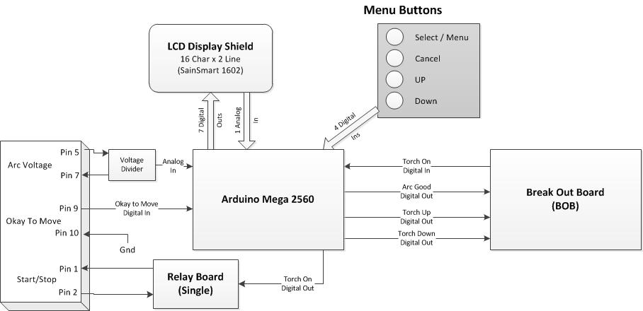

    Here is a diagram of the hardware configuration I currently have.
Name:	Block Diagram.jpg

    I would keep the Calibrate option. Since there are inline resistors in the full arc voltage output lines and several possibilities of voltage divider circuits (external and internal) It would be nice to be able to measure at the torch and calibrate the system to read correctly. That way you can use published data tables as a starting point for materials you have never cut before, and be pretty close right off the bat.

    I'm using a PP50.
    The pp50 has a CNC connector with arc voltage, divided volts, ok to move, etc? I wasn't aware of that, I thought only the 60C had that?
  14. #34
    From what I understand even older versions of the PowerPro 256 used to have that. I'm sorry they dropped it, but I understand the decision.
  15. #35
    I got my PP50 a year ago, and it has one. I'm pretty sure they still come with the connector.

    The Arduino boards use ATMEL processors. The board I'm using (Mega 2560) uses the ATMega2560.
    The interface between the Arduino and the PP50 is the Arc Good (PP50 dry contacts out) and the Torch On (Arduino dry contacts out) and the arc voltage (PP50 analog out). But, it seems that the arc voltage might be an isolated signal. So, with the Ardunio sitting inbetween the BOB and the PP50, I don't think the I/O needs any additional isolation (though, I'll be curious to see if I have noise issues). I just haven't tested the theory yet because I wasn't ready to blow up an Arduino if I'm wrong. (My table is the priority now and this is just a time filler.)
    Longer term, I thought that adding a serial interface to the PC would provide the ability to add a lot more functionality. But, I'm trying to keep the hardware as simple as possible. I did find a complete one chip solution (isolated power supply, TTL to RS-232 and isolation). While it was $19, which wasn't bad for everything in one package, it turned out to be a BGA package.
    So, for now I'm not going to worry about the serial interface until I get the standalone THC working. (My table construction is complete, I have to start wiring everything and setting up Mach).
