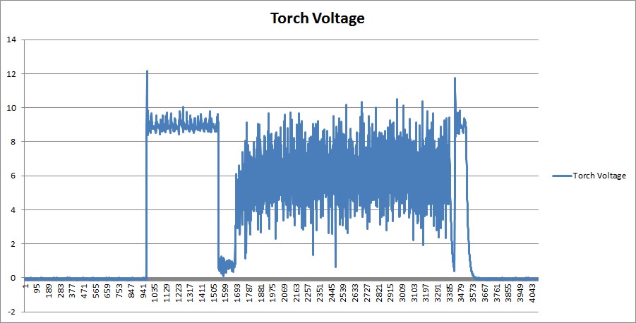

    I also did a capture of the voltage on the CNC output port. Here's what I got.
    I captured the voltage on pins 4 and 6. I didn't change the voltage divide jumper, but with a peak voltage of a little over 12 volts, it looks like the jumper is already in the 1/16 position. The X axis shows the sample number. The samples are 20 ms. apart.
    From the graph, I'm guessing that the intial full voltage is prior to the arc igniting. I would guess that the voltage drops on ignition and then recovers as the torch stabilizes. Does that seem to make sense?

    I understand the pin out. I'm actually trying to understand the behavior of the voltage output so that I can write my own THC software. The graph shows the noise on the output with the divided voltage.
    I do plan on looking at the noise on the undivided voltage to compare noise levels. However, I'd prefer to use the 1/16th voltage over raw voltage if the noise is comparable.
    I still don't get what the front panel switch does though.

    Some controllers flip a relay on and off (2T) , some pulse (4T), so the 2T and 4T can handle either.
    On the graph, was that just firing the torch and pilot arc, but not cutting anything?

    I'm using a PP50.
    This was a quick/informal test. I didn't do anything with respect to shielding, ferrites, etc. I just wanted to see some waveforms.

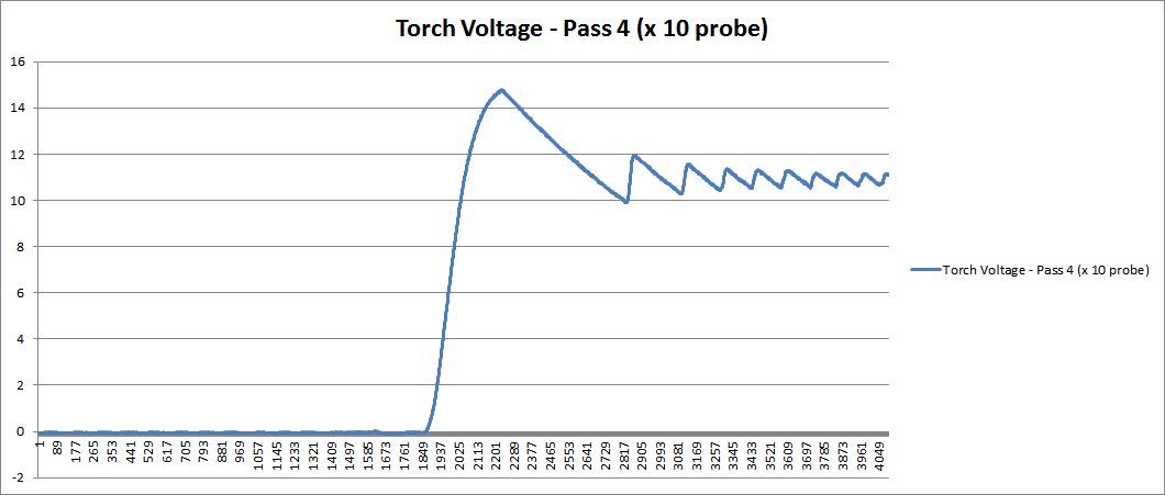

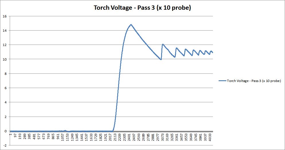

    Default Full Arc Voltage Graph
    Keeping with the prior theme - cheap I'm using one of the open source DSO201's (Digital Storage Scope 201). It is an iPod sized o-scopes that is about $70 on ebay. Its not a precision instruments, but "blunt instrument" seems fine for this exercise. (I haven't had a chance to compare it to a real scope.) And, its better for visualization than a meter.
Name:	Pass 3 - Full voltage start.jpg
ID:	7625 Click image for larger version.
Name:	Pass 4 - full voltage start.jpg
    I was using a divide by 10 probe. It looks like the noise at start-up (pilot arc only) is around 20 volts and dimishes to about 3 or 4 volts. So, from a filtering viewpoint - using the full voltage output instead of the divided output would be significantly better. (No real surprise there.)
    The odd thing is that you don't see the voltage drop out on these graphes that were on the divided voltage graphs. I'm guessing that's a scope quality issue. I did these captures at 200 micro seconds and the divided voltage ones at 20 milliseconds
    I haven't yet tried to cut steel while capturing the voltage as I'd need three hands to do that safetly.

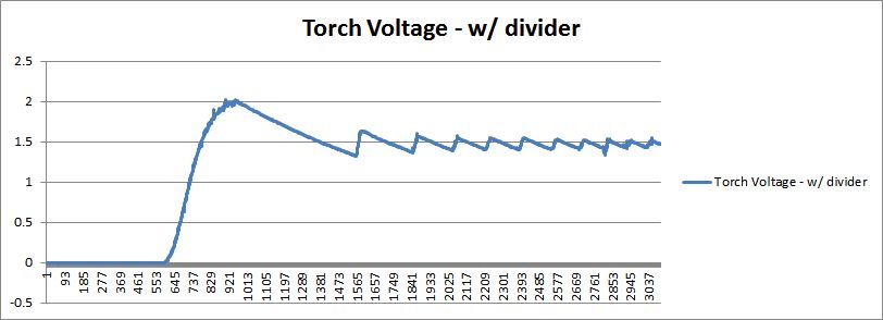

    Default Voltage with Divider
    So, I used a 100K ohm and a 2.2K ohm for a voltage divider.
    If I metered the raw output, it was around 140 volts. Based on the voltage divider it should read 3.014 on the o-scope. It looks like I'm getting about half of that. But I guess that's due to the resistors in the CNC interface.
    I guess the thing I don't understand is that I thought the torch voltage is negative. But I'm reading a positive voltage. Is that because the signs are reversed on the CNC port pin-out description?

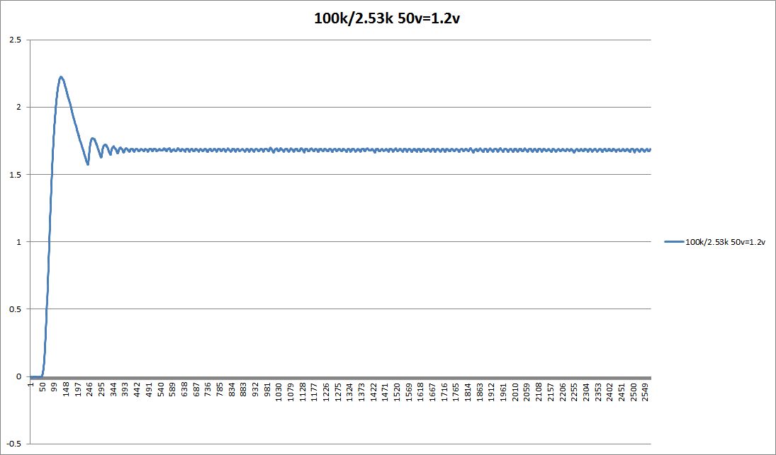

    Default Voltage divider captures
    I ended up with a voltage divider of 100k and 2.53k. This gave me a divided voltage reading of 1.2V while the full output voltage was at 50V.
    The voltage reading I used was a meter on the output. The difference between the meter and the scope is the scope is about 0.4 volts higher. I trust the meter more than the scope (scope is a DSO201 and I used two different meters). The graph below shows the full voltage with my divider and using a 100 mf filter capacitor.
Name:	100k-2.53k 50v=1.2v.jpg

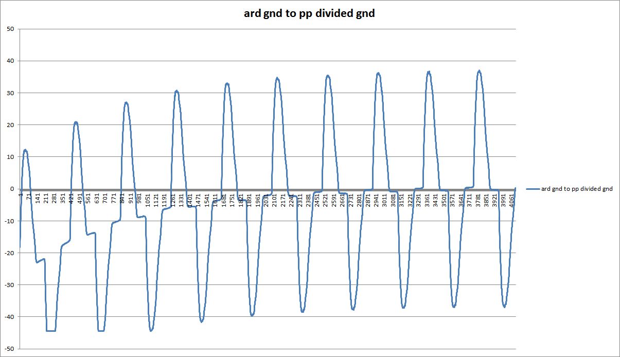

    I still don't understand why I'm not seeing a negative voltage on the output of the CNC port since the cutting voltage is negative.
    I did connect both my scope and my meter between the CNC port outputs and the ground on an Arduino board (running on A/C). I check both the positive and negative torch voltage outputs (one, then the other) against the Arduino ground.
    When powering up the Arduino, the meter reading jumped on very quickly (too fast to read), but then settled at around 84 milivolts. The scope traces for both are the similar.
Name:	ard gnd to pp divided gnd.jpg
    I'm not sure what's going on. I'll talk to my consulting electric engineer tomorrow to see if he can shed any light on what I'm seeing. Any thoughts anyone else has would be appreciated.

    I was under the impression that the torch outputs were basically isolated from ground, so that all measurements must be taken between them and not referenced to ground as far as cutting arc voltage is concerned?
    If that's the case, it might make the A/D circuit simpler. I'm under the impression that if the voltage is isolated from ground and its negative, you can just swap positive and negative and read it as a positive voltage.
    Can anyone from Everlast weigh in on isolated grounds?
    I wonder if the fact that I've only dealt with the pilot arc voltages so far figures in in any way too.

    I talked to my consulting electrical engineer. He agreed that it's probably an isolated supply. He thought that the a/c wave form I saw between grounds was probably just noise and so low a current it wouldn't be an issue.
    I got the voltage divider set up. The calculated values weren't giving me the expected voltages. I believe that it's due to the existing resistors in the CNC interface. So, I went with the "scientific empirical testing model". I just kept trying different resistor combinations until I got the voltage I wanted
