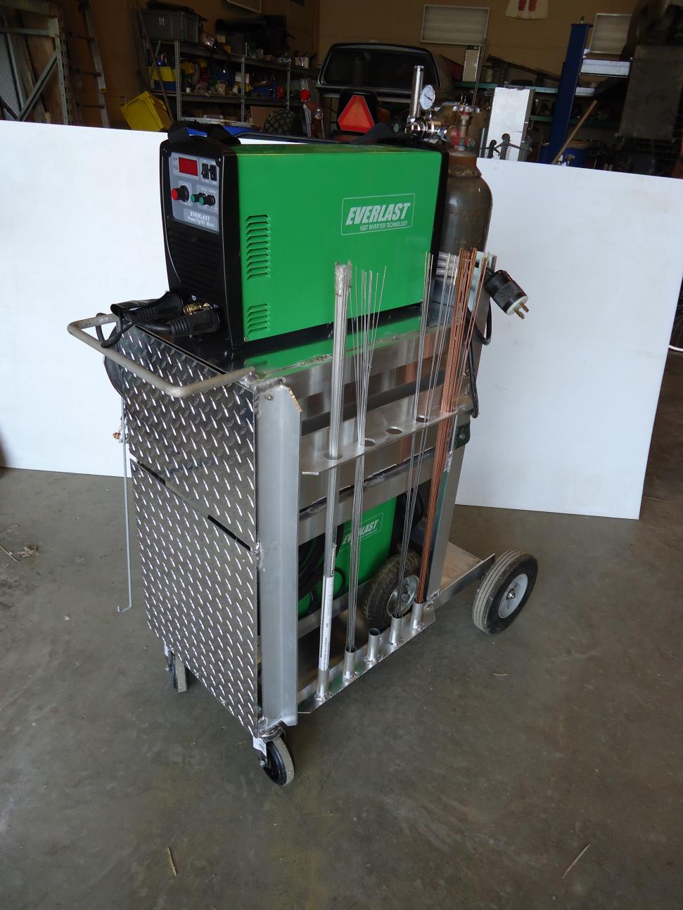

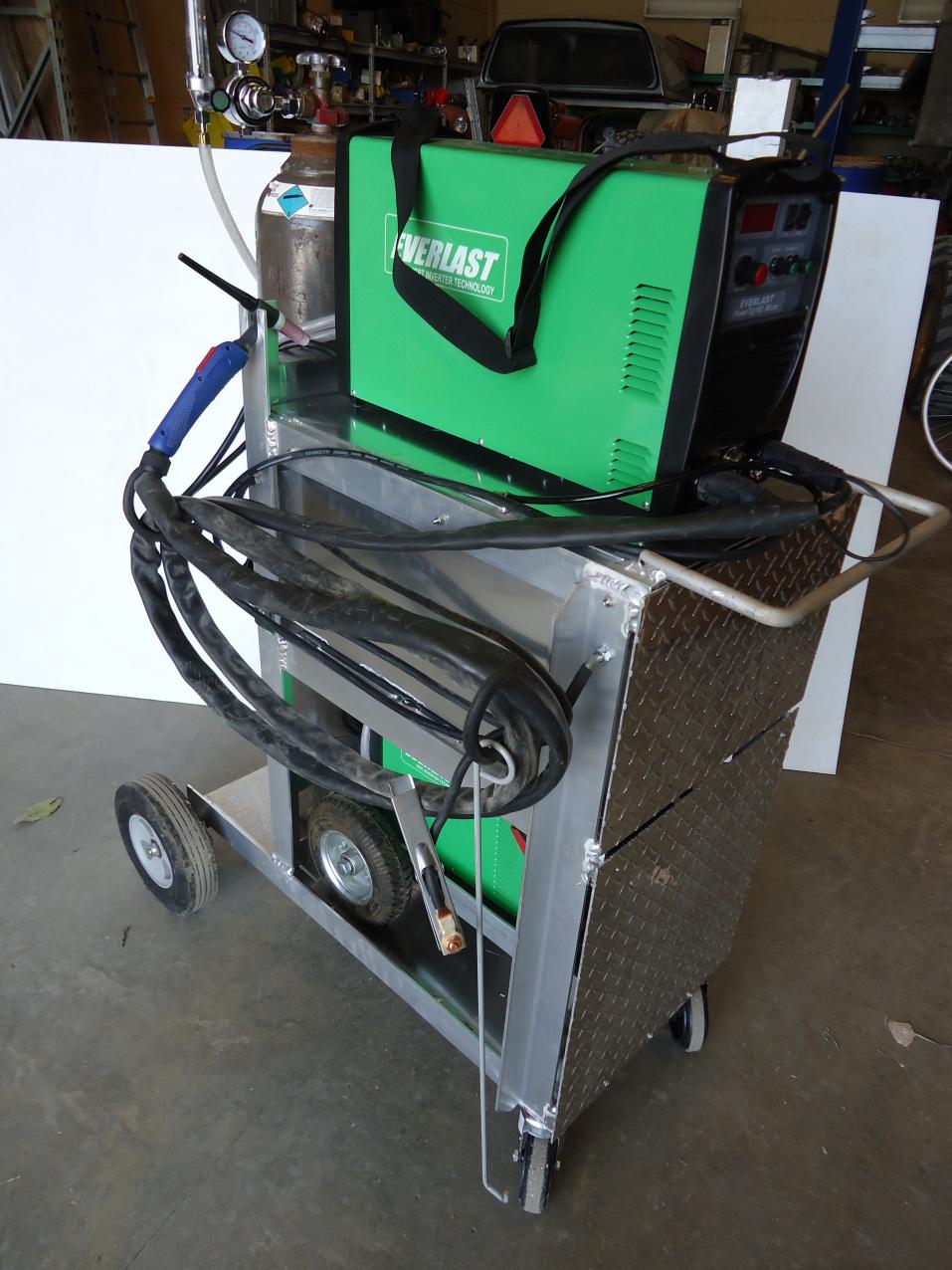

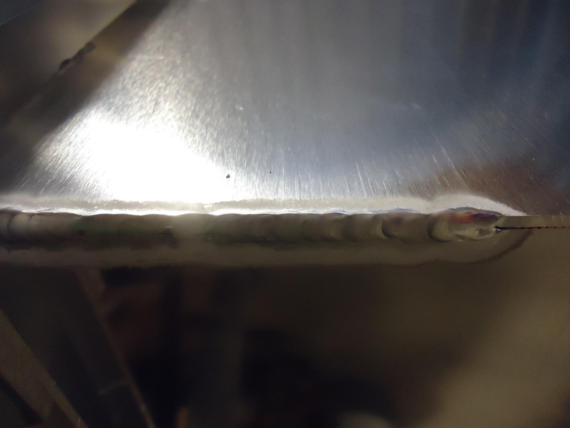

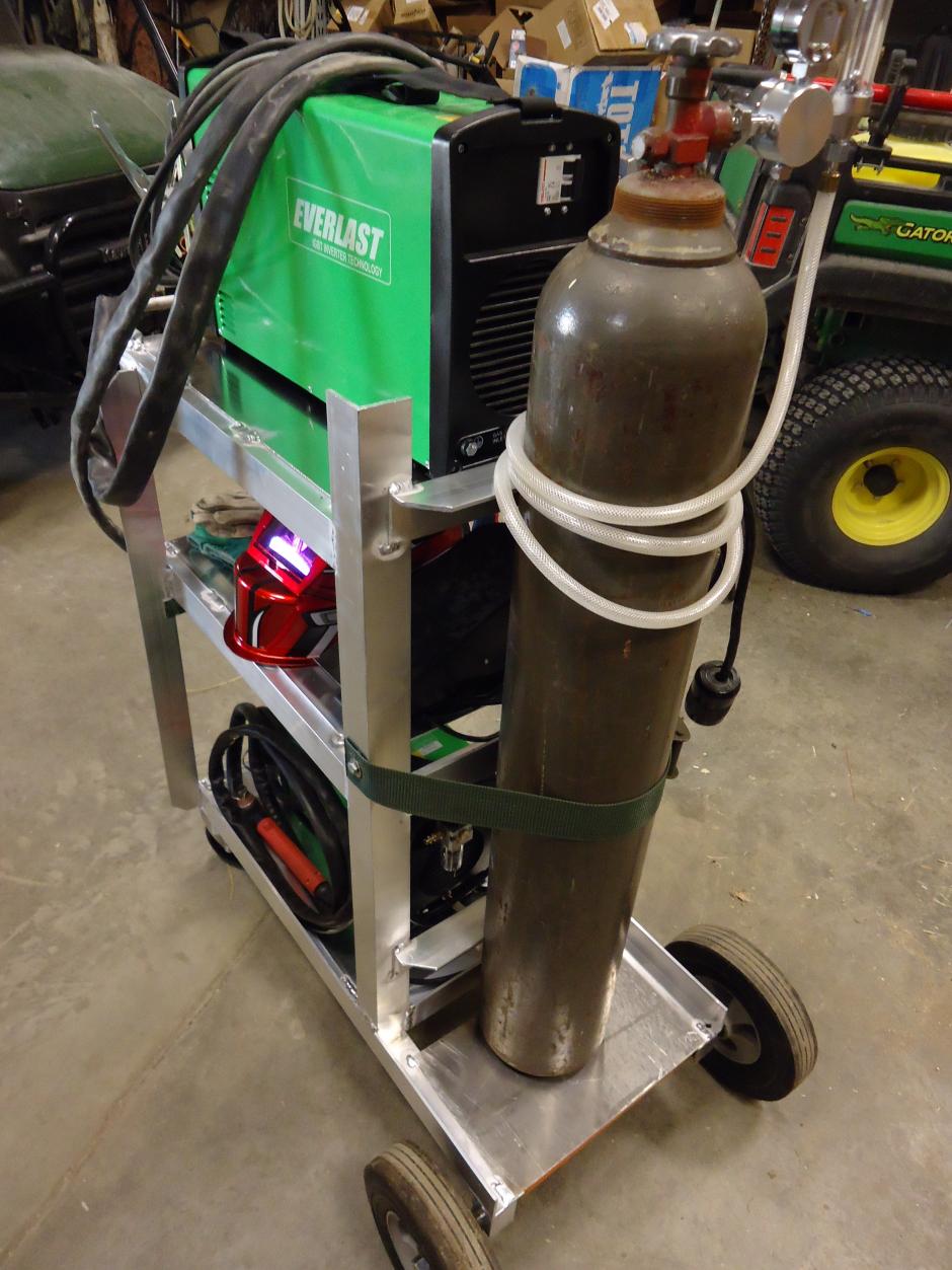

    Here are a couple of pics of the new cart i am building, I used 2x2x.200 Aluminum angle for the frame and .100 aluminum sheet for the shelves.All the angle and sheet was cut in the wood shop on a 16" radial saw or 12" mitre saw,sheet was cut on a 10" table saw with 80 tpi blade. I made the tank brackets out of angle also and cut a half moon shape in them to hold the bottle. Used a new military strap with a spring loaded latch to hold the bottle.The tires i have had for years and figured i would use them someday.I used a piece of pipe for the axle and inserted a 5/8" bolt in each end and welded it to the axle to serve as a spindle, a locknut was used to hold the wheel on the spindle.Had to go to HF and get 2 casters for the front mine all mounted different and would not work.Some of the welds were to say the least difficult my nerves are gone due to disease and i am not as steady as i used to be but they all worked out and after a little bit of fine tuning everything is good.Click image for larger version.

    I will post more pictures next week as this cart is long from done i have some interesting things to add next week.My old hospital cart from the earlier pics is now back to its original use short steel and clamps is what it's for.Hopefully i can get some welds that allow you to rest your arm and not be free hand.

    Very nice cart! Do you mind me asking what you have in it for cost? I like it.

    So far $12.00 in casters, $1.00 per pound in aluminum ( 35 pounds ) everything else i had

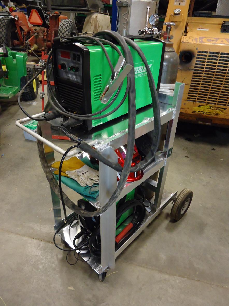

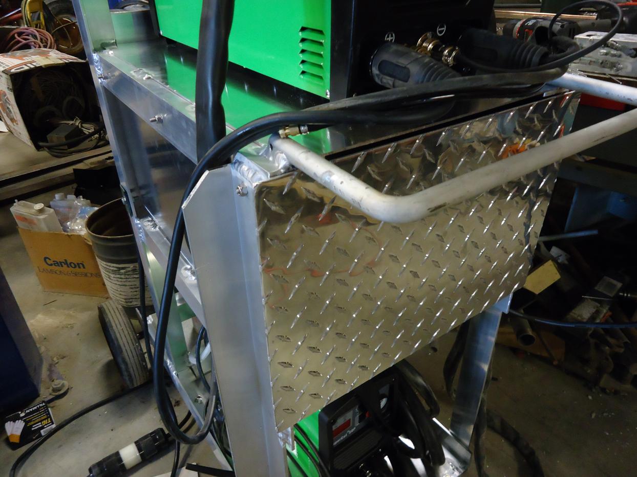

    Phase 2 has been added, I fabricated a new roll out drawer 23" long x 14" wide x 11" high, Used .100 aluminum sheet some .100 aluminum tread plate and 2- 24" ball bearing drawer slides. Gives me a place too store my hood ,sleeves ,gloves tig consumables and tungsten along with the pedal. I left the drawer sides hang out on each side about 1 1/4" to act as a pull area to open. Also included a picture of the stich welds on the drawer edges used 1/16" filler rod 120 amps gas flow 9cfm, and 3/32" 2% ceriated Tungsten.Click image for larger version.

    That's a good start. Keep us updated as you add and grow it.
    Very clean and light weight, I have TIG/MIG/Plasma on a steel cart. Pain to move it around. I think you have the right balance there.. And a big drawer is great. Wish my Tillman's were that clean, great choice in gloves.
    Awesome price! Nice work on the cart and drawer.

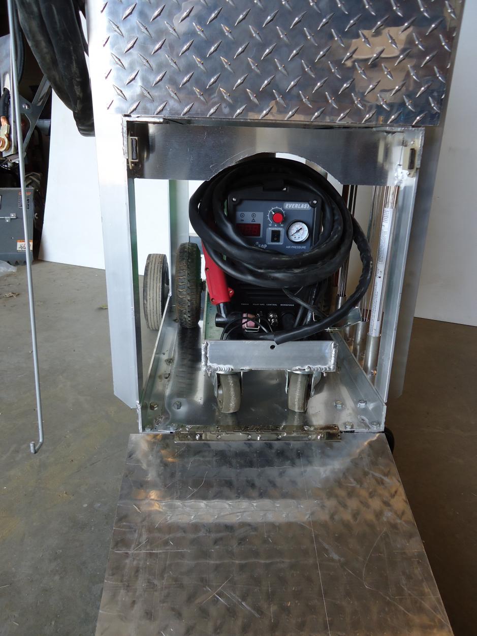

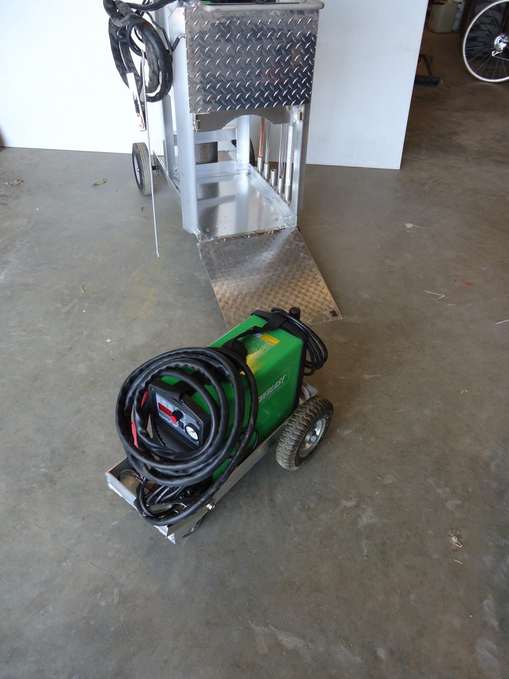

    ]Well i have finished with my cart, i added many other options to a standard cart design that i needed for my use. The cart was built from 2x2x.200 aluminum angle and .100 sheet, I added a drawer and got it functional.The next step was to make the plasma portable also for the simple reason it will go places like outside.I added a fold up door combo ramp and a couple of magnetic catches to hold the door closed. A little cart was fabricated from some angle and a couple of pneumatic tries i had and 2 casters added a removable handle to pull it around outside.I added some .060 6061 tubes to hold small amounts of filler rod on the cart. The to 2 angles on each rear upright were notched to make a place to hang the torch and the cord. I had a couple of SS Steel coated hooks with wood thread on them removed that and threaded them 3/8" -16 to hang cables on.My cost is less than $65.00 as the aluminum sheet and angle came from the scrap dealer.Click image for larger version.

    Very slick. I like the roll out plasma cutter. Maybe add a rope to pull it around with. Price is not bad either. Lighter than steel too.
    Nicely done! I like the portable plasma cart too. The ramp is a cool idea. I saw the first picture and was wondering how you were going to get that guy out of there!

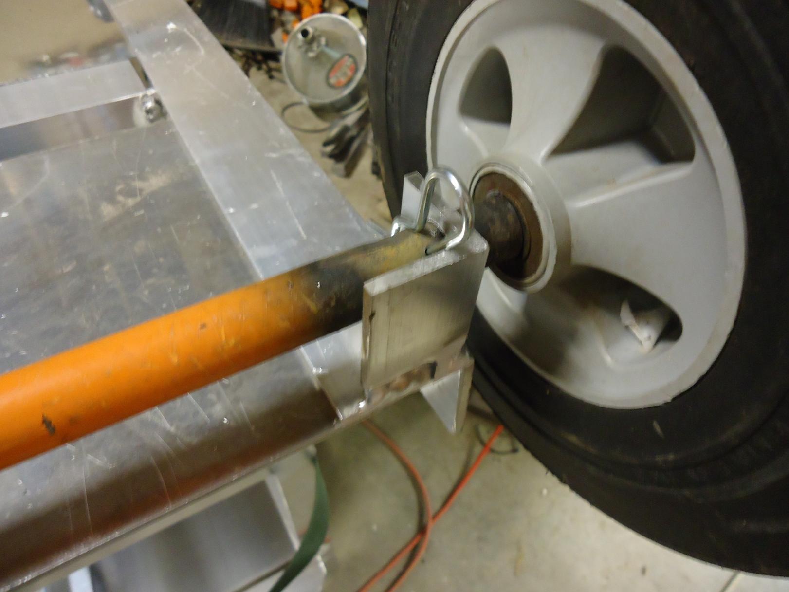

    Default Cart handle
    The handle is hanging on the LH side of the cart, used a piece of 1/4" round steel with a loop on the end to hold it and a hook to grab the cart
