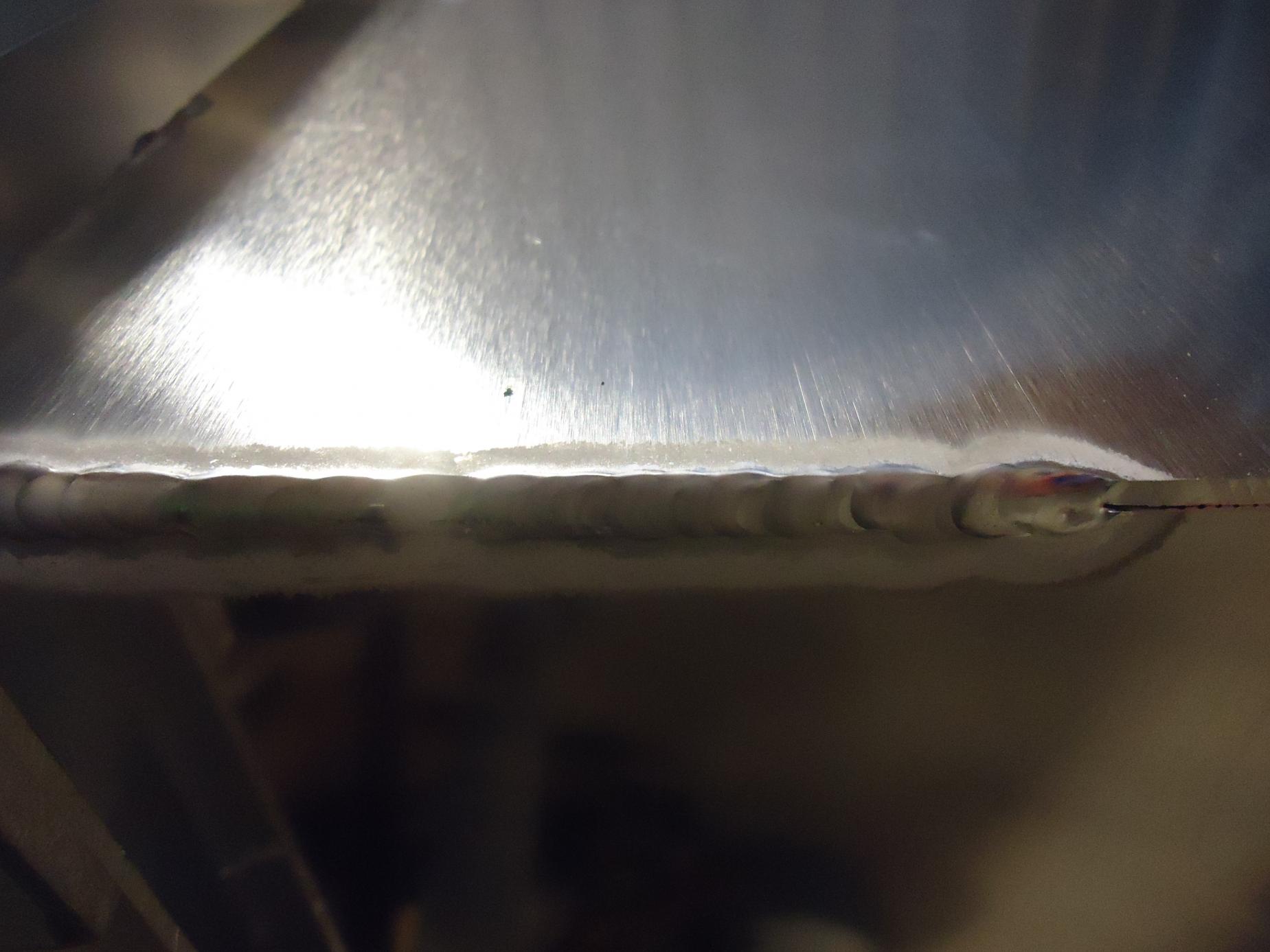

    Phase 2 has been added, I fabricated a new roll out drawer 23" long x 14" wide x 11" high, Used .100 aluminum sheet some .100 aluminum tread plate and 2- 24" ball bearing drawer slides. Gives me a place too store my hood ,sleeves ,gloves tig consumables and tungsten along with the pedal. I left the drawer sides hang out on each side about 1 1/4" to act as a pull area to open. Also included a picture of the stich welds on the drawer edges used 1/16" filler rod 120 amps gas flow 9cfm, and 3/32" 2% ceriated Tungsten.Click image for larger version.

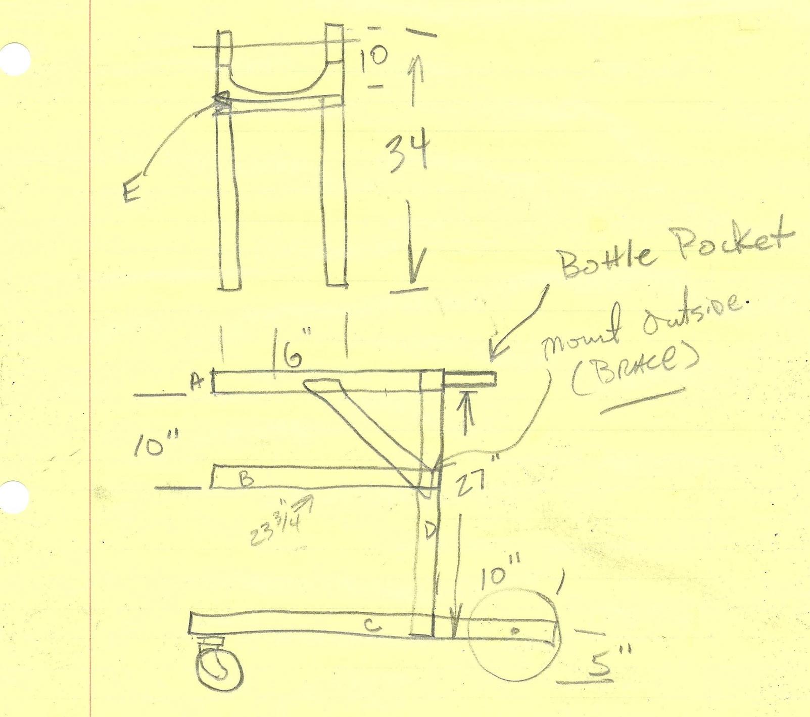

    I found my note pad in the shop today this was the first and only sketch i did, I just don't use cad anymore i have done to many drawings over the years.Click image for larger version.
