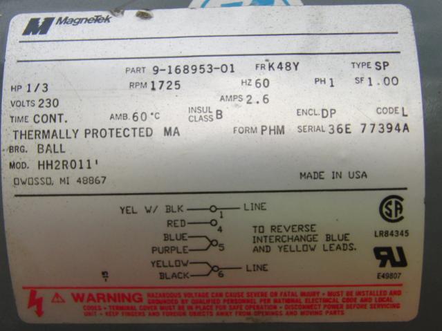

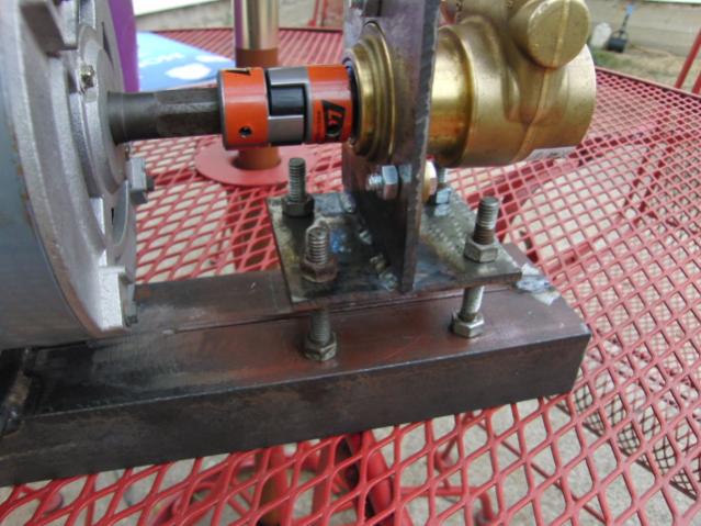

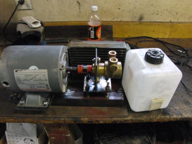

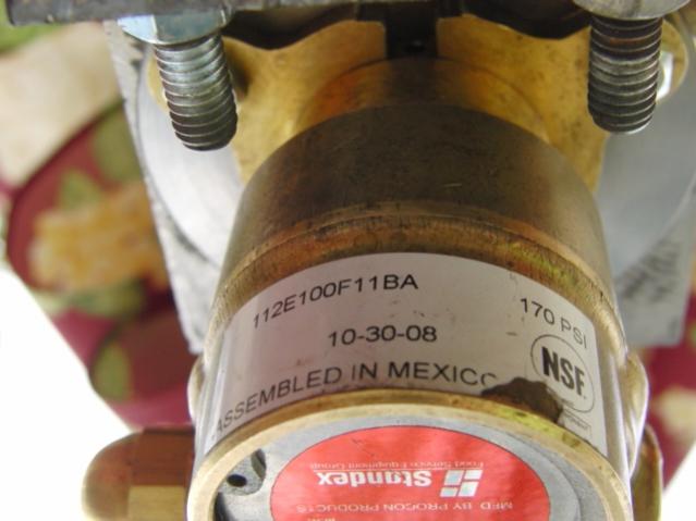

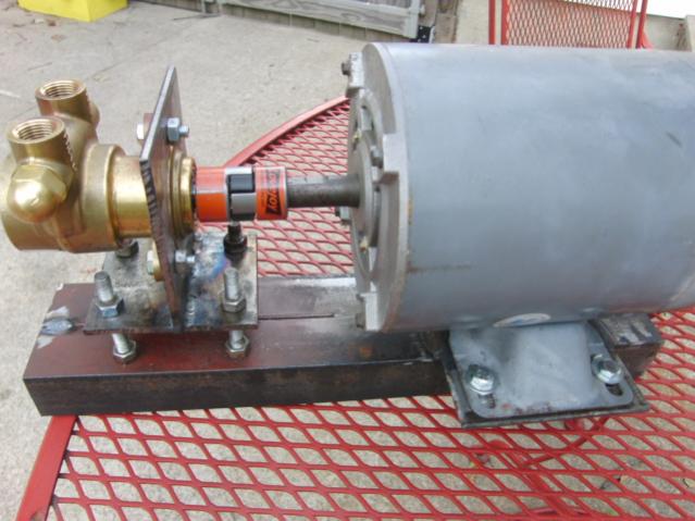

    I finally have everything together to start my water cooler project. I made the mistake of ordering an electric motor off of ebay that was shipped from somewhere in Alaska. It took a month to get here. The price was right though. Its a 230 volt 1/3 hp at 1725 rpm. The pump is a Procon pump from ebay that was new old stock. I'll post pictures tomorrow as I continue working on it.

    On demand small sprayer pumps work well. They are available in 120V. You don't need but a gallon a minute or less flow.

    It's compact too. Overall fairly quite and has a switch in it for "demand" running, which turns the unit on and off based off of pressure... Also has a chemical resistance factor. They'll run hours on end if needed.

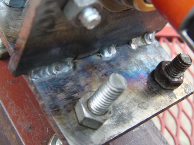

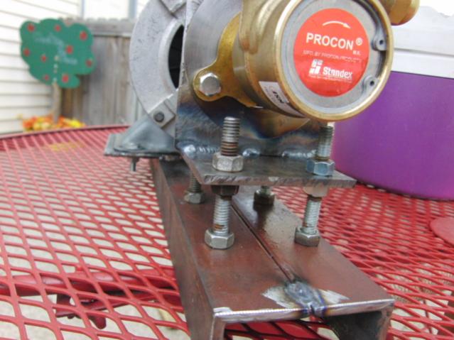

    My first idea was to use a diaphram pump like that, but I was concerned about how long it would last running hours at a time. Also, It ended up being the same price to buy the pump and motor I got. I only spent about 90 dollars on the pump, motor, and the lovejoy coupler. here are some pictures.

    I'm going to break down and build a tig cooler. I've been looking at pumps on amazon as well. I was going to build a tank myself for the tig time, and use a transmission cooler since they are cheap! How many gallons of fluid should your tank hold?
    It all depends on what kind of cooling you have. I have a Bernard cooler that looks almost garage made. It's basically a stainless tray from food service, and one of those Procon pumps mounted to one end of a dual shaft motor, with a fan on the other end and something like a heater core for it to blow over. Nothing fancy at all. Holds a couple of gallons max. Yet I think they want quite a bit of cash for them. (This one came with a welder.)
    The shop next to mine had about the simplest design I've ever seen. The guy built an aluminum tank about the same size as his argon bottle about 9" square and four or five feet tall. It fit in his cart where a second bottle could go. Then he just had a submersible fountain pump in the bottom, feeding his torch. Not even any fittings, the hose and cord came right out of the top. It held enough water so it could just dissipate the heat and no fan or cooler was needed. Hot went in the top and cool was pulled from the bottom. I saw him weld aluminum all day at 300 amps with no problem. Not the most portable design, but simple and did the job. I'd estimate he had around 15 gallons in there.
    Here is one version.
    I don't even know how much my little tank holds. maybe .5 to .75 gal. I got it for free so I can't complain. I would think that its size isn't too important though.

    If you are using the reservoir itself to dissipate the heat like Rambozo's friend then size would definitely matter. With a radiator/fan setup, not so much.

    If cheap is what you want, a couple of milk jugs drilled and tapped would work for that matter.
    The size of the tank is farily important as it does provide additional cooling. Our 300+ amp water coolers use a 2 gallon reservoir.
