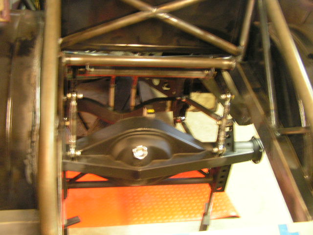

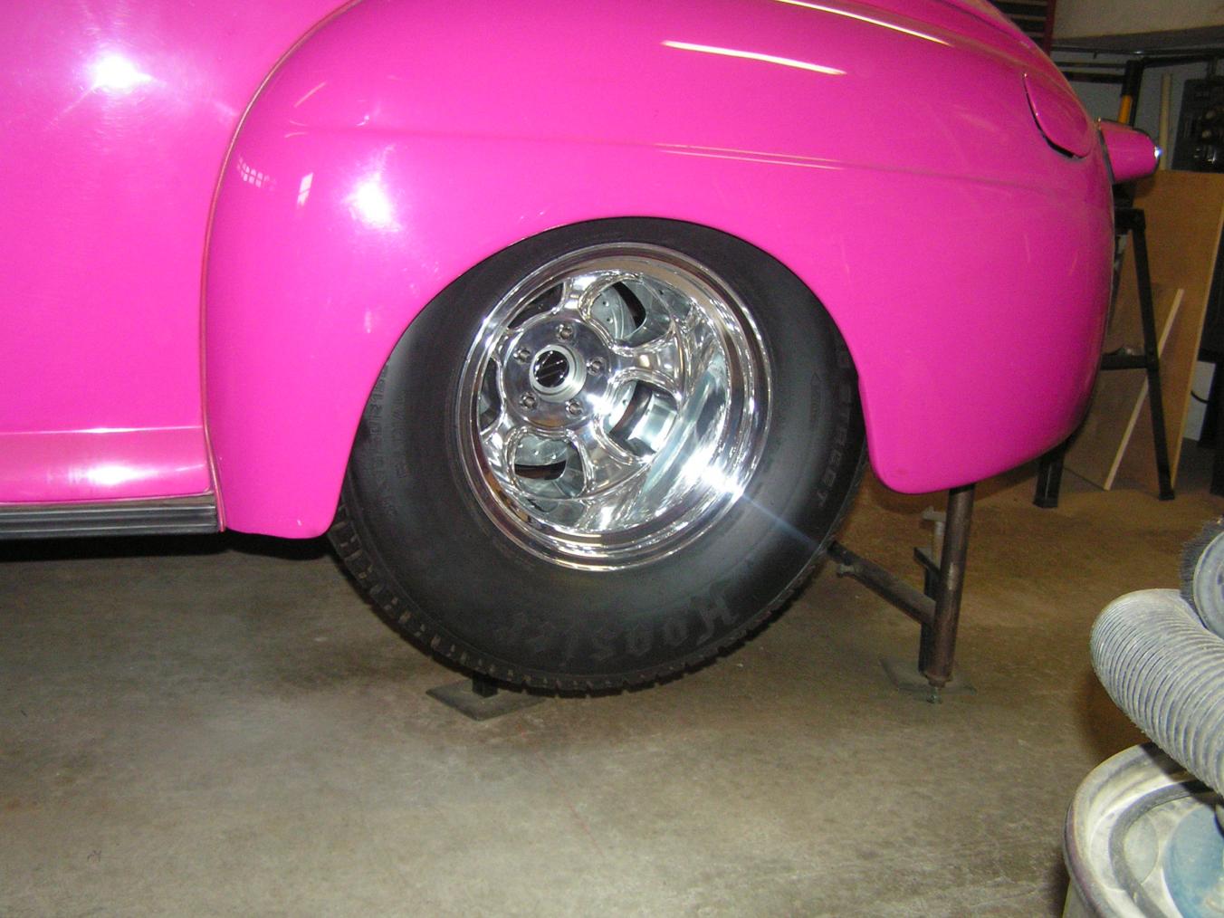

    Here are a couple shots.
    Tire fitment.

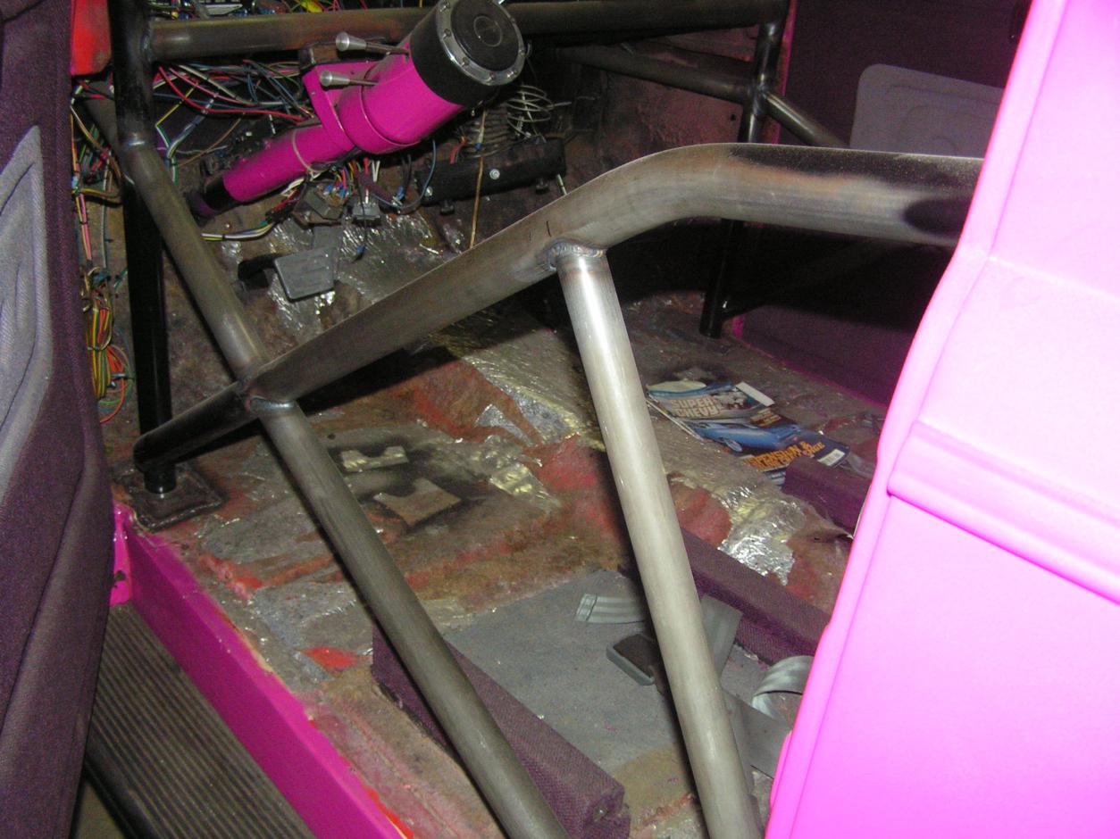

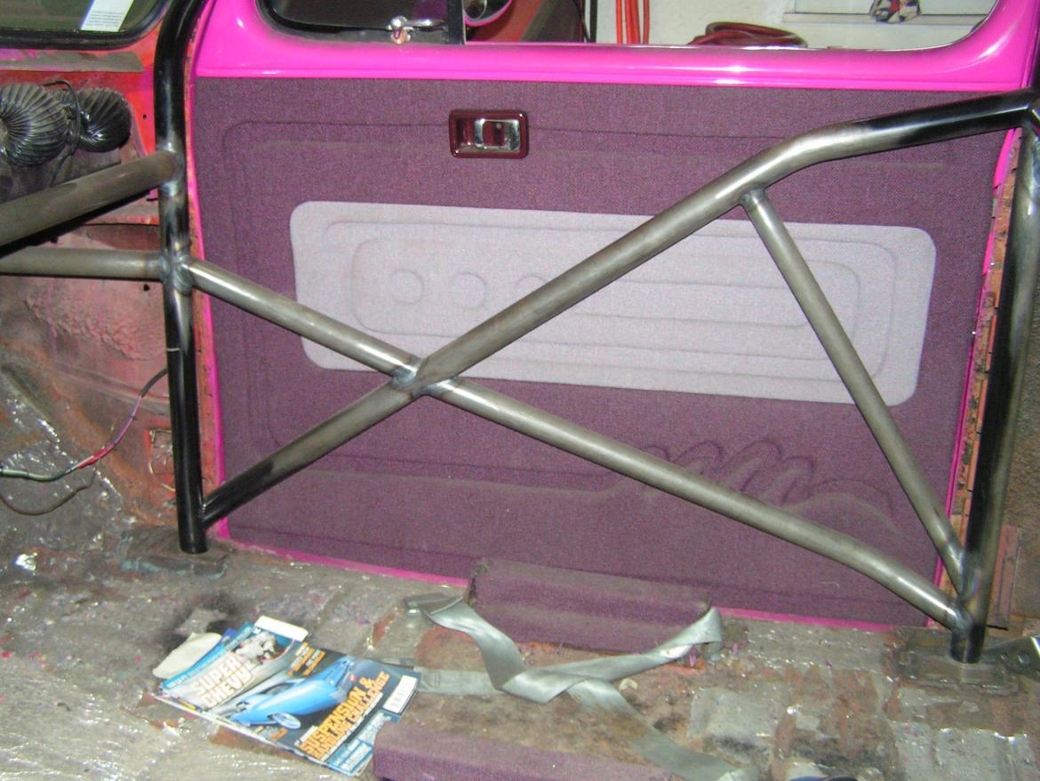

    Door bars

    Here's the shot of teh trunck area.

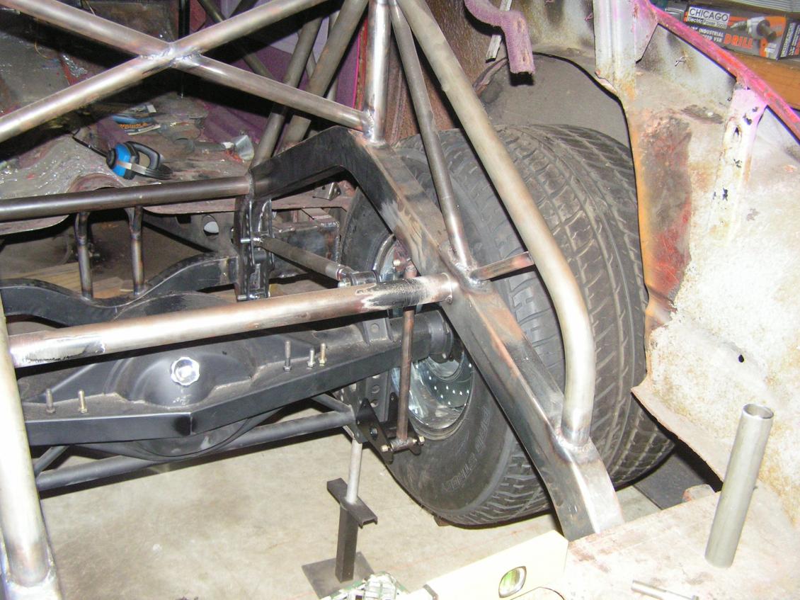

    Very nice. Keep the project pictures coming. Looks like an expensive hobby, but that is a cool looking ride. I kill the dup picture for you.
ID:	9125Click image for larger version.
ID:	9126Some additional progress images.
