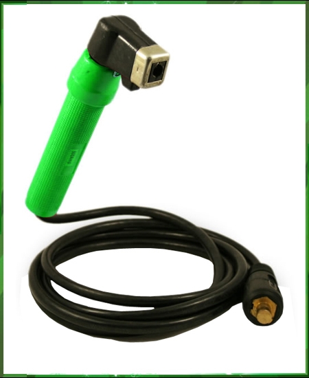

    did they give you a price on the 210ext . Me myself i have been super happy with my 250ex no problem on 1/4 or thicker stuff welding . bought the big power arc 300 wow it kicks but welding thick stuff . only thing i don't like on the 300 is the short leads about 3 times longer in length would be nice .

    Rod, it takes about 5 minutes to add more cable to those leads. Just like most any other welder like this, you add the amount of lead you want.

ID:	7605all ready made new leads and tossed that funky rod holder in the trash and installed a good one lol
