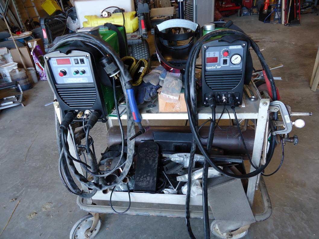

    Here is a pic of an old hospital cart that i found at the scrap yard for 50 cents a pound, i have used it for many things and put the new tig and plasma on it until i get my NEW Hybrid dual purpose welding cart done.The new cart will be aluminum and a dual purpose cart also.I purchased the material yesterday and will start next week.

    only .50 a pound good deal! should roll good with those big casters too.

    No offense, but that scares the crap outta me. That bottle, laid over, valve projecting out... wouldn't see me near it. I'd take the bottle and strap it to a wall near where you weld for now.

    Don't you know, that's also for the cart's optional self propelled mode.

    Just add a guidance system and your cart will get to the jobsite long before you do!

    LMFAO, gives a new twist on high speed welding
    All jokes aside, sliding the tank over or welding up a cage to protect it would take just a little bit and would avoid that one in a million chance something would nail it. I'm not perfect, I've done bad bad things safety-wise, so I'm not trying to play angel here, just pointing out something that would cause an OSHA inspector to run for a change of skivvies.

    could do like i did with a old cart i had cut a round hole and hold the tank Click image for larger version.

    Might as well add that although you can dispense Oxygen and Argon from a sideways bottle (not legally, but it will work), you absolutely cannot do this with acetylene, CO2, or any other gas that is stored in a liquid format. DANGER WILL ROBINSON!!!

    Its fine only gets moved by me, i have seen first hand what they do if the valve is turned on and the regulator gets snapped off. on a 200 cu ft bottle it will turn in a circle for approx 28 minutes on the floor. It clears a lot of dust out of a shop also. I had an employee try to roll a Millermatic 300 across an assembly line track the safety chain came lose the bottle fell just before the welder and snapped the pipe nipple off the regulator and around we went.

    I am more worried about something stupid happens like a big hammer falls off the table. Or a big piece of angle iron falls over. Knocking the regulator off is a mess but if it snaps the valve off the tank you have a torpedo. A cylinder will go right through a block wall. Kind of like a cannon ball.
    Don't get me wrong I am not dogging you..... But the way my luck runs... I am the one it would happen to.

    It will be fine , for know the end stays under my 4x6 5/8" steel welding table, i just move it to use the plasma, My new cart will have it in the upright position like my Miller 200 or my torch cart. I know it always puts that thought in the back of your mind. I get a little more nervous with the small 20 pound propane bottles than anything else.
