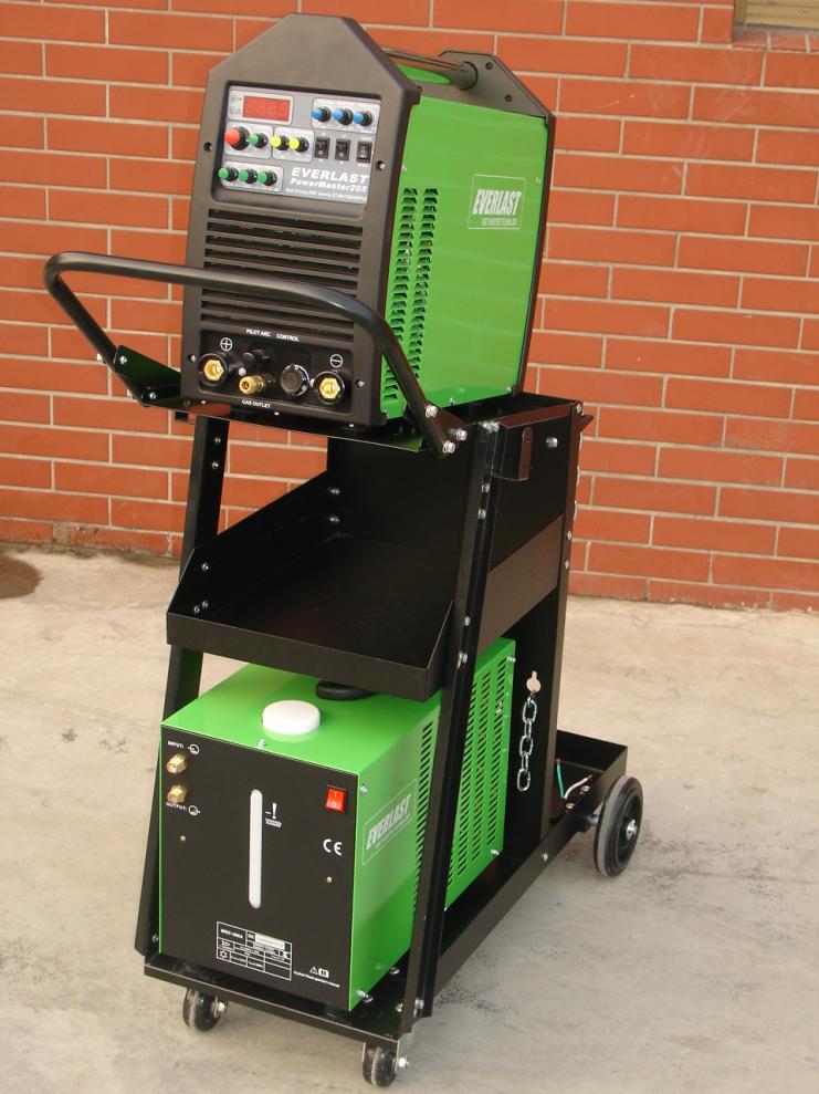

    Guys,
    We do have carts available now....They are about what it would cost you to build one, maybe a little more, but they are sturdy and heavy, and designed for the units. Check them out.

    hate to say it but i don't really like the looks of those....oh and by the way the cart in the pictures have the back plate on backwards....the tank restraint is upside down
    That's fine, not everyone's cup of tea, but it is much heavier gauge than your average cart.
    The cart is assembled correctly. As I said the cart is built well. This is the lower slot that is visible.

    I have to say I like my design over this one. You just can't have enough hangers and the top shelf is very handy during project work. The welder is captured inside the structure so it is difficult to steal during a "walk through". Perhaps a top shelf option for the offered cart would make it a better seller?
    I think a cart is always a good first project. But our new carts are nice for the guy/gal that wants to skip a step.

    I also chose to make my own cart but I do like the Everlast one. It’s nice to have the center shelf and the cooler fits well. I’m not sure of the price but I would guess based on their typical selling prices it would be a fair value.
    Wayne
    Cart's list price is 129.00. Keep in mind it is quite a heavy built cart.
    Does it disassemble for lower shipping cost or is a fully welded design?

    Wayne it comes disassembled and takes about 1/2 hour to put together. The Cart is actually a very nice unit and it is definately a step up from the usual offerings. However i still like the Cart i posted up from my Customer ( Cam has signed up on the Forum ) and in addition i alsoreally like Pivotguides Cart.

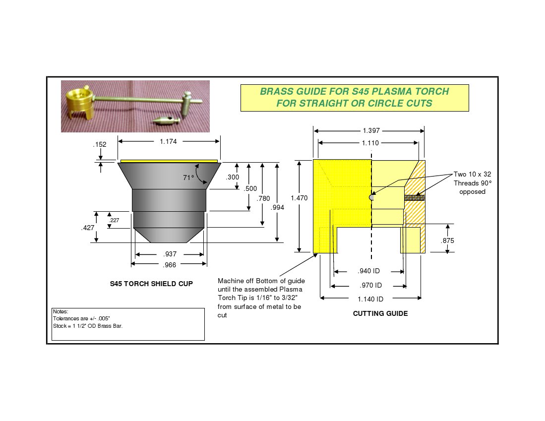

    Cam sent me a Drawing for the Circle guide Assembly he made for cutting the Circular Torch / Whip holders . He has opted to take the Wheeled Stand - Off in place of his free set of Consumables.
    Here is the Picture showing the Drawing and the result for the cuts
