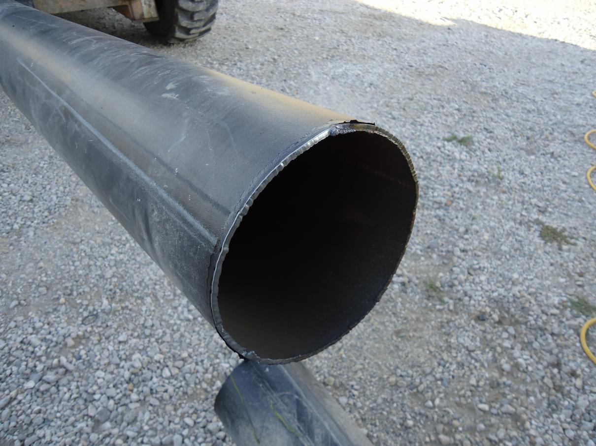

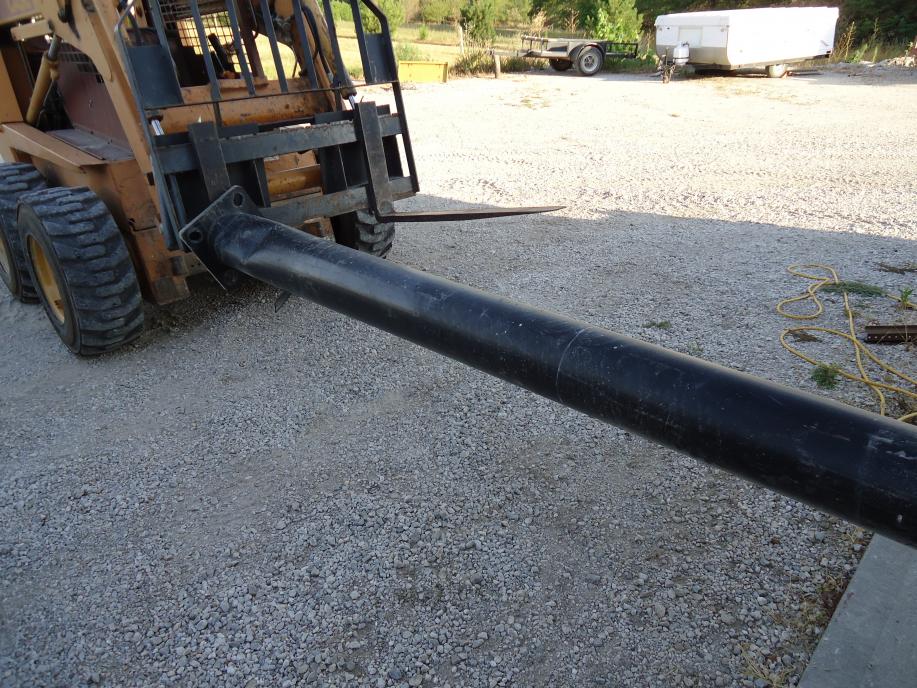

    I found a new light pole that was damage at the base for about 10 cents on the dollar at a scrap dealer i have known for a long time. The pole was mild steel 7 ga and had a fresh light cote of paint on it. Used a strap to make a straight line around to follow with the torch. Cut this one free hand and it was smooth and clean with the machine set on 32 and air at 90psi.

    Good find. Did somebody scrap the pole because the dent in photo 2? Is that enough to compromise the pole, or is there other damage?
    The dent at the base, my guess it was just installed and either a piece of equipment or vehicle hit it. $ 25.00 is a ?ell of a lot cheaper than what a piece of 7 or 8" tube would be.
    It was cut into 2 pieces and i took the bottom half that was12' long ,i only needed the top 6' , I might push out the dents and use it for something
