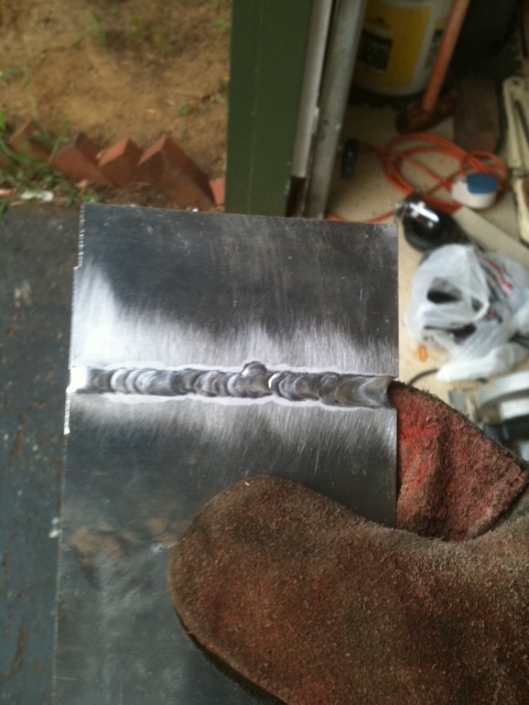

    Quote Originally Posted by Ray C View Post
    OK, the problem is solved! See the picture of the torch right were my thumb is. The injection molding on the torch was askew at the back end and the two halves were slightly off and there was a very big piece of sprue (injection molding terminology for big bugger of excess material) on the brass fitting. Depending on how the gas circulates inside the torch head, the argon was leaking out the back or, creating a venturi and sucking in air. I took an exacto knife and evened-up the mold seam and happened to have a thicker neoprene O-ring to put on the end cap.
    Impatient to give it a test, I grabbed the first piece of AL stock in sight, cranked-out the balance and laid down a few beads. It was a snap. Then I grabbed another piece and joined it. There's some crud in the weld because the surfaces were just quickly rubbed with some stainless steel wool. I had a hard time joining the two pieces because crud was coming to the surface I couldn't get both wet sides to mix. If the pieces were clean, it would have been a snap. Those are my very first TIG welds on AL... Woo-Hoo, I'm off to the races and get to play reindeer games with the big boys .
    Thanks to everyone for all the help and if I got grumpy along the line, please accept my apology. Hope you understand but, I was giving this my best shot and was getting skunked big-time.
    EDIT: Also, I was welding with a broken gas cup who's tip end was totally cracked off. Ordered new cups and will try some more when they arrive.

    Make sure the back (black) cap on the top of the torch is screwed down so you do not see the o-ring on it. You should feel it when it seats. Check the regulator for any hairline cracks as well. Maybe cut the tungsten down and try one with the short cap that came with the torch.
    Glad you got it worked out. Were you using the short cap all along or found it when switching. Anyway, post up some of you new welds.
    Found it when switching to short cap. That forced me to see something suspicious. I cleaned it up with an exacto blade and went back to the long tube/cap with a bigger O-ring. First shot, Bingo! Shiny weld pool. Was hard to manipulate it because the cone tip is busted all to heck and the arc was dancing a little due to uneven stream. Still though, day & nite difference and easy to do. Probably won't do much more until the supply of cups arrive. Will post more and possibly a video later on.

  16. Default Quick Update...
    Just a quick update here... The new cups, thoriated rods and proper TIG gloves arrived and today was the first time welding with equipment in working order. Worked-out well enough. Here's the very first weld done on both sides of a butt joint with a very slight bevel on 1/8" 6061. 65 Amps, 100Hz, 35% balance, 4T with starting and ending amps at 45 and 4 secs pre and post flow. 1/16" rod. Arc force was set at 12 noon. Did a bend test and it wouldn't break. I also did some outside corners that came out well but struggled with inside corners. Just as I was wrapping-up, I think I figured-out what was going wrong with the inside corner... I think I was holding at too much of an angle.
    Anyhow, I get the picture and need torch time but wasn't unhappy with the results. The weld looks slightly rough/etched... -maybe turn balance to 40%?
    Quick question if you don't mind, I want to verify the gas line from the flow regulator can go directly to the inlet nozzle. Tank -> Flow Regulator -> Inlet on back. I'm assuming the flow regulator connected to the bottle has a pressure reducer built into it and it's preset at a sane pressure as not to blow-out the hose and guts of the machine. Correct?
    Thanks...
    Ray

  17. #57
    Thanks...
    Ray
    No need for anything more than the regulator...which does what it says and regulates not only the flow but the pressure as well.
    Etching is more than adequate.
    About 1 second or less preflow is all that is needed.
    Arc force in TIG means nothing...it's for stick use only.
