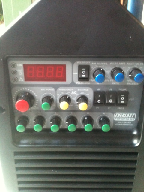

    Start at about 160 amps with the AC balance turned fully to the left. You can move up to the 1/8" electrode if you'd like. A picture of the whole front of your machine setup the way you're going to weld will help diagnose any problems with your setup.
    Pictures of everything will help... work, electrode... ect

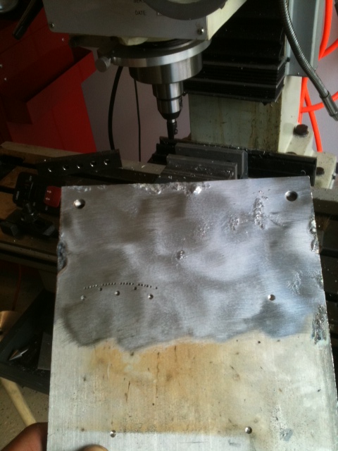

    Here are photos of the settings and typical results. And no, I'm not welding atop the mill bed but, the overhead doors are mostly closed and the fans are off (and I'm dying in here )...

    What is your AC freq and balance setting?

    Here is another photo using 1/8" ceriated. It's just buzzing away like crazy and drilling pits. I've tried a careful rotating and weaving motions with no luck. BTW: I'm not using the foot pedal. The settings are otherwise the same as the last photo.

    That is a gas problem. What kind of gas/mix are you using? edit: scratch that, you said 100%, sorry.

    What AC balance and Freq settings are you using?

    I've tried balance from none to full with increments of 10 in-between. Frequency is mostly at 150 but I've tried down to 125.

    You have a gas problem with that gray area around the weld. It could be contaminated gas, or some issue related to gas flow. If you tried to plasma cut at too high of pressure, you could have blown the lines off inside...or there POSSIBLY could be an internal leak. Too much flow will cause a similar problem as too little flow as well.

    By any chance, have you looked at the pictures of the settings and do they seem reasonable?

    OK, tried a couple things in sequence. First tried increasing the flow rate. Most of the gray/yellow soot has gone away but can't get a pool going -just a lot of erratic sounding buzzing. Buzz diddy, buzz buzz... It doesn't sound smooth like the (numerous) videos I've watched. I tried various Amperages and it went from just etching the surface to digging a hole in the piece. Next tried the foot pedal. Same results (but I do like the foot pedal better because its easy to press the torch switch w/the gloves on).

    Basic aluminum settings with foot pedal, top to bottom left to right:
    Pulse switch OFF, ignore blue knobs
    Amps 200, Arc force 1, AC freq. 100 Hz, Balance 30%, Switches AC, 2T, TIG (HF)
    Preflow 1, Postflow 10, Upslope 0, Downslope 0, Start Amps 5, End Amps 5
    Argon set to around 8-10 lpm or 16-20 cfh
    Hold tungsten about .060" off the metal and hit the pedal, for 1/8" plate, you will need about half pedal to start to form a puddle. It will take a little time about 5 seconds or so in one place, before you can begin to move.
    Some of your plates didn't look too clean. Try new material first if you can. If there is corrosion, or chemicals that have permeated the plate, forget about welding it. All the wire brushing in the world won't help.
