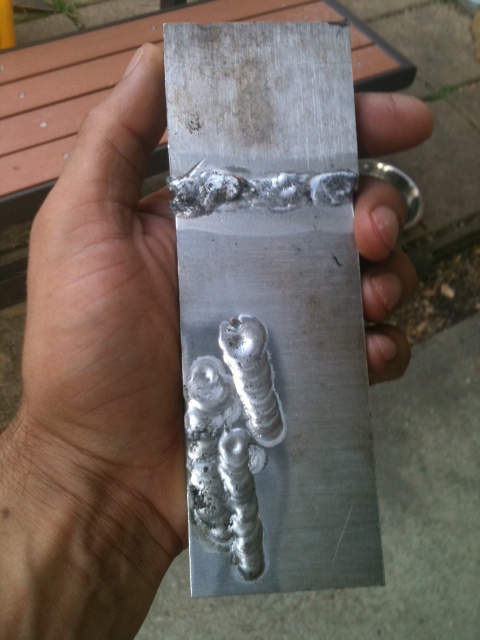

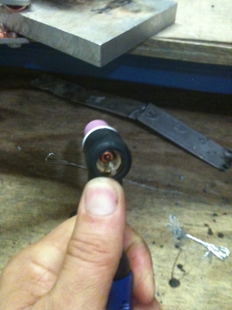

  20. Default Success! Problem Solved.
    OK, the problem is solved! See the picture of the torch right were my thumb is. The injection molding on the torch was askew at the back end and the two halves were slightly off and there was a very big piece of sprue (injection molding terminology for big bugger of excess material) on the brass fitting. Depending on how the gas circulates inside the torch head, the argon was leaking out the back or, creating a venturi and sucking in air. I took an exacto knife and evened-up the mold seam and happened to have a thicker neoprene O-ring to put on the end cap.
    Impatient to give it a test, I grabbed the first piece of AL stock in sight, cranked-out the balance and laid down a few beads. It was a snap. Then I grabbed another piece and joined it. There's some crud in the weld because the surfaces were just quickly rubbed with some stainless steel wool. I had a hard time joining the two pieces because crud was coming to the surface I couldn't get both wet sides to mix. If the pieces were clean, it would have been a snap. Those are my very first TIG welds on AL... Woo-Hoo, I'm off to the races and get to play reindeer games with the big boys .
    Thanks to everyone for all the help and if I got grumpy along the line, please accept my apology. Hope you understand but, I was giving this my best shot and was getting skunked big-time.
    EDIT: Also, I was welding with a broken gas cup who's tip end was totally cracked off. Ordered new cups and will try some more when they arrive.
