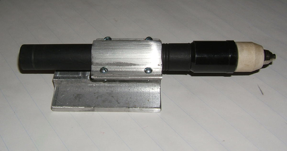

    I'm putting together a CNC plasma cutter.
    How do I wire up a P80 with HF start to a plasma table ?
    I bought a machine torch for it.
    What is the torch connector on the P80 called and where do I get one ?
    How do I "isolate" the CNC machine electronics from the HF start of the torch ?
    Thanks

    If this the the P80 torch you have it is very simple. It has a pilot arc connection and a gas connection (plasma power) on the torch you may need to get a converter to connect you plasma unit to the gas (power) connector. I am using my PM256 plasma output on my table and I needed to get an adapter between the two. And for the plasma on/off you connect it to the CNC controller output for switching plasma on/off but use a ferrite core around the cable at the controller end. http://www.parts-express.com/pe/show...ource=googleps
    On my PM256 it is the same connector on the front for tig trigger and plasma trigger. If you have a CNC output on your plasma cutter it normally is pins 1 & 2 on the connector.
    http://www.youtube.com/watch?v=OJfW0r8pbz4
    You should also ground the plasma unit, controller, and table to a earth ground (8' rod into the ground near the setup) all my motor and other connecting cables have ferrite cores and outer shielding tied to the controller ground.
    Havwe fun
    Tom
