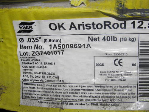

    I bought a roll from the ebay guy... says 40 lb 18kg on the box. The lws said the same, 40 lb. Click image for larger version.
    It's a high price but I gotta see for myself how it does.

    I hope that wire isn't rusty. The box is suspect.
    The wire I use is copper coated... Or it looks that way... I was told it was to keep it from rusting. I know raw steel will rust in seconds in a humid environment. I live in a humid area and never had a problem with rusty wire.
    Isn't all MIG wire coated like that???

    The cheap stuff usually is. Copper is used as a substitute deoxidizer, but it also can add impurity to the weld. Plus you end up with the problem of the copper flaking and packing your gun liner and can cause drive roll issues long term.
    Edit: Lookie what I just found:
    Things that make you go hmmm. That OK 12.50 sounds better by the moment, doesn't it? You won't find a cheap copper wire that isn't coated, or at least I haven't seen it. The national standard wire that I talked about isn't coated either.
    http://www.esabna.com/ca/en/Products/OK-Autrod-1250.cfm

    I notice that stuff it blue... I don't see where it says if it is coated... Maybe not??? Looks like a lot better wire. But for the long term between uses is there is a rust or corrosion problem sounds like not for me. Sometimes I can go for several rolls a year and other times a roll can last several years. With the humidity here I can see surface rust forming on tools if I leave the garage door open on a damp day.

    Brian, it is not coated with copper, but that does not mean it will rust any faster than copper coated wire. I've had copper wire rust on me faster than this stuff. Copper wire will rust. As far as not using it, and the wire rusting, IF a wire does oxidize, it is usually only the top layer of wire, and once that is removed, the wire beneath is just fine, if it is on a closed spool. I live in S. GA, 2 hours from the gulf, and 2 hours from the Atlantic. It doesn't get much more humid, with summer averages around 80-90% humidity.

    Mark... Thanks for the info... Learning all the time. Will have to cut off a few pieces of wire and see how they hold up to rusting. Looks like the Esab wire is protected/sealed somehow.
