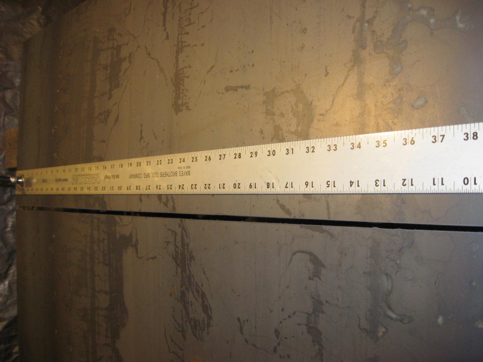

    I'd just like to add that the purpose of the air test switch is to set your running (cutting) air pressure. The gauge will read higher than cutting pressure when the machine is not in use.
    For the unmentioned post flow setting, I like about 10 seconds... more if the cuts are long. This increases the life of your consumables. Also the standoff should stay in contact with your work and against the straight edge if using one.
    When done correctly the cut will be clean and straight with very little dross (recast). This pic is a normal result cutting 11ga (1/8") steel against a straight edge with an Everlast PP60 Best tool I ever bought. Name:  thumb.gif

    I run about 10sec of post air as well. Cools consumables to help them last.
    Dry air and enough CFM most important, right amps and stand-off are important too.
