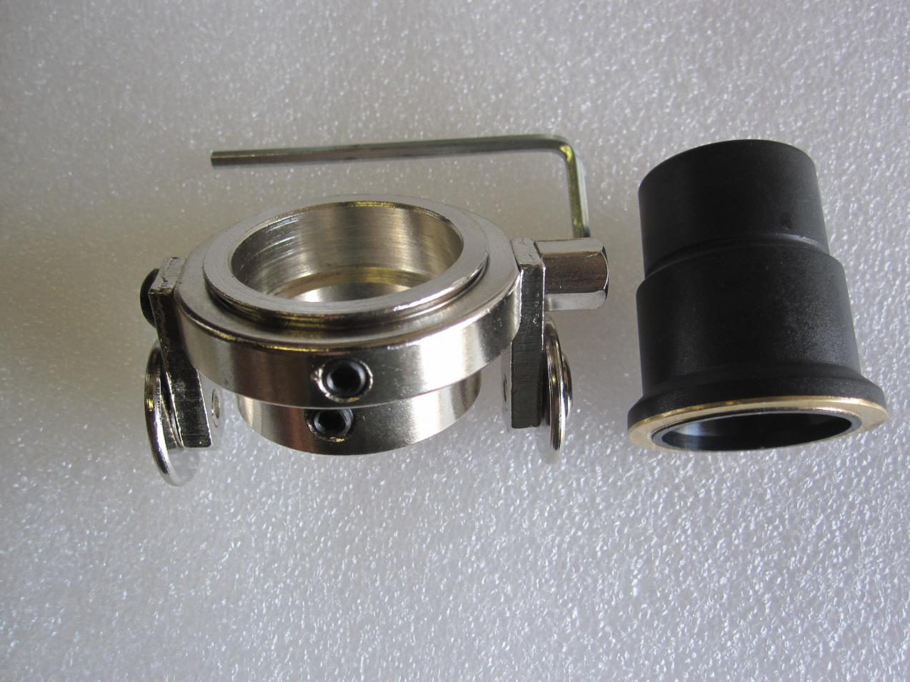

    You could also make your own circle cutter with some shaft collars. Get one collar that will fit your plasma torch. Weld a piece of 3/8" round bar to the collar that fits the plasma torch. Get a 3/8" collar and weld a 1/8" piece of round stock to it so it will be your center point. The 3/8" collar will slide up and down the 3/8" round stock making it adjustable. It would probably cost you $10.00 to make, and you would have an adjustable hole cutter.
    Swagg Offroad has one that's not to pricey.
    You could also get something like this and add a threaded rod with a sliding anchor point to it. I find this makes any tupe of circular motion a breeze as you can loosen the outer ring and this allows turning much easier compared to a stationary stand-off

    All great ideas!
    I bought a 3" coupling to try it but it was going to be too small so I ended up just free handing it.
    Works for what I'm doing right now but I like the adjustable collar idea that Seanmurphy265 had!
    Thanks everyone, you soon will see my Amazing free hand abilities!!! lol
