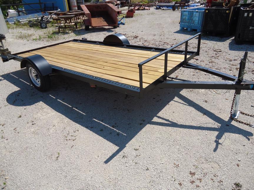

Here is a 6 x 12 trailer that i rebuilt in late April early May, The old trailer had a busted axle bad floor and no lights ,Hitch and jack were bent .Someone welded the jack mounting bracket on with Nickle rod. If you ever worked with nickle you know how fun it is too get it off of something.Took the old trailer and added new Crossmembers, New 2000 pound axle ,springs hubs tires wheels ect.New fenders a new headache rack, added a structural steel channel to the side rail along with the original 3 x 3 1/4" angle.On the inside edge of the rail i added a piece of E track 1" up off the floor to use as light duty tie downs. Should work great for hauling 3 ATV'S or a single UTV.Click image for larger version.
