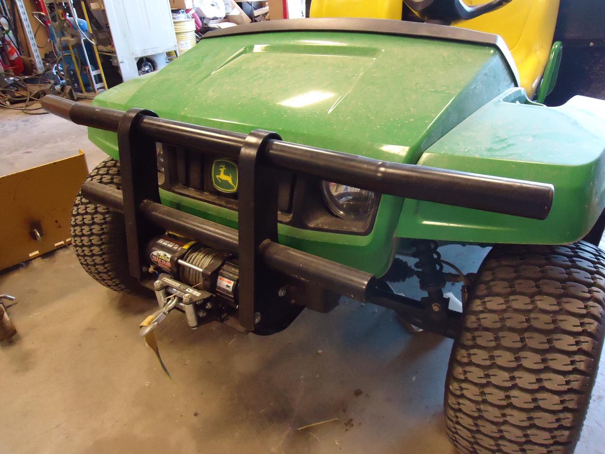

Here is a pic of the custom front bumper brush guard i built for my wifes John Deere Gator TX,Used some 2" exhaust for the tubes, some 10 gauge and 7 ga sheet for the flat steel. Had part of a new polaris winch mount that worked for the winch base.(I use what you can find laying around whenever i can.) All the flat steel was cut from sheet with a plasma, any rolled or bent steel was done old school hot on an Anvil.Had my son in law put the bends on the top tube at work.Click image for larger version.
