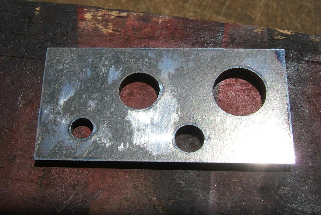

    That is a very ragged cut I asked before what size tip are you using. I use a 1.0mm (about a .040") Also you may be too high still the top of the metal shoudlbe much cleaner then that in the picture. IMO
    my cut height is about .060 ” Pierce height of about .080” to .090” i'm no expert but that works for me.

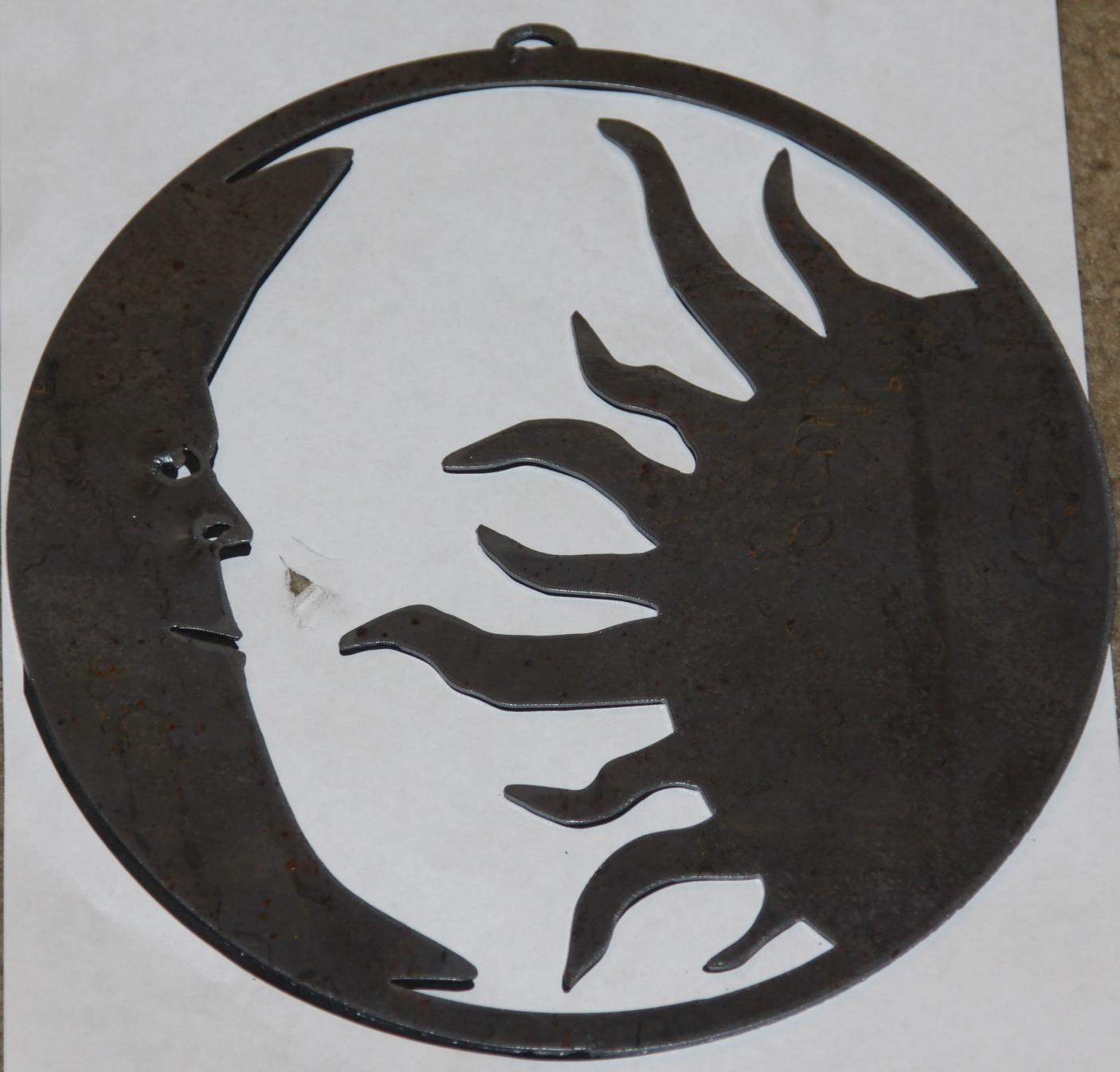

    I've spent a while working on the THC and its finally at the point of letting me cut something real.
    I did my first cut of any complexity. I was hoping for:
Name:	Small Sun and Moon..jpg
    What I got was this:
    It looks like everything but the top of the circle was okay.
    Any suggestions on what to look at?

  7. #107

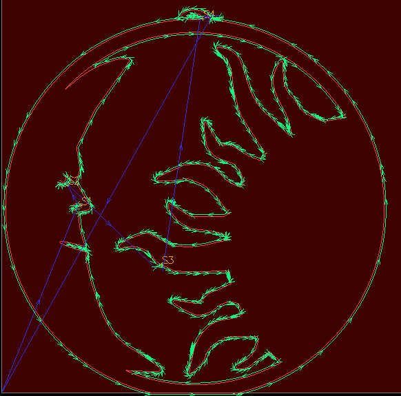

    Did anything move between the inside and outside cuts? That's the first thing that comes to mind. You can run the G-code through a backplot simulator to see if there is something wrong in the code. Any calibration errors in the machine axis would have affected the ID and OD the same, so it might not come out round, but it would not be what you are seeing.
    Did you check to make sure you haven't lost any steps?

    It looks to me like something is up with the travel to step ratios. I'd try cutting a series of concentric circles with a consistent increment in diameter increase. Then see if each circle is in fact round and be sure the thickness remaining is consistent and accurate.
    Did the plot in sheetcam or whatever you are using look ok?

    One of the things I see is some of the finer (sharp cuts) are not as the image looks that could be the kerf width you have set in the cam program. But that does not explain the top inside cut. What are you using to convert the image (.jpg) to G-code. I use a program called CR8trace (free) it converts .bmp to .svg then sheetcam to g-code. Very simple to run just load a bmp you see nothing on the screen then you just save as .svg and its done. I copied your image and did the convert and simulated a cut and the mouth and top of the moon pointed areas were not sharp as yours are too. But the top of the circle was thin as the image was.

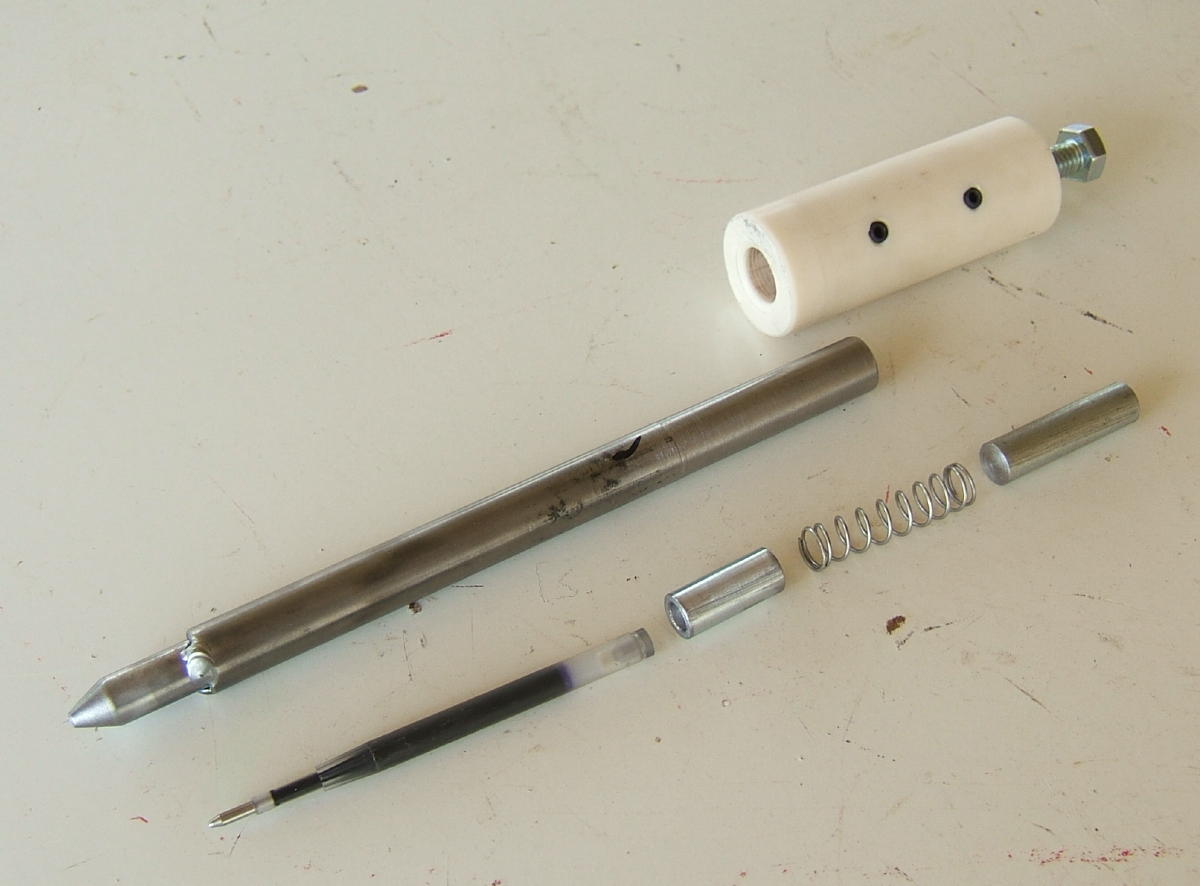

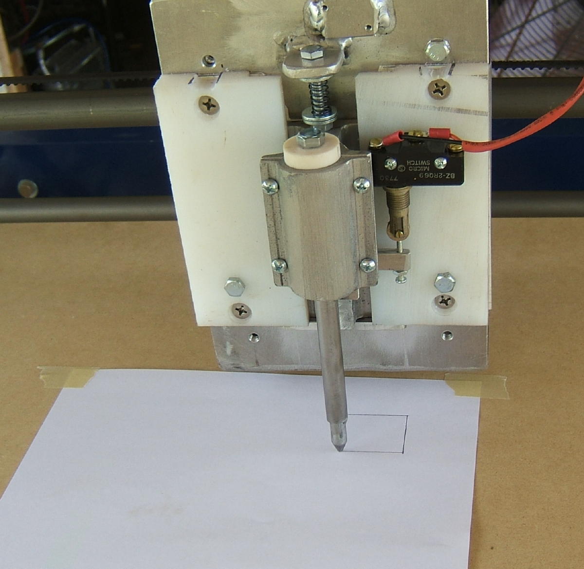

    You may want to make a pen adapter for the torch holder so you can draw out a g-code cut path here what I made to do that saves metal.

    I haven't had a chance to try again yet. I was trying to figure out how to spring load a pen. I'll have to see if I can piece something together likes your setup Jester.
    I drew the original image in Corel and exported to DXF. It looked fine in sheetcam and in the Mach window, but I wasn't paying close attention.

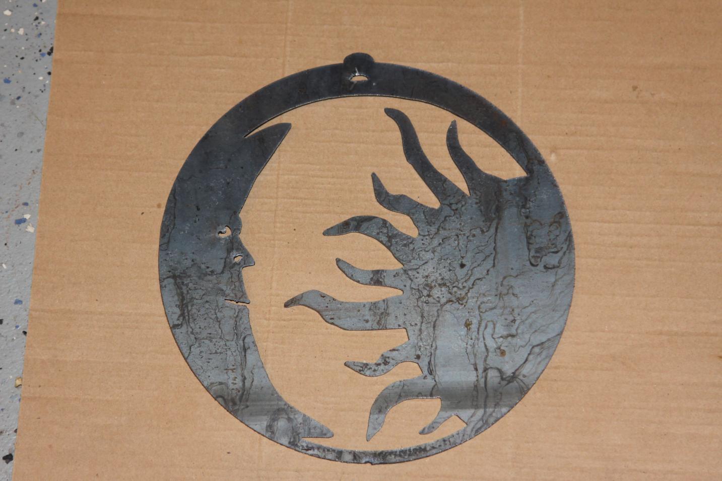

    Default Attempt 2
    Taking all the advice, I checked all the motor settings. It turns out that the Y axis had a different acceleration that the X/A. I didn't think that would make a difference, but I set the Y to match the X/A anyway. They are all set the same except the max speed on the Z is much lower.
    I then taped a 1:1 image down and manually positioned the torchhead at multiple points on it. That all seemed to line up properly.
    I tried to cut again, and I remembered to turn the THC on in Mach before I started. I also up'ed the cutting voltage by about 3/4 volt. This is what I got:
    It's a perfect match to the pattern. My best guess is that the torch did move the metal because it was too low before the THC was turned on. I guess that was a lesson in the value of the THC.
