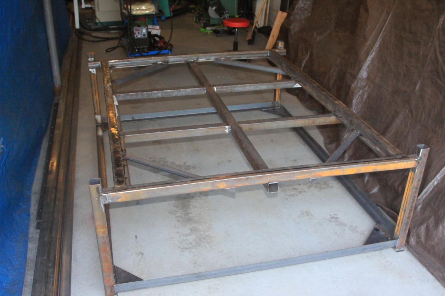

    I now have the table put together and right side up. I still have to weld what was on the under side.
    This is only my second big welding project, my welding skill is progressing but I really have a problem with consistency.

    I'm planning on putting 2" angle around the cutting area so that I can get up to 4" depth for the water table. I have 3" flat stock I'll use for the supports and just put it in notches I'll cut in the angle.
    I'm planning on puttiing heavy duty casters on with a leveling foot with each one. That way I can move the table around without help and still be able to get it stationary and level. I kept it low to the ground so I wouldn't have to lift metal as high to get it on the table.
    I'm not sure if I'll need to add support in the middle. The inner dimensions of the table are 52" x 76". I expect to lose a couple inches due to carriage dimentions. I assuming I'll have about 50" by 70".

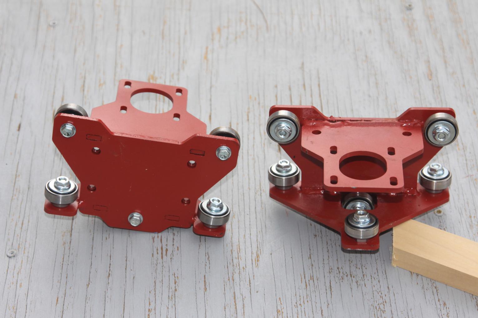

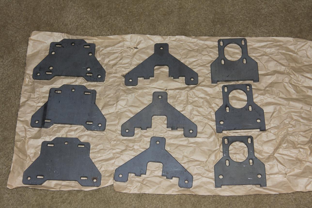

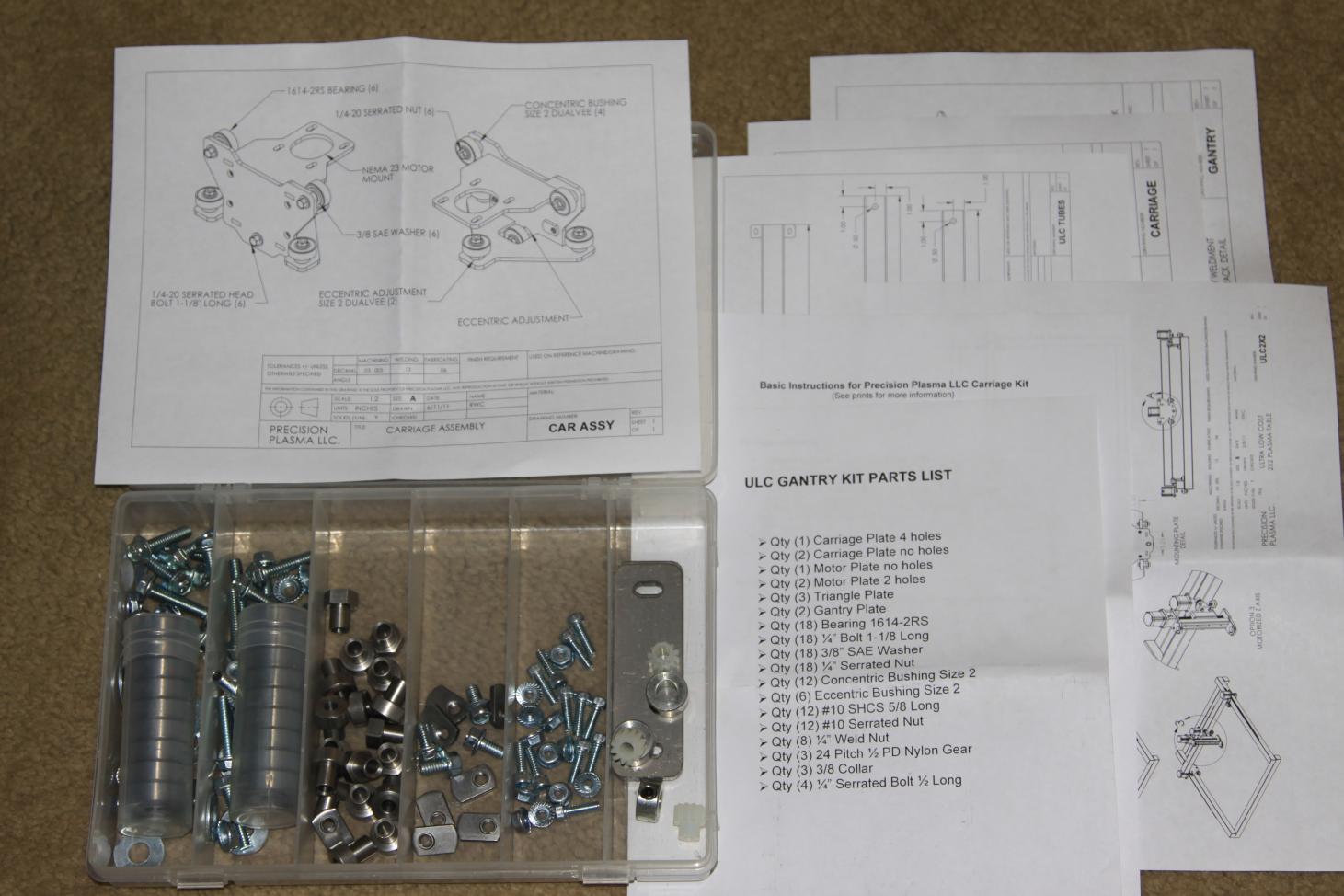

    Default Carriage Kit
    I got my carriage kit from Precision Plasma ($325). I originally saw it on EBay, but then went to his web site to find out more.
    I liked the iPlasma tables he had, but buying a pre-built table wasn't in the budget.
    The kit contained the carriage plates and all the bearing and hardware necessary, as well as plans for a portable cutter (just carriage rails, no table).

    Two of the completed carriages are below, one X and one Y.

    Based on the plans that came with the carriage kit, and a discussion with Ron at Precision Plasma, I went with 14 ga 2" square tube for the table and 16 ga 2" stainless for the gantry.

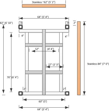

    Default Table Design
    Here's the layout for my table. I based this on other tables I had seen and trying to maximize size for materials. I also wanted to not overbuild it so that I could still move it around and handle it while building. (Since this is my first major steel project, I figured the table may be replaced quickly as I learn more. The stainless rails and carriages are the bigger investment and can be reused, if necessary.)
    I only have the table about 2' high on purpose. I knew I'd have to lift any steel I want to cut from floor height, so I wanted to minimize the lift distance.

    Based on recommendations from Ron at Precision Plasma (where I got my carriages) - I'm using 14 ga 2"x2" steel tube for the table and 16 ga 2"x2" stainless tube for the gantry.
    The table used:
    (2) 2"x2"x24' hot rool
    (1) 2"x2"x20' stainless
    (1) 2"x2"x1/8" angle (used for the bottom braces between the legs)
    (1) 2"x1/8"x20' flat bar
    (1) 1 1/2" x 1 1/2" x 1/8" angle
    (1) 5' x 8' x 14 ga sheet
    (3) 3" x 1/8" flat bar (for support slats)
    The flat bar iswelded to the under side of the 2" sq table with 1" protuding toward the center. This gives me a good surface to weld a 14ga steel sheet to for the bottom of the water table.
    Table Cutting List - (2) 14 ga 2"x2" square tube
    Feet - Inches
    6 - 4 table side
    6 - 4 table side
    6 - 10 center support
    2 - 3 mid table support
    2 - 0 leg
    Total 23 - 9
    5 - 4 long end
    5 - 0 short end
    2 - 0 leg
    2 - 0 leg
    2 - 0 leg
    Total 23 - 1
    Leg brace cutting list - (1) 2" x 2" x 1/8 angle
    Feet - Inches
    6 - 6 table length brace
    5 - 0 table width brace
    Total 23 - 0
    I also reinforced the corners of the cutting table with 28 1/2" pieces at a 45 degree angle underneath the table on each corner. I used 1 1/2" angle for that.
    Corner Brace cutting list - (1) 1 1/2" x 1 1/2" x 1/8 angle
    Feet - Inches
    2 - 4 corner brace on the bottom of the cutting table
    Total 9 - 4
    I have basic construction done and have already "learned a lot" (code for "messed it up"). I post some pictures later.

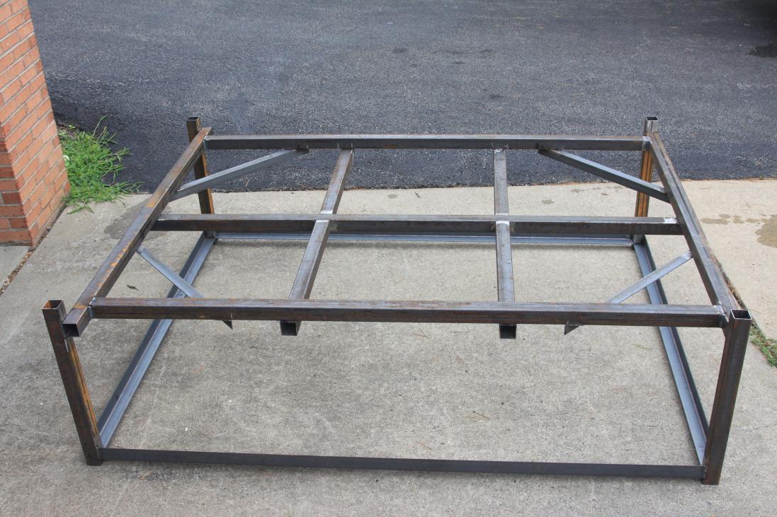

    Default Current Table State
    Here's the table as its current state in the garage.

    I've been going back and forth on how much support is enough for the water table. After talking to my brother in law (long time fitter) and my daughter (materials science engineer doing her post junior year internship in a metalurgy failure analysis lab) - they both think I'll have sufficient support.
    The urge is to to support the table bottom more, but with water 3" deep there will be about 400 pounds of water. That's less than 1 pound per square inch. My reasoning (right or wrong) is that the table to leg weld it more of a concern for stress failures than the sheet that is the table bottom.
    I'm willing to take a chance. That's the fun part - it's never interesting without the chance of a dramatic failure!

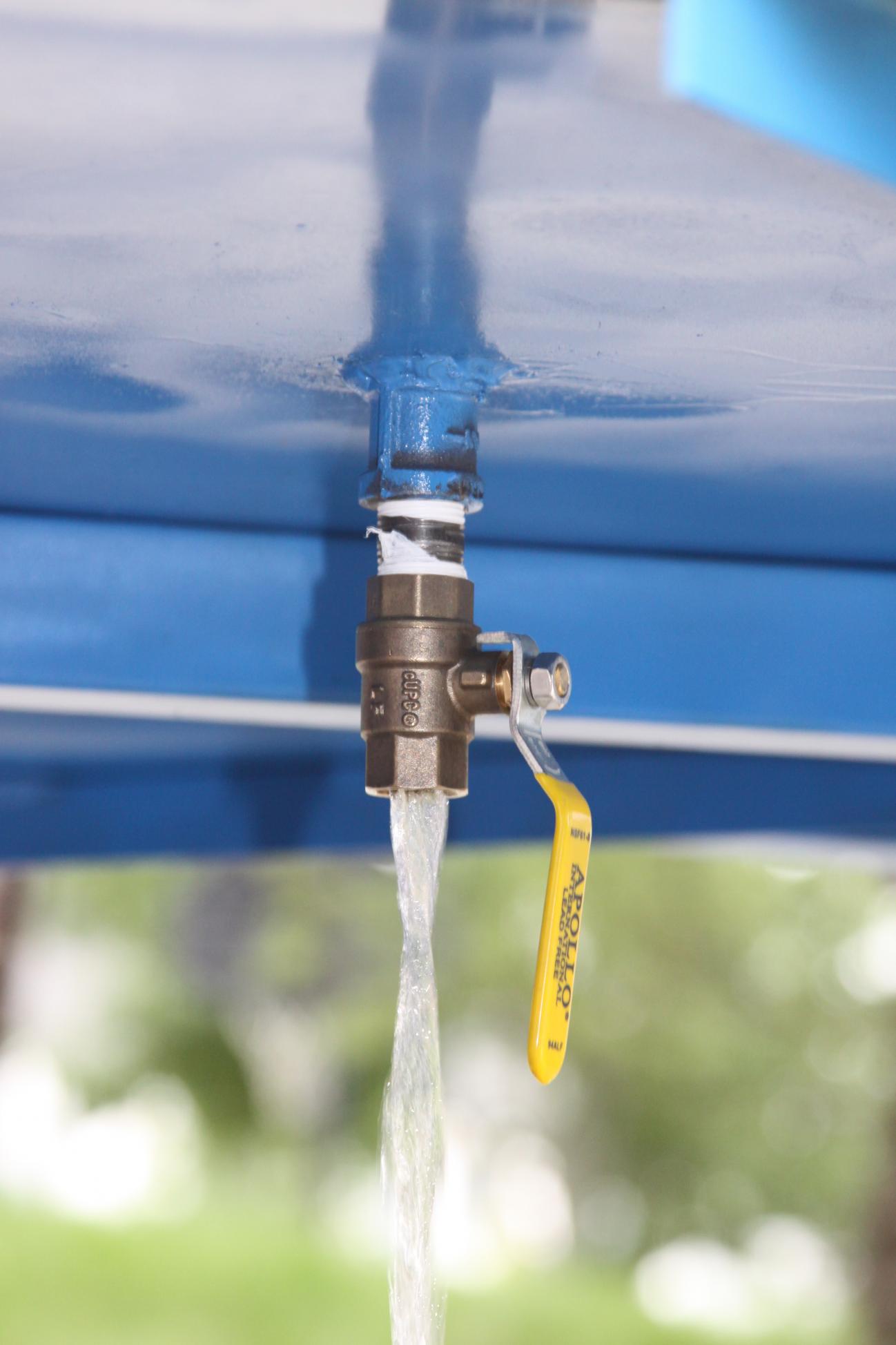

    For the drain I just used a 1/2" black pipe coupling on the bottom of the water pan and threaded a ball valve on it.
    May as well put a garden hose adapter on it http://www.amazon.com/Anderson-Metal...094267-8385652 (link is only for illustration)
    You could fill it the same way... slowly with no fountain.
    I would add some support in the middle, but if you not cutting over 1/4" it will probably work fine.
    I probably won't be doing anything heavy. (I just wouldnt' be able to lift it.) I'm planning on more decorative/artsy stuff.
