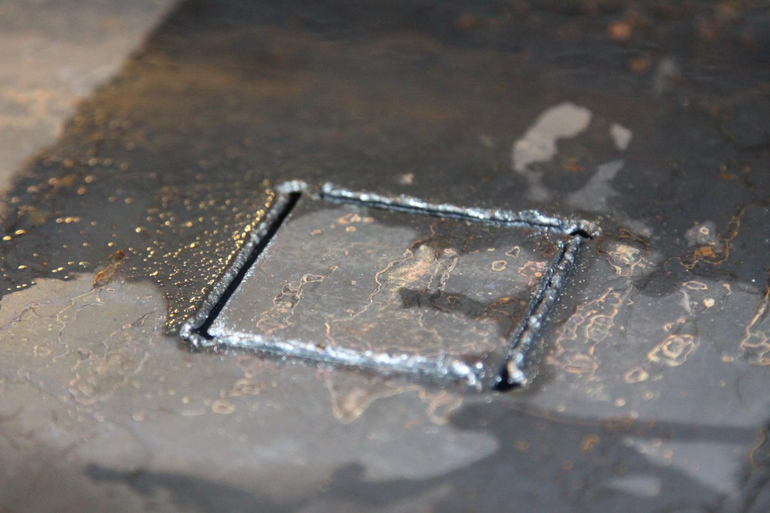

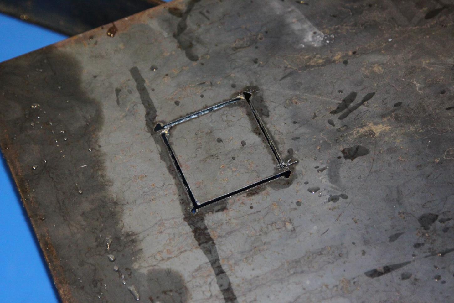

    Default First 99.1% Successful
    Did the first cut. After all the dry runs, it worked out pretty good.
    I cut a square but had a problem that the arc went off at the corners. I have to try to figure out why that happened. I'm not sure if it's a configuration issue for Mach or Sheetcam (I had "loop corners" set to triangle - my primary suspect) or if a noise issue with my Arduino THC that controls the torch on and arc good.
    Top of cut:
    Bottom of cut:
    I'm sure it will take a while to figure out optimum settings.
    Just starting in Aug '10
    Hobart Handler 187
  7. #87
    Did you fix SheetCAM so the corners are not still at 200 ipm?
  8. #88
    Beats me.
    I thought I was cutting at 10 ipm, which seemed slow.
    I'm not sure where the speed is in the G-code:

    N0030 G20 (Units: Inches)
    N0040 G53 G90 G40
    N0050 F1
    N0060 (Part: SquareStar)
    N0070 (Process: Set variable switchoffset = 0.2)
    N0080 (Process: Outside Offset, Layer 2, T1: Plasma - outside profile)
    N0090 M06 T1 F10 (Plasma - outside profile)

    N0210 G02 X2.2058 Y-0.0295 I0.0000 J0.1024 F10.0
    The feedrate is the "F10"
    Try changing the 10 to a 20 or 30 and rerun the program exactly the same otherwise and you will see the difference.

    You mention "triangles" for the corners. If you look at the plan view, you can see the triangles formed at the corners. Basically the toolpath runs past the edge by say 3/16", then turns and moves across the hypotenuse of the triangle, then proceeds to cut the next side. I doubt this has anything to due with the arc going out.
  11. #91

    Looks like the Z move from pierce to cut height is at 20 then everything else is at 10. F stands for Feedrate and stays active until a change. It can be appended to a motion command but takes effect before that move. I bet 10 is kinda slow for that cut.

    Thanks for the feedback guys.
    I found a reference so I could start learning G-code. It looks like the G-code never turned off the torch, so I'm guessing it was due to the noise on the interface from the motors when they cut the corners and doubled speed and made quick direction changes.
    I didn't put a ferrite on the BOB -> THC cable yet. That's probably the first step. If that doesn't do it, I guess I can delay the torch off in software (probably start with 250 ms and take it up from there). I'd prefer to address the noise, but I think I could end up cutting/wasting a lot of steel getting scope captures to figure out what's going on.
    I think that the cut rate was way too slow. I had been trying to find a good chart to give me a starting point for cutting speeds and amperage settings based on thickness. I finally found a decent starting point on Eagle Plasma's web page:
    http://eagleplasma.com/4x4system.html
    It recommends 240 ipm @ 30 amps for 16 ga. I cut the 18 ga at 10 ipm @ 35 amps.

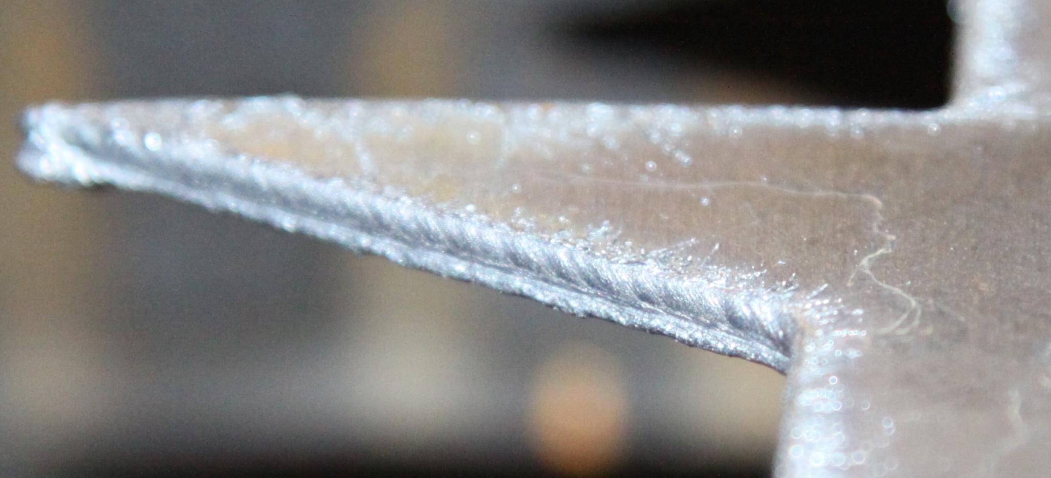

    Default Cut Profile
    I tried my first cut of a shape other than a circle. I made a name plate for my wife that I could mount in a wood base.
    Everything worked great, but the cut wasn't very clean. I'm guessing that I had the torch too high. Any thoughts would be appreciated.
