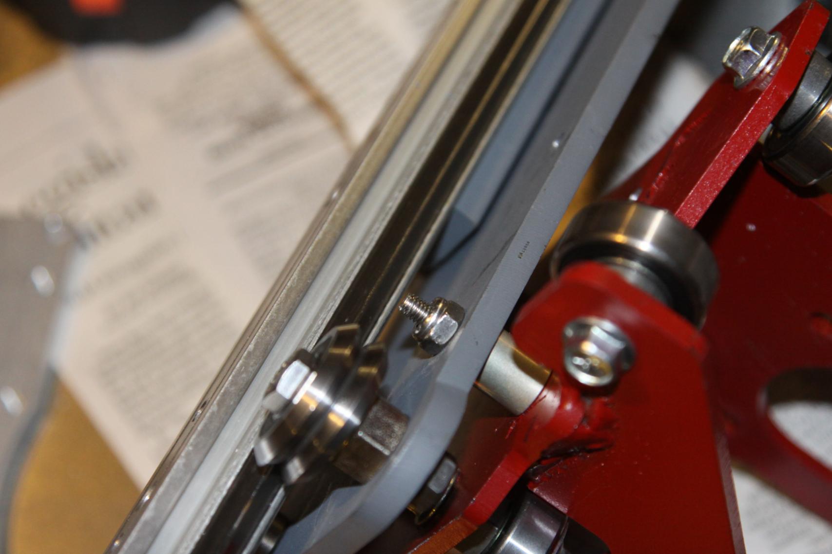

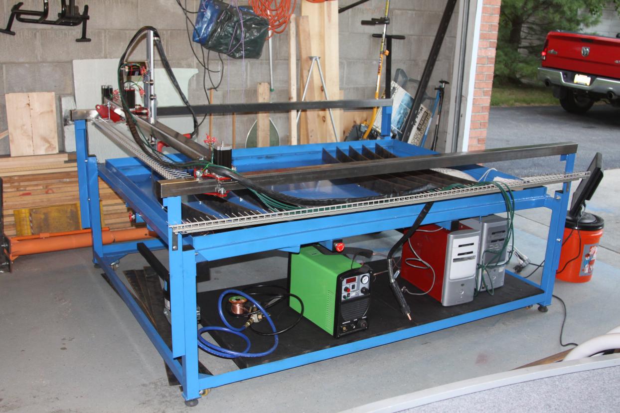

    I did start leveling the slats. Once I got enough to do support a test cut I mounted the floating head plate to my z-axis. I had to modify the mounting since I have a Precision Plasma carriage and a Shopdroids Z-axis. The mod I did put bolts in the way of the floating head. It reduced my z-axis travel from 6 inches to 2 inches.
    John from Shopdroids was helpful with some ideas. I ended up making an adapter plate out of aluminum. Not pretty, but effective and it got the job done (I want to cut and I'm frustrated at falling behind where I want to be).

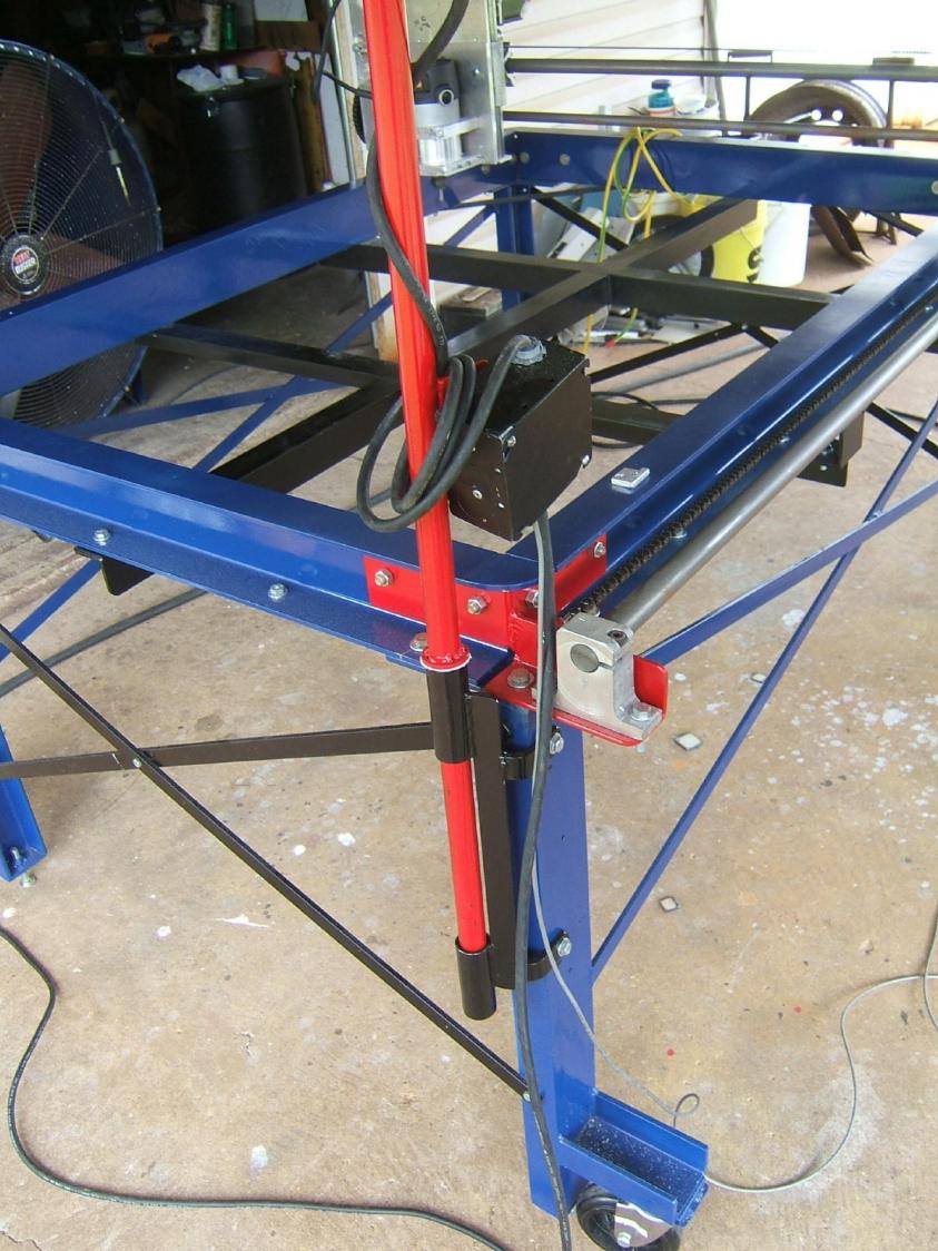

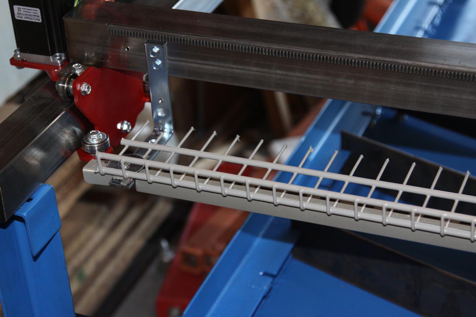

    I got my energy cable today. I ordered (3) three meter sections. They were only $19/each on ebay. I looked at getting a wire mesh cable tray (used for hanging network cables in the ceiling). They were $100 for a ten foot section locally. Mail order they were only $20 each, but truck freight was $220. So, that was a non-starter.
    I ended up getting a wire shelf at Home Depot for $20. I shortened it and made it narrow. I do need to give it a little more support, but I'm not sure the best way. I think that aluminium angle will work, but I don't know how much that would be.
    I had thought of using conduit, but that probably has too much flex. Any ideas are welcome.

  2. #62

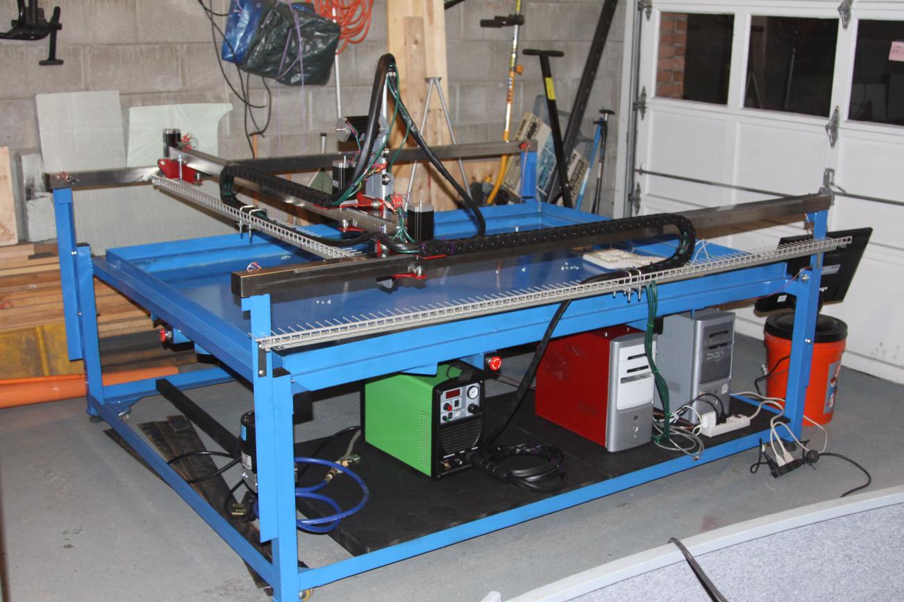

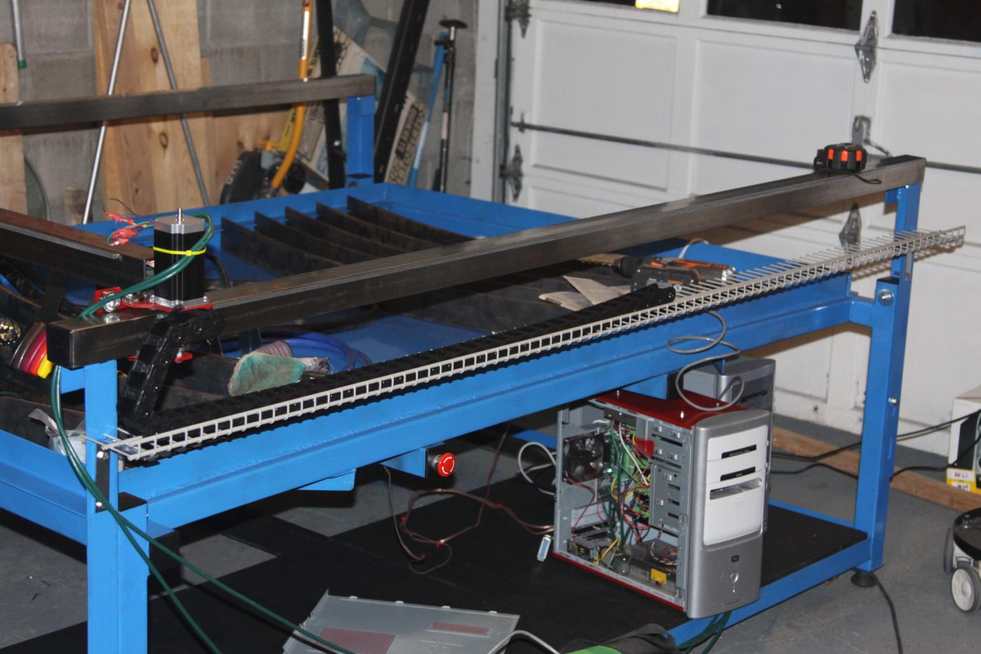

    Default Mostly done with the build
    I thought about a couple different ways to support the wire shelf for the energy cable. I ended up getting a U shaped wall bracket for holding shelf supports.

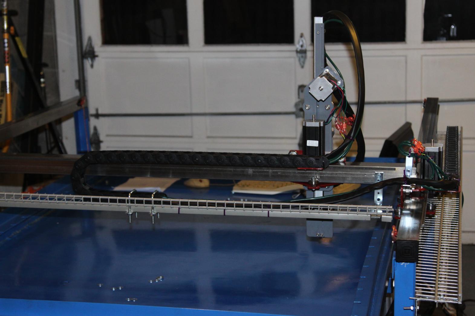

    I didn't install the engery chain because I don't think the torch is long enough to make it. Hopefully, I'll have a longer torch in a couple weeks.
ID:	7964 Click image for larger version.

    I ran my plasma cable using a rotating pole in the corner of my table. It ended up with a shorter run, no worry of interference with the motor cables. My motor cables are run like yours. One picture shows my table corner with the rotating pole base.
    Like this one shown here other picture.

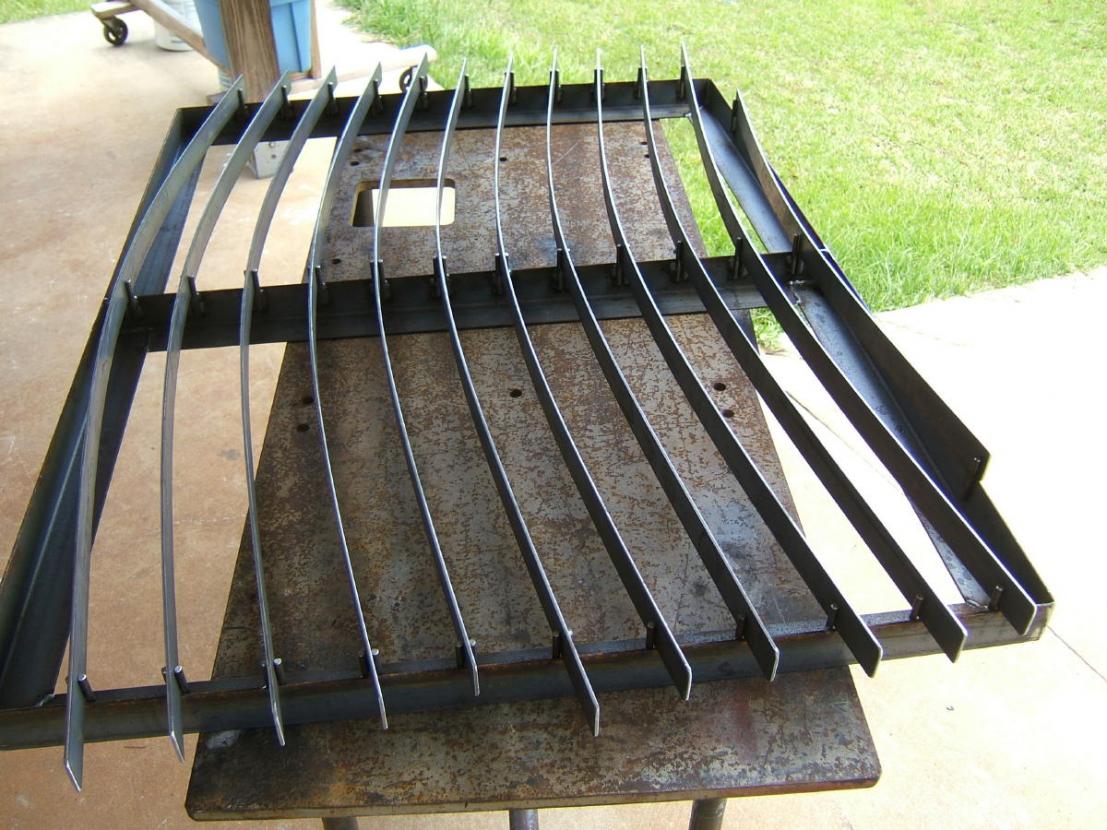

    HI

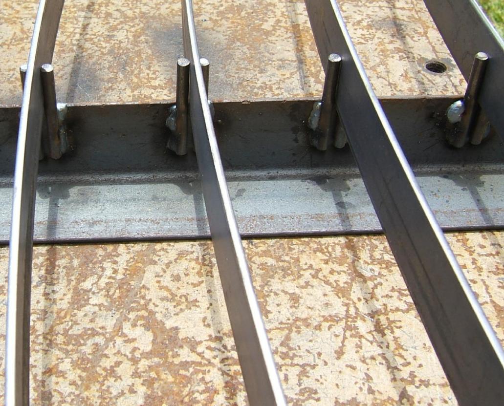

    I used a different arrangement for my slats in that I used a 2” angle base and 1-1/2” slat. His way I save a little when replacing the slats. I can also remove the whole slat fixture for cleaning. Different strokes type thing.
Name:	cutting grill.jpg
ID:	7970   Click image for larger version.
Name:	cutting grill (5).jpg
    That's actually much closer to what I had hoped for. Unfortunately, welding the length of the tube frame caused the bottom of the water table to warp badly. Ideally, I would like to put steel down on the sides and middle lengthwise to provide a level surface for the 1 1/2 high slats (similar to what you have). I just haven't figured out the best way to cut the lengthwise supports to meet the curve of the table.
    For now, I'm just using washers to level the 3" tall slats so I can do some test cuts when I have the torch interface (relay, etc) working.

    How about building an intermediate slat frams lime acourtjester did, but use 1.25" angls and 1.5" slats. Then you can level/shim the 1.25" angle as needed floating it over top of your warped frame, then slip the slats in. Slats woudl be cheap since they would only be 1.5" wide and you could have a flat table. Maybe you could even just bolt the intermediate angles in to eliminate any distortion and allow whatever shimming you needed.
    Maybe put multiple angles across rather than the single angle in the middle.

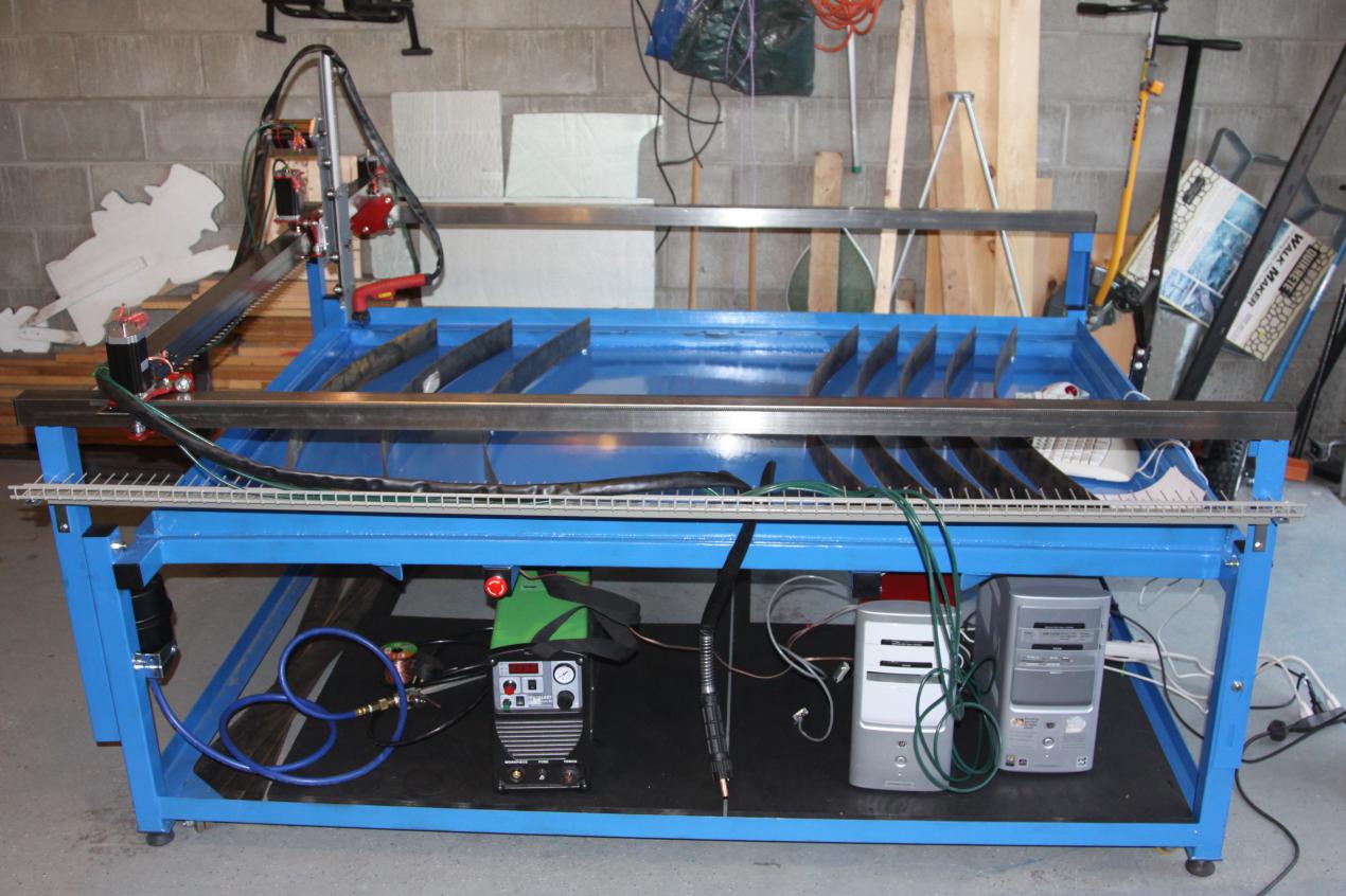

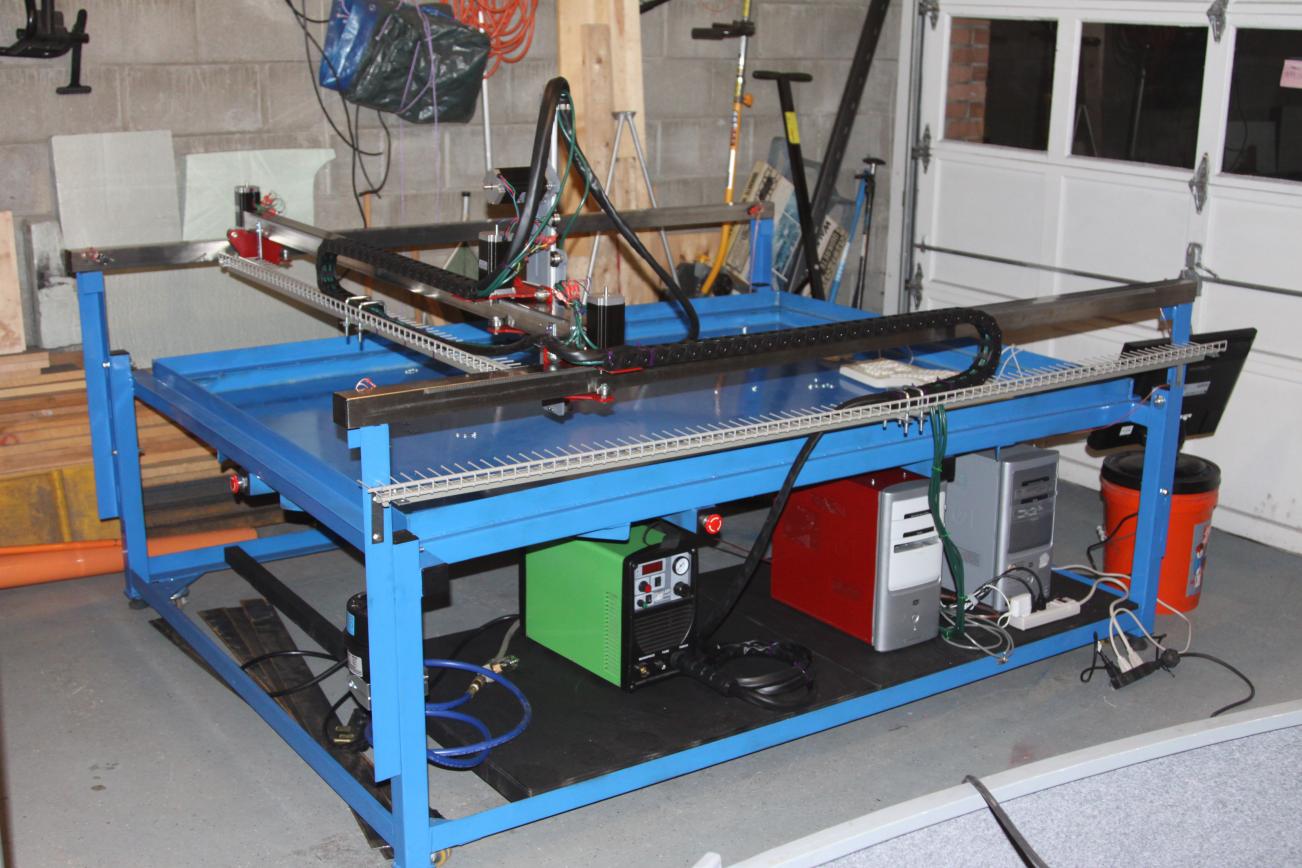

    Default Build Complete

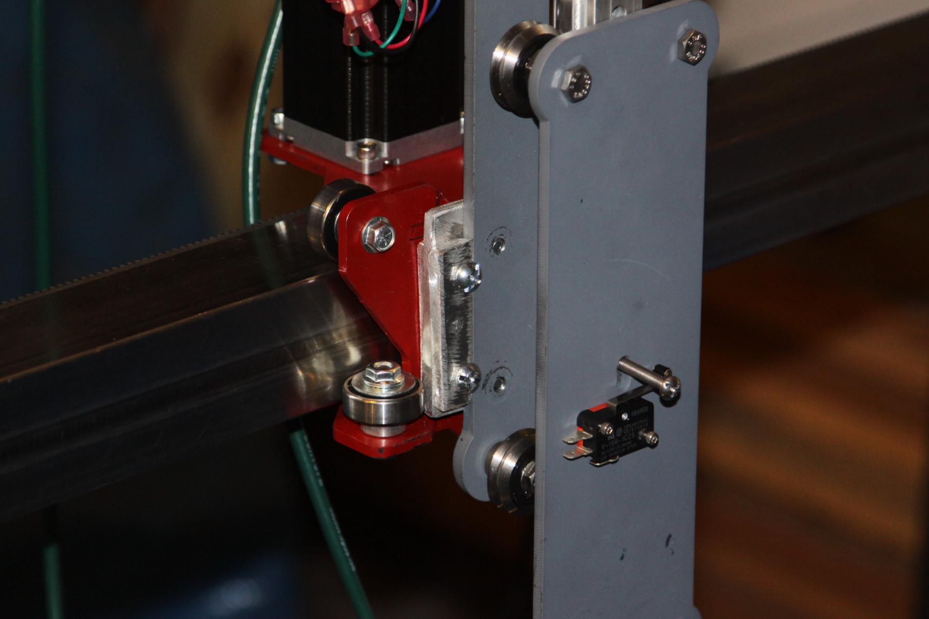

    I just completed doing all the wiring in the cable trays/energy chains and all the limit switches.
    The stock torch wasn't long enough and I had wanted a longer torch since I got the unit. I ordered a 25' one on e-bay from "3Shop River" last Saturday and it got here yesterday. So I was able to finish my cabling.
    The fit in the energy chain was tight, so I ended up cutting off the plastic sleeve on the torch for the portions that ran inside the chain. That made everything fit comfortably. Everything seems to work fine.
    I need to do some more configuration on Mach. It sees the limit switches and stops, but you can't shift off the limit switch. I recall there was a setting somewhere for that, just haven't looked yet.
    I had leveled some slats with washers, but then took them out to seal all the seams. I'll use the washers to level them until I get the table going and figure out a better solution.
    All I have to do if finish wiring the torch on/arc good lines in my Arduino interface so that I can try cutting.

    As much as I want to work on it tomorrow, I'll probably spend most of the day trying to get the hovercraft running again. I'd like to get it going well enough for at least one high speed run before it gets put away for the winter.

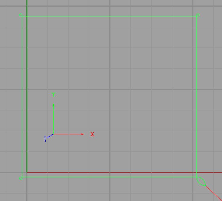

    I'm using the demo version of SheetCam TNG and the licensed version of Mach3.
    I've used Corel Draw to draw a square and save it as a DFX. I import that into Sheetcam and use an "outside" tool to cut it. I post process with the MP-1000 THC post processor.
    When I load it into Mach and regen the tool path, it shows the square I drew with a circle about 4 times it size.
    I'm not sure why I'm getting the extra circle.

    The code looks ok to me and here is a backplot of what it does.
    The only arcs are the small circles at each corner to make sharp corners. The feedrate seems a little excessive for them at 200 ipm, so unless your machine can move at those speeds, you may want to go into SheetCAM and do some more machine setup. Make sure Mach is setup to rapid at a rate your motors can handle, too. The Z is set to go to 2.5" above zero, but there is a canned cycle for the THC G28.1 that I don't know anything about. It takes control over the Z axis and uses a coordinate setpoint that probably resets zero to the surface of the material at the start. Your pierce time seems to be .3 milliseconds so that points to another setup issue, unless that mystery G28.1 takes care of that, too.
    In SheetCAM there is a Mach3 post that will generate code without the THC stuff.
    The main feedrate is 60 ipm so that is probably ok, but parts are being done at 200 ipm which might be too fast and cause problems. At first you might want to really slow down the feedrate so you can watch things better, too. 10-20 ipm is a nice speed for small parts like this. You can also use Mach to step through one block at a time to better see what is happening during test runs. Does your display in Mach show the corner arcs properly? If not that might be what is generating your circle. Make sure your settings match for units, too.
