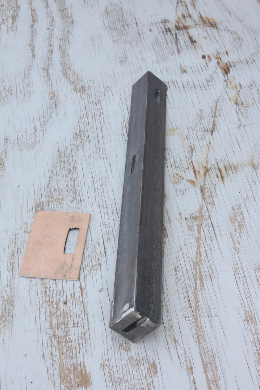

    Default Adjustable Gantry Mounts
    Since I have a sqaure tube frame, I decided to use angle to make an adjustable mount for the gantry rail.
    I cut a wood pattern so that I could cut slots in the angle. It would allow bolting the angle to the square tube legs. The slots are vertical so that the entire piece of angle can be moved up and down to level the gantry rails to each other.
    At the top of the angle, I put another piece that had a slot in it. This is to allow movement of the gantry rail closer and further in relation to the other side.

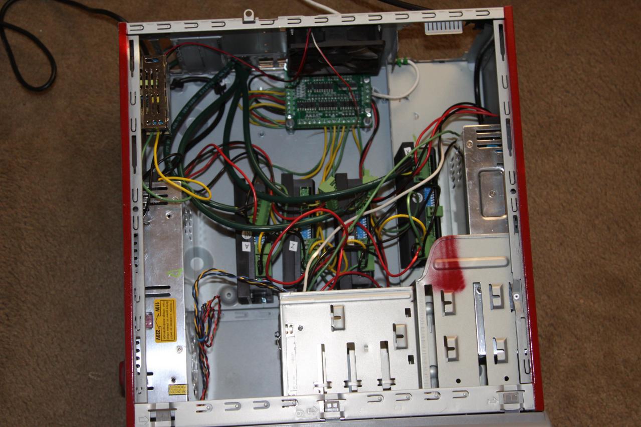

    Default Drive Electronics
    I've had the drive electronics set up for a while. I just hadn't gotten around to taking any pictures to post.
    I used an old PC case to house everything. I had thought about using the power supply in it for 5V and 12V, but decided it was too big and too much of a pain since it needed the power control logic overridden (no PC to power it on and off).
    This is a 4 axis kit from ebay. It came with two power supplies for the motors. They are mounted on the top and bottom of the case. I arranged them so that one of the x-axis motors was on each power supply. It seems like it would balance the load a little better.
    I mounted the four motor controllers in the middle.
    I left the original PC fan in. I got a small 12V power supply (upper left corner) to run the fan. I have additional fans and will add them if necessary.

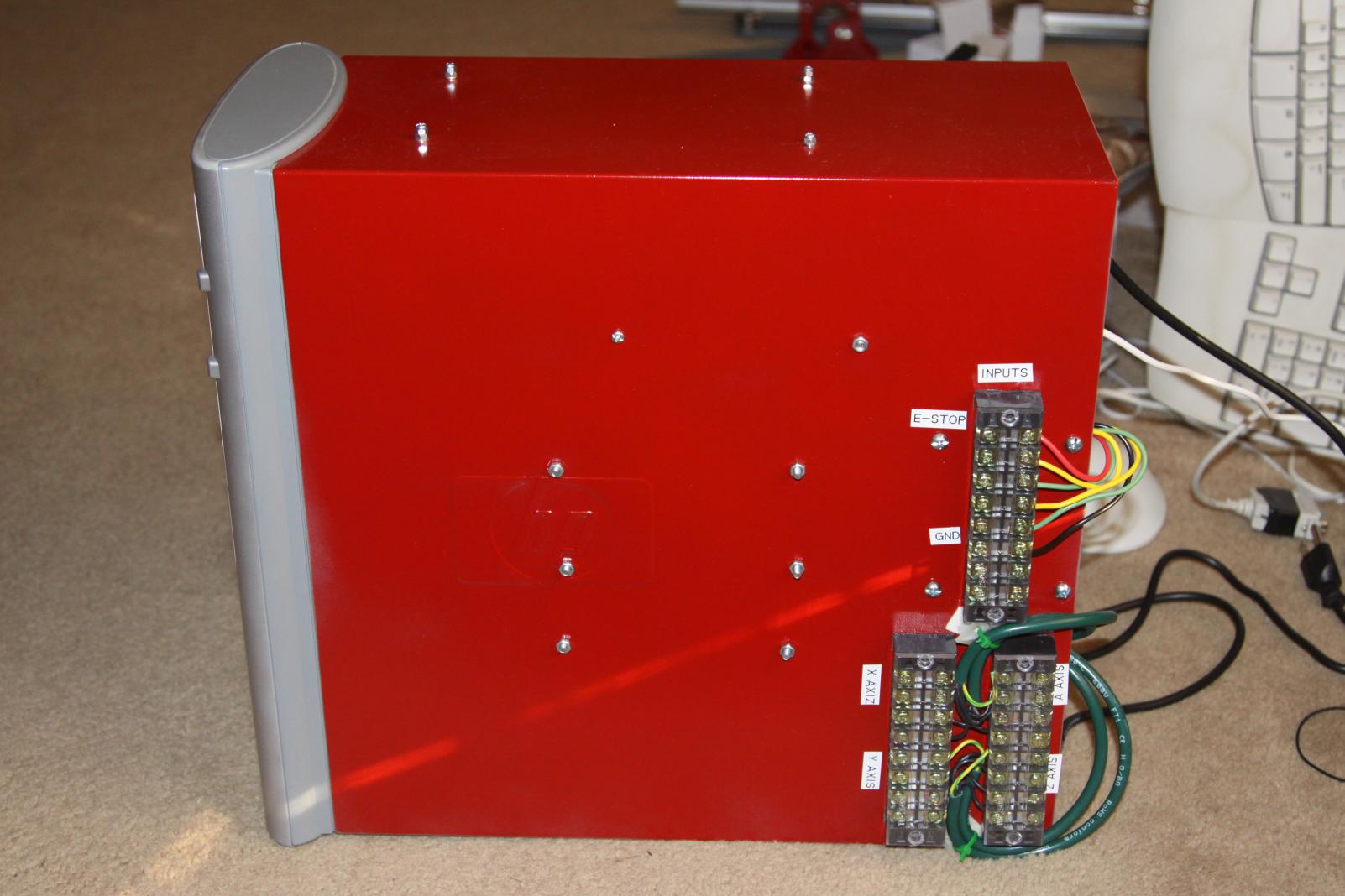

    Right under the fan is the break out board. I have it mounted so the parallel port connecter goes out an existing hole in the case.
    I have a five volt power supply (again, from e-bay) mounted in one of the drive bays. It's used to run the logic voltage on the stepper motors and the motor side of the break out board.
    I decided to use isolated power supplies for the BOB. I had an old 5V wall wart from an iPod, so I used that for the PC side of the BOB.
    I couldn't find any reasonably priced connectors that I liked for the drive cables. So, I went the cheap route and got a couple terminal strips. Given that I'm not going to be taking everything apart often, I think that will be fine.
    I've already had it all running the motors. That was the first thing I did when I got the kit. They had a 14 day return period, so I wanted to make sure that they worked.

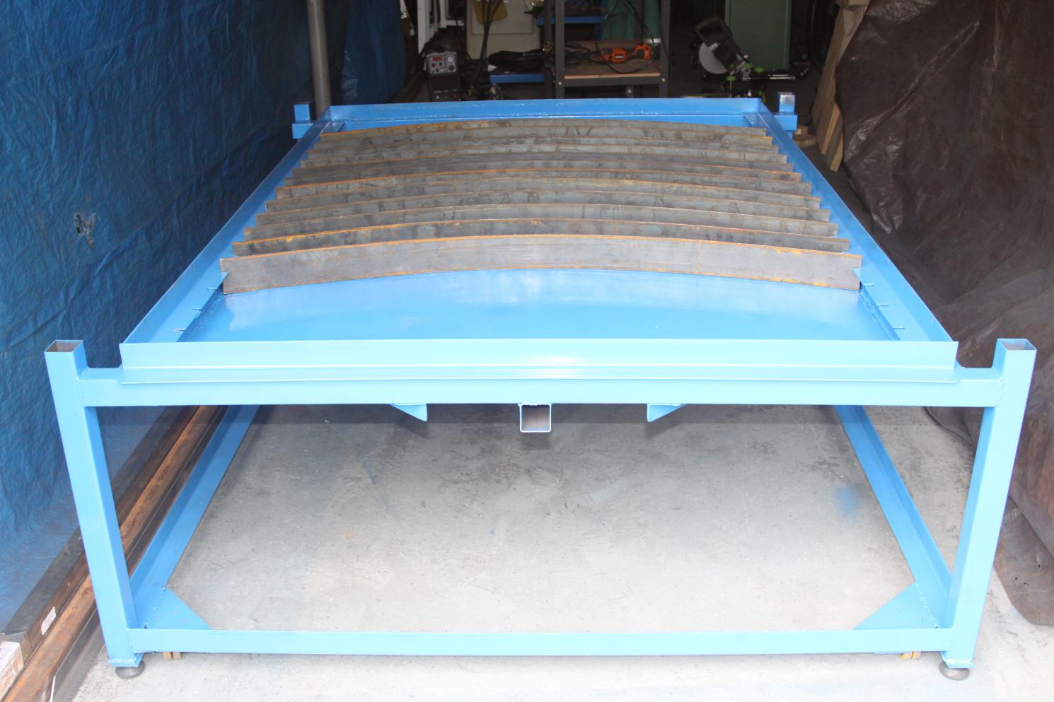

    I cut the slats and put them in the table.
    I had orginally put in slots every six inches. When I looked at it, I decided that was too far apart. So, I went to four inch slots. As a result, I didn't have enough steel to fill them all.
    I just painted the gantry rail mounts, so I'll be able to mount them and the gantry rails in a couple days.
    Question:
    I had been thinking of painting the slats with heat resistant paint. Anyone have any experience with that? Is it a good or bad idea?

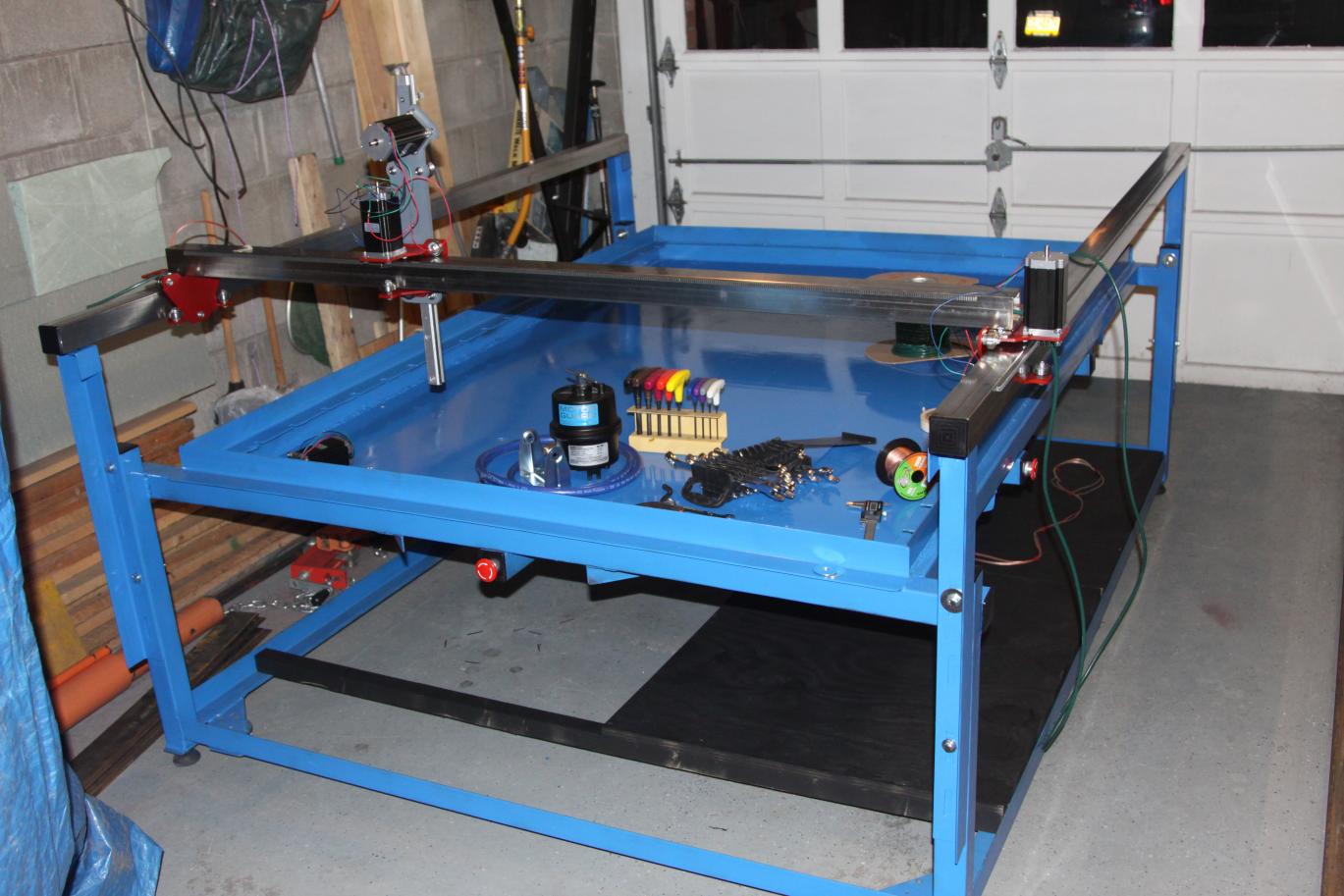

    Default OK - this is starting to get exciting....

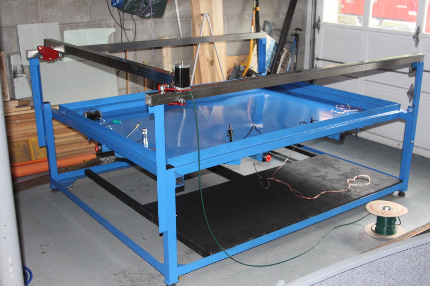

    Got the gantry rail adjusters and gantry rail installed. All the adjustments went well and it was easy to get everything square and level.

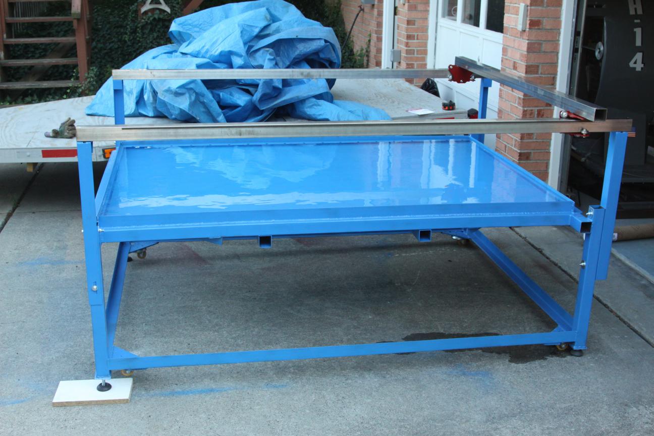

    Got the gear racks installed. Then did a third water test after using the leveling feet to set the table up. (Y-axis is just siting there, its not finished.)
    Leveling feet worked great. Only one small leak left in a corner. I'm not sure if I should use silicone caulking or the spray on rubber sealant. (The leak was in a tube joint and water was going into the frame tube and coming out a pinhole in the bottom weld. I drilled a drain hole in the bottom of the tube so that water wouldn't accumulate.)

    Looks really nice. I'm really liking the low deck height, I can just imagine how much easier it will be to load. I wonder if anyone has built one at pallet jack height.
    I'm sure any minor deflection will be taken care of by the torch height control. As long as your axis run true and do not contaminate each other a little Z error should be no big deal for plasma. If you also want to mount a router, you might have to be a little more precise. Since you have everything adjustable, I'm sure you can get it all dialed in.
    Have you taken any measurements to see how true your rails are? I know square tube isn't as close as DOM, but I don't know how much different. Did you measure your rails to use the best sides for the most critical axis?

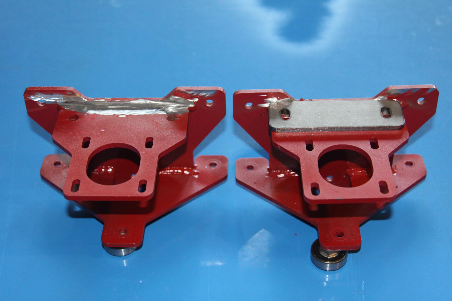

    Default Oversight on carriage assembly.....
    When I welded the carriage, I didn't think about the cross tube between the two x-axis.
    I ran a weld bead along both the top and bottom of each joint. The top of the top joint is where the y-axis bolts on. The weld bead would have prevented any adjustment in length of the y-axis (it's a slotted plate).
    A little bit of grinding and the situation was fixed.

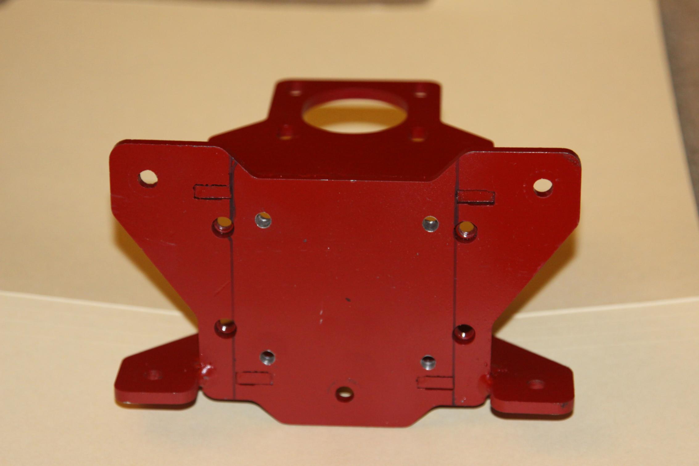

    Default Z-Axis
    I have the Precision Plasma carriage kit and the ShopDroids Z-Axis. The mounting holes didn't match.
    I had to drill new holes on the carriage. ShopDroids sent me spacers so that the bearing bolt head wasn't an issue.

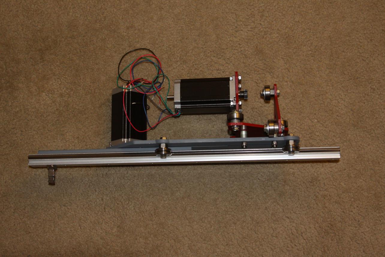

    I started final assembly of everything.
    The X axis is fine and seems pretty smooth (only have 1 motor moutned on it currently).
    I'm having trouble with the Y-axis. It will bind as I run it along the tube. When it binds the bottom of the vertical piece of the carriage seems to kick out from the tube.
    I did a quick check and it appears that the top and bottom plate are much closer than the x-axis carriages. Around 1/10" on the side you see in the picture. I'm surprised I didn't see it sooner.
    I'm guessing that the dimension is the cause of my problem, so I'll have to figure out how to fix it.
