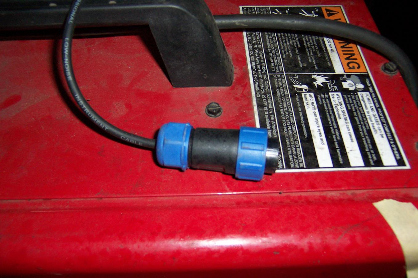

    didnt you get a plug for the back . I got one with my power plasma 50 Click image for larger version.

    I got the plug no wire, but let me go look!
    i got just the plug only no wire had to solder wires onto plug
    It looks like that style of plug needs the wires soldered to it. It will make the connection a lot more secure. You do not need to crimp them just fresh cut the wire, give the copper a little twist, tin the wire (apply solder just enough to wet the wire). Then lay the wire in the slot, then a touch more solder to set in place.

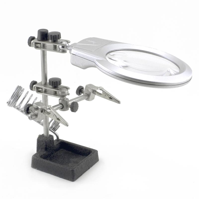

ID:	7342yes same as my plug sorta hard to solder since so small i use a helping hand holding set up when i soldered my wires .

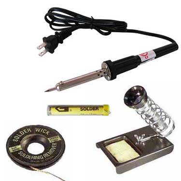

ID:	7343 you need a pencil solder iron then easy to solder

    A) Make sure the tip is CLEAN. Unless it is brand new, let it get hot and then wipe it with a damp sponge.
    B) Touch the solder iron tip with some fresh solder - just enough to coat it evenly. If you want, wipe with a damp sponge again.
    C) Let it get hot (again).
    Some will say the next step is not necessary but for those who are new at it, it can help ensure the connector doesn't get too hot and start melting on you.
    D) Put the tip under the freshly cut wire end (away from the connector) and touch it with solder until you coat it and then stop. Do this for all of the wire ends. Clean the tip if you feel it is getting dirty.
    E) Depends on whether you can somehow mechanically connect the wire to the connector. If you can do that then continue. If you can't mechanically connect them, you will need to physically hold the wire so that the end touches the connector.
    F) Put the tip under the connector and wire combination and touch it with solder until you coat them both and then stop. This is where Rod's suggestion of a third hand might come in handy.
    Not much unlike welding aluminum. Keep everything clean. Try not to apply too much heat but ensure the tip is hot before you do anything.
    Hope this helps.
    Good ideas... Just make sure you do not move the wire until it cools... Only a few seconds... If it does move the solder will look kind of frosty... Called a cold solder joint and it is not a good connection.

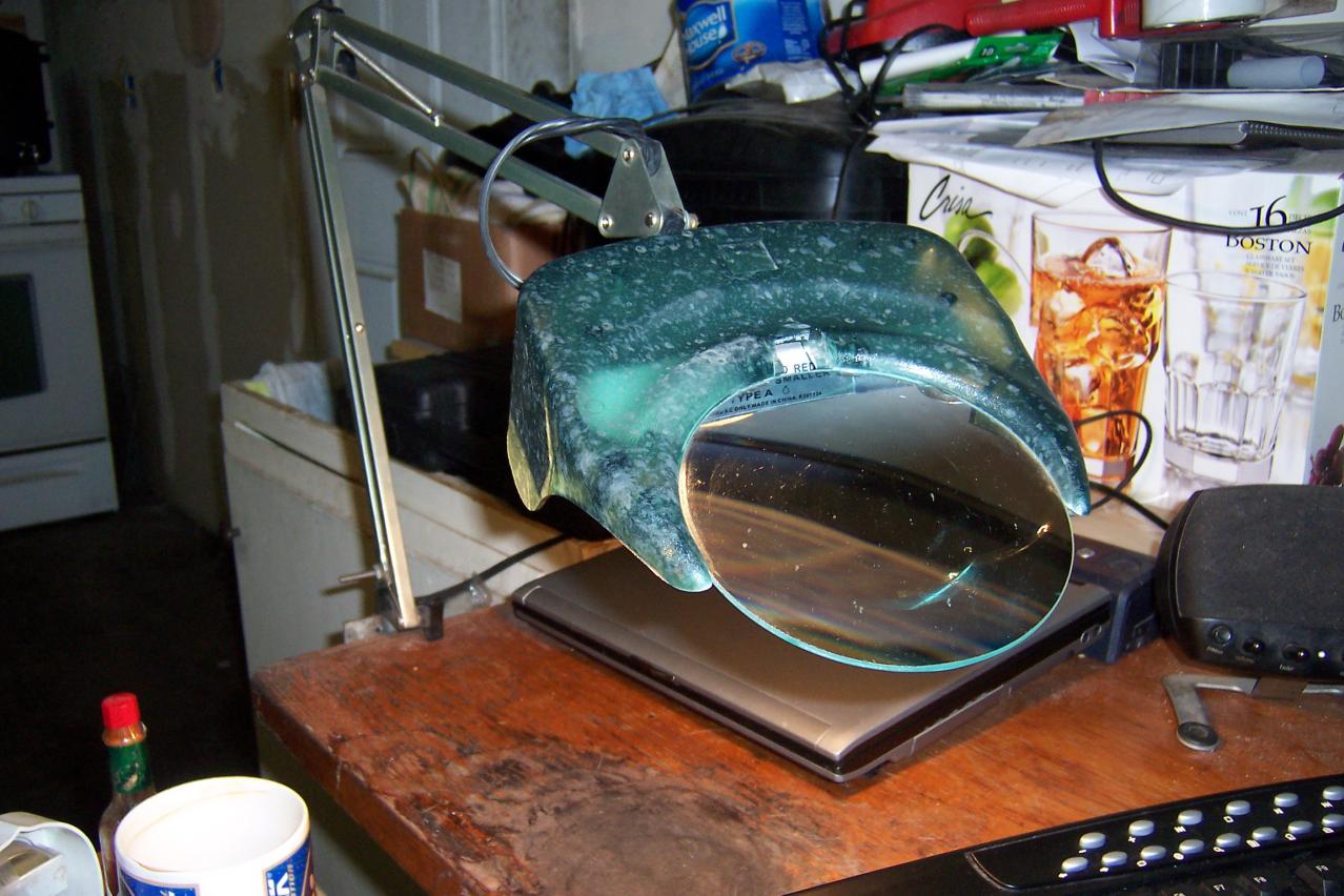

    soldering those little pins is a pain thank god i have my lighted magnifier or i would not been able to solder my plug . the joys of getting older and crappy eye sight lol Click image for larger version.
