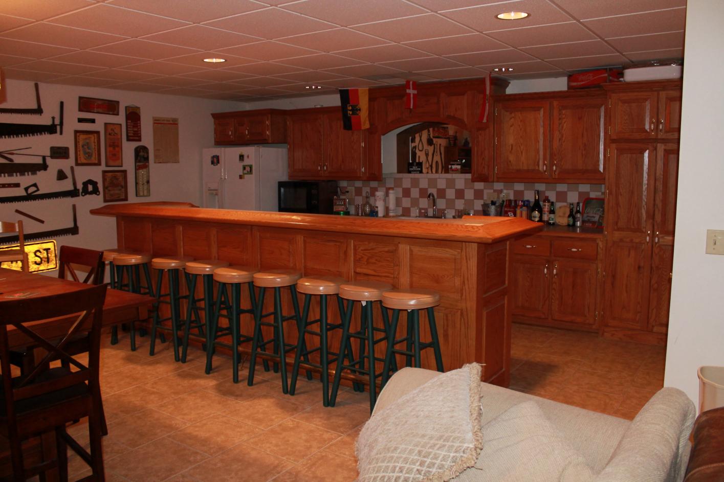

    Here is a pic of the Kitchen & Bar area i did in my basement, Bar is 144: long and has rear serving and storage counter. i have done a lot of these in the past for customers in the midwest.
    All oak raised panels, the top arch area over the sink area required patterns to be made for each piece , as this is required to run them thru a wood shaper is you just don't happen to have a CNC table in your shop.Takes about 12-16 man hours to get the bar done making parts and doing assembly , finish takes about 2 days , if you do it right
    Works out nice when we have friends and family in from out of town and from Germany. A good place to relax and have fun.

    Looks nice, you must do a lot of them if it only takes you 12-16 man hours. I'm sure it would take me twice that long(even if I did have a shaper).
    No so much a lot of bars, Just cabinets kitchens and custom furniture . I am 56 now and but bought my first tools when i was 11 and have not stopped building things yet. i just don't get in a hurry anymore due to health issue's. But my shop is very well setup and most machines are dedicated to one operation, I have 5 ,3 hp wood shapers and 1 ,5 hp, 1 extra 3 hp machine for weird setups and specials . Most machines are already setup with fixtures and quick change tooling. I learned a long time ago that the amount of time you lose doing tooling tear down and setup will pay for another machine very fast. I also run a 15 hp phase converter and use the more powerful 3 phase machines to make quick work of jobs and use less power. Anyone with a small shop can save a lot of money buying the 3 phase equipment and running it on a dedicated 3 phase converter and breaker panel for a fraction of the cost of comparable single phase machines. Drill presses, lathes, and milling machines bring a lot less money at auctions if they are 3 phase power instead of single.
    I envy you having the room for both woodworking and metal working equipment. I used to live in Wisconsin (grew up there) where everyone had some land and a nice big shop off the house or back yard. I moved to the Denver, CO area years ago and you can't just buy land unless you are way out east away from your work, etc. Everything is in your garage or basement! All subdivisions unfortunately with no land and restrictions on what you can build. Do you have any pictures of your shop?
    Very nice workmanship. Thanks for showing us!
