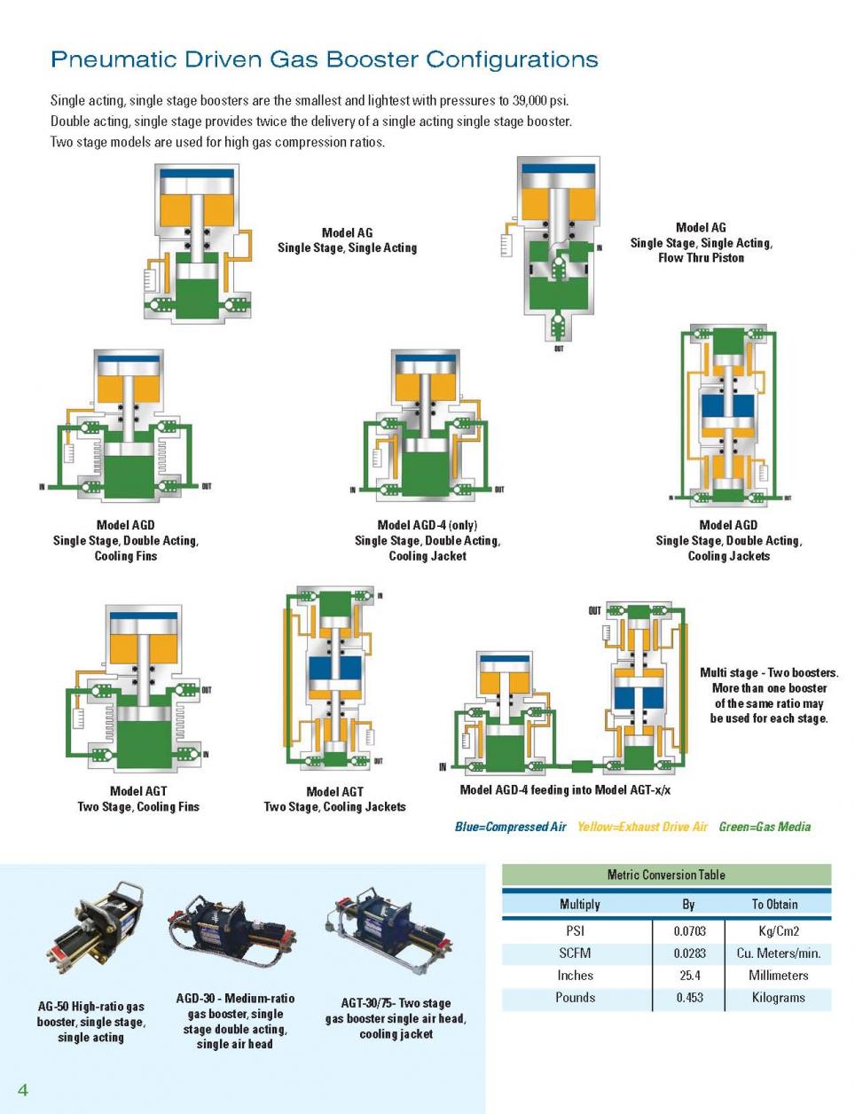

    I bought my 6 bottles from a welding supplier made in UK they did own for $25.00 each and no rental fees get the filled when i need them. After a few years got more bottles that were not the welding supplies companys for free, they did not want them now I've got 45 clean them and paint them my colors. Got some booster pumps cheap on the net and pump their gas into mine takes a few hours and give them the tanks back no rental fees. When gas price drop I got extra now all my tanks are full and I rent them to other people cheaper and now my are free it took 12 years but is worth it.
    What kind of booster pump??? I have looked into high pressure pumps before and they were quite expensive.

    Do you have to get your bottles hydro-static tested? I would think that you would want to get them tested for safety reasons.

    Hydro-static testing was done when I got the bottles cost $15.00 each I got my VIP certificate cost $110.00 (Visual Inspection Procedure). I fill the bottles myself and do not over fill more then the Plus + mark at the end of the date it was tested that given you 10% over fill. I got some bottles over 25 year old and are like new maybe filled 20 times in its life so far. From a welding supplier maybe filled 300 or more times and droped, left outside, empty with the valve open rusty can't see the names or thing like that yes test many times. If the bottle was new and fell off a dock or truck and it got a dent or deep marks in it it will fall VIP inspection and now scrap.The bottom of the bottle are well over 1 inch thick for 2400 psig bottles alot more for 3200,3600,4500 and 6000 psig are almost 2 inches thick. Bottles drop and land on the bottom will not do anything thats why they make them like that. But heavy side hits or welding marks usally are scraped. The life of a bottle can be alot I have seen one made in 1936 and still in service.
