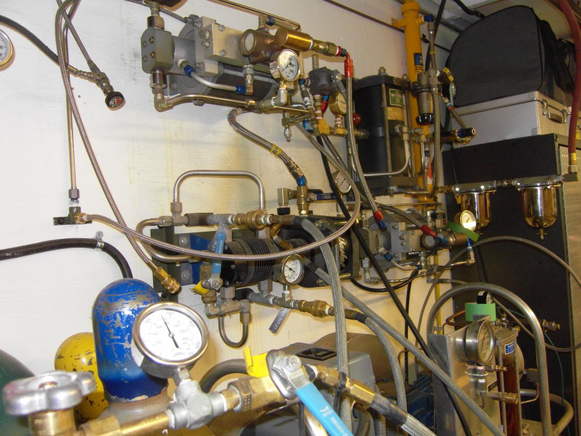

    I bought my 6 bottles from a welding supplier made in UK they did own for $25.00 each and no rental fees get the filled when i need them. After a few years got more bottles that were not the welding supplies companys for free, they did not want them now I've got 45 clean them and paint them my colors. Got some booster pumps cheap on the net and pump their gas into mine takes a few hours and give them the tanks back no rental fees. When gas price drop I got extra now all my tanks are full and I rent them to other people cheaper and now my are free it took 12 years but is worth it.

    That's a lot of bottles!!! I was thinking of buying the fittings required to fill my 20 and 40cf tank from my 336. I don't care if it goes to 2000psi on them so dont need a pump. One thing I was thinking was I could put the little bottle in the freezer to get the pressure a little higher once it reached room temp.
    What kind of booster pump??? I have looked into high pressure pumps before and they were quite expensive.

Name:	Haskel_Gas_Boosters Pumps.jpg
    Haskel booster pumps have oxygen pump and none oxygen most of them oxygen compatible. The best one is AGT-15/30 it will pump to 9000 psig sounds high but you need it because it will pump the tank empty and fill your tank to 2500 psig from a low pressure. All the pump have area ratio so 15 is 6.2 cu.in. 30 is 3.1 cu. in. so it takes the 15 and pumps it into the 30 then out. Yes the the smaller the number the bigger the pistion. A place to find pumps cheap some times https://www.govliquidation.com you bid on them good old USA Military hunt for words as BOOSTER, HASKEL, SPRAGUE, CURTISS WRIGHT and PUMPS sooner or later they will show up. I will be selling some of mine next year just got to many like 9 pumps you bid on them and you get 3 in the lot some good or not make one or two good ones out of them or you get lucky and they are all good or bad but there are usually OK just need a little work.
