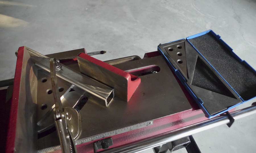

    hey Shawn. I wanted to share with you my solution for cutting angles. I also do not want to change my square setting of the vise to blade, when I am getting cuts square to within a few thousandths now. I use one of the funky clamps from HF, attached thru the vise adjustment slot. The stock is against the edge of the fixed vise jaw at one point. Also I use some angles I got from Enco to set the proper degree. Once the angle is made and the stock set with the clamp, I bring the movable vise up to the stock and tighten the thru-bolt, so it is repeatable for the next piece. Works well for hobbiest-speed work.
