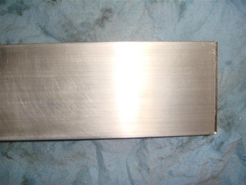

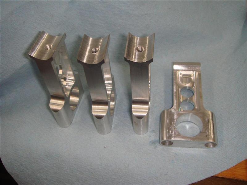

    This was going to have a little welding in it, but I changed my mind. I was going to make it out of half inch and build up the top part with weld, but in the end I just whittled it out of 3/4 stock, instead. These are mounts to attach some areo bars to a pair of bicycles.
    Started with 3/4" x 2" 6061 T-6 extruded bar.

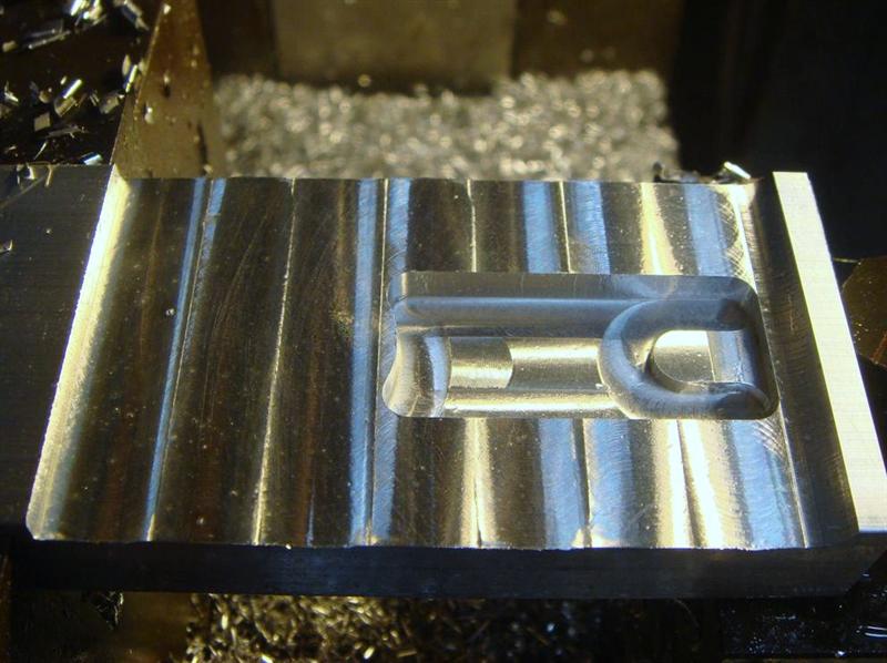

    Carve out one side.

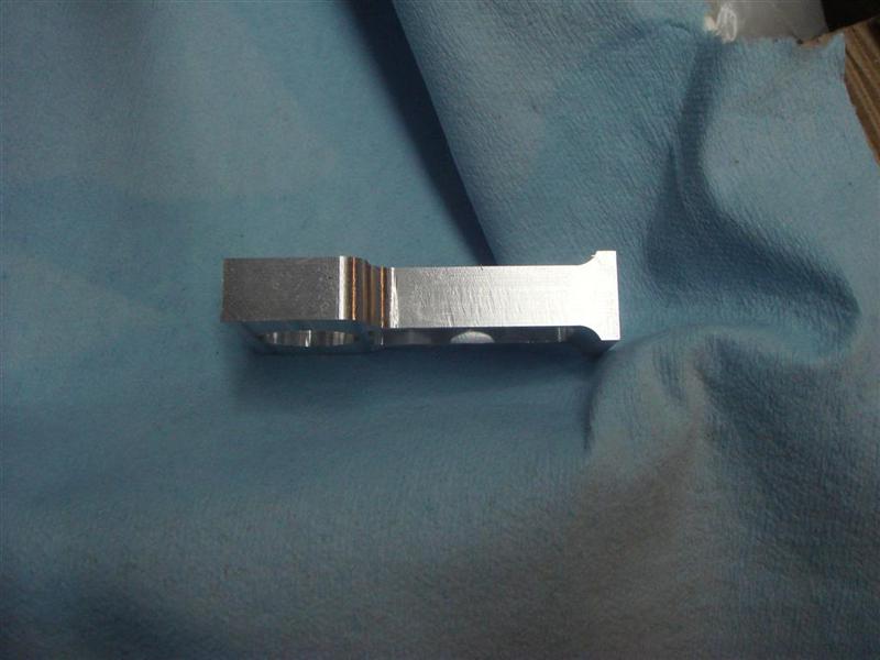

    Flip it and do the other side. Bore the holes and profile the part out.
ID:	7304Click image for larger version.

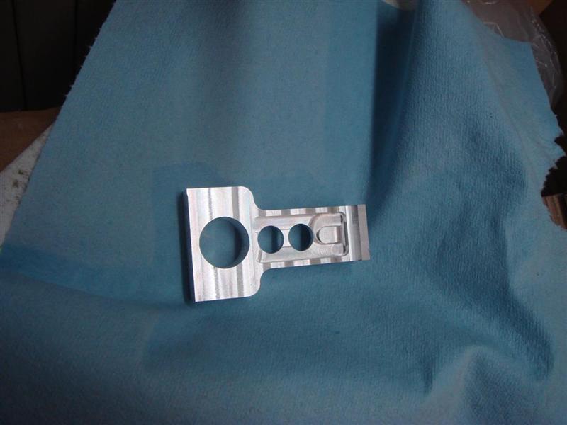

    Flip again and drill, tap, clearance, and counterbore a couple of holes. Profile the ends round.

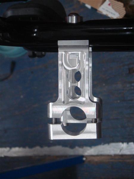

    Flip and scoop out the top. Drill and tap a hole.

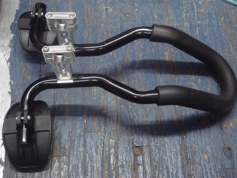

    Here they are mounted to the bars.
ID:	7308Click image for larger version.
    Test fitted on some handlebar tubing.
ID:	7310Click image for larger version.
    I'll probably give them a nice glass bead blasted finish to smooth out the machining marks. Although first I have to clear some junk away from the bead blast cabinet, and I think fix some air fittings on it. Shop maintenance never ends.

    They are for my fiancé and I. A lathe is usually the first machine tool, but these days the line between mill and lathe gets blurry. These parts could have been made on either, but I used a mill. Specifically an old Alliant 42VC 2HP varispeed with an Anilam CNC control circa mid 1980's. Due to space issues I had to get rid of my big lathe, so now I have an import 9x20 that does the job. Space is one of the big reasons I'm looking to replace my TIG machine with an Everlast.

    Nope, I just used a 2D program to draw them out, so no volume calculations. I did try to keep them pretty light, but nothing extreme. They came out to just over 40 grams each, and with stainless hardware just over 60 grams. Actually, until you asked, I didn't even bother to weigh them.
