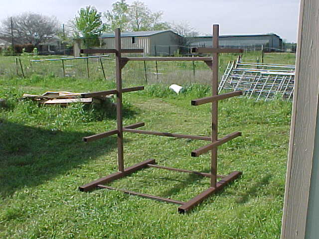

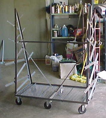

    This is an old thread, but if anyone is looking to make something, this is one I made a while back. It worked pretty well.
    Later on, when I wasn't wheeling the steel around anymore, I cut the arms off the back of this lumber storage stand I made, ran 1/2" flat from the top to the back end of the feet for triangulation, and shuffled the steel onto it.
