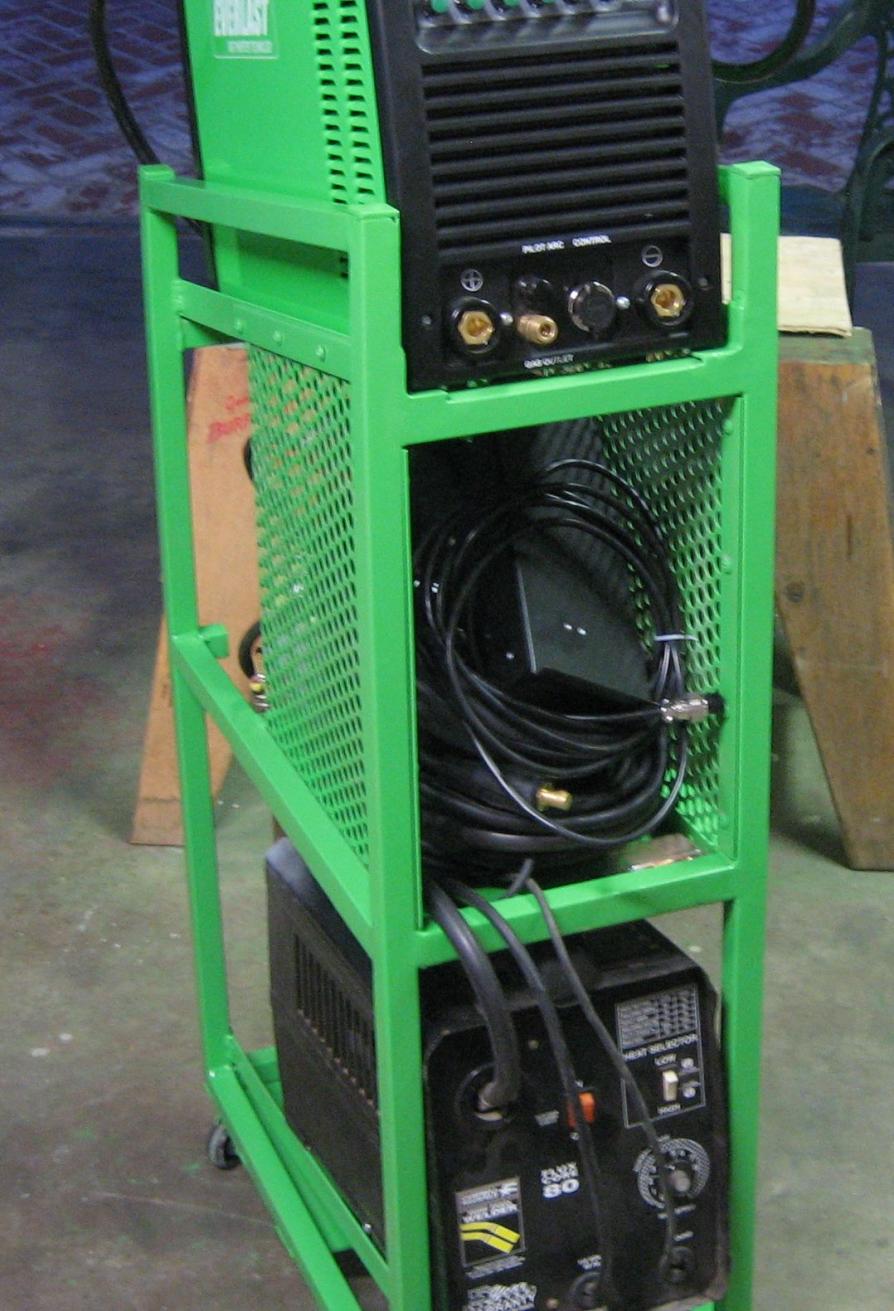

First thing I had to do when I got my PP256 was to find a home for it.
It's going to have to share quarters with my old 120V MIG welder. I'm giving the 256 top bunk and the MIG bottom bunk.

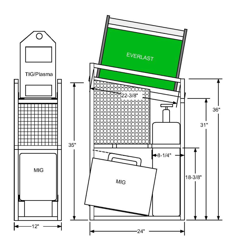

Here's what I came up with. Of primary importance was to minimize floor space, so the cart is as narrow as I can make it.
It's not particularly top heavy, and since it lives on a smooth floor and won't be moving around much, it should do fine.

And here's a simple drawing in case anyone's interested in the dimensions:
