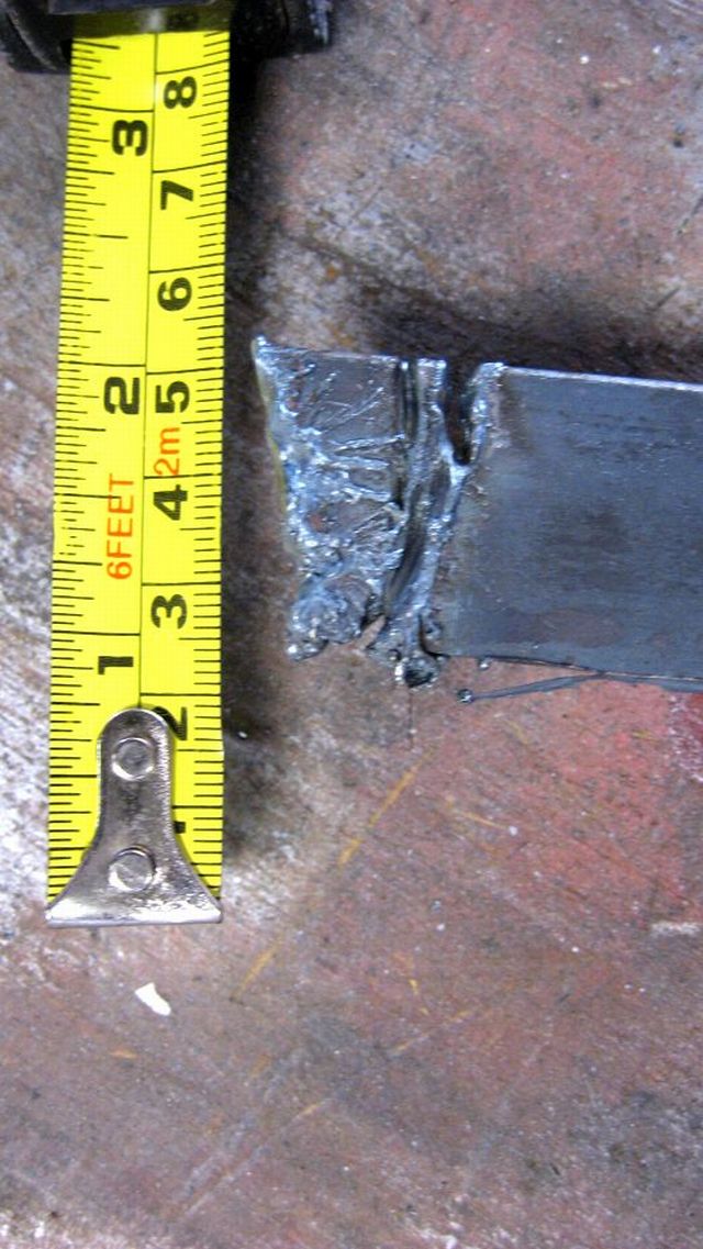

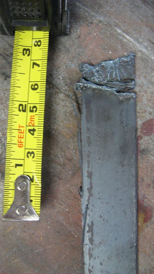

    PP256 brand new, can't get plasma to work. Air pressure is OK, electrode and cap are tight. Torch (A81) produces a bright blue/white plasma flame when squeezed in mid air. But when I try to cut 1/8" mild steel I get all kinds of blowback that fouls the cap and very weak cutting. Plasma cut a shallow kerf into the metal, but wouldn't cut through. Today I tried again. Held the torch with roller standoff just off the edge of steel I need to cut (which was grounded back to the PP256 + terminal) and the plasma immediately stopped when it contacted the steel. Repeatedly. And I'm approaching the steel slow and there's less than 1/8" gap between the standoff and the cap on the A81.
    So, first I got very weak cutting action and lots of stuff blown back on the cap. Now no cutting action and the flame goes out as soon as it touches the work. This is my first experience with a plasma torch, so I'm a little clueless.

    Attached are some pics I shot. The shot of the face of the PP256 was taken after I turned off the air compressor, so the amber cut light is not on.

    Cut the air pressure back to around 55 psi and approx 40 amps,,,too much air is not always good,,,move very very slow and steady like a machine,,,watch for a rooster tail of sparks coming from the cut,,,try and keep that spark pattern steady,,,moving too fast will snuff the cut action and make it incomplete as shown in your photo's,,,the pilot arc you describe is as it should be...the cutting will take place when that stream touches the metal attached to the ground/earth clamp..
    Getting a splash back is a sign that you are moving too fast for the cutting action...move slow and steady use a piece of angle iron for a guide until you get the hang of it..on 11 guage you could probably get away with out the stand off,,,just using a drag..

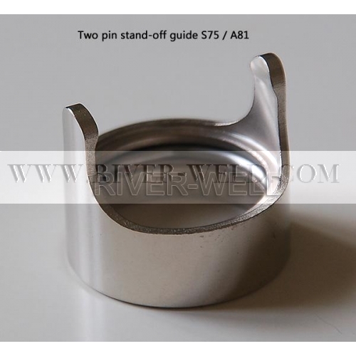

    looks like you are touching work and way to close stand off . i run about a 1/4 inch from work when cutting saves on tip . the stand off you are using is not rite for your torch buy the rite one Click image for larger version.
    that stand off you are using is for a s45 not a a81 torch
    My A81 standoff looks like the one in Slarty's picture.
    I have used them a few times and they work fine (big problem is they eat the heck out of the retainer nozzle rim edge).
    Now, the standoff from Plasmahelpers.com I have to reported back to them (no I get no kick backs on their stuff or the TIG finger). It is the better of all of them I have used, but the threaded rods are too close to the torch head again on the A81.
    I like the s45 torch seems to work great for me .
    A flow gauge came with the argon regulator. But none came with the compressed air moisture separator/pressure regulator, which was shipped without a pressure gauge, too, which Oleg took care of. The A81 standoff is, indeed, the wire one and holds the tip a little more than 1/16" off the work. I also purchased a roller standoff, expecting I'd be making some long cuts in 11 ga steel this weekend, but that didn't happen and I'm all gritty now and my skillsaw is smoking from cutting with the friction blade and I've got to sweep out the shop now, and I'm battling a bad attitude at the moment. I'm sort of done, I'm afraid.

    NO that is WAY too far. Standoff should be less than 1/8" and 1/16" if possible. The standoff is the one that comes with the torch if I remember right. This isn't oxy/acetylene. If you'll read any material related to Plasma, it will tell you keep stand off close for plasma. It lowers dross and reduces kerf...and it will actually reduce the wear on the consumable.
    Having too great of standoff also hinders arc transfer and since it is a CC process can make the voltage spike somewhat on the unit which isn't great for the electronics.
