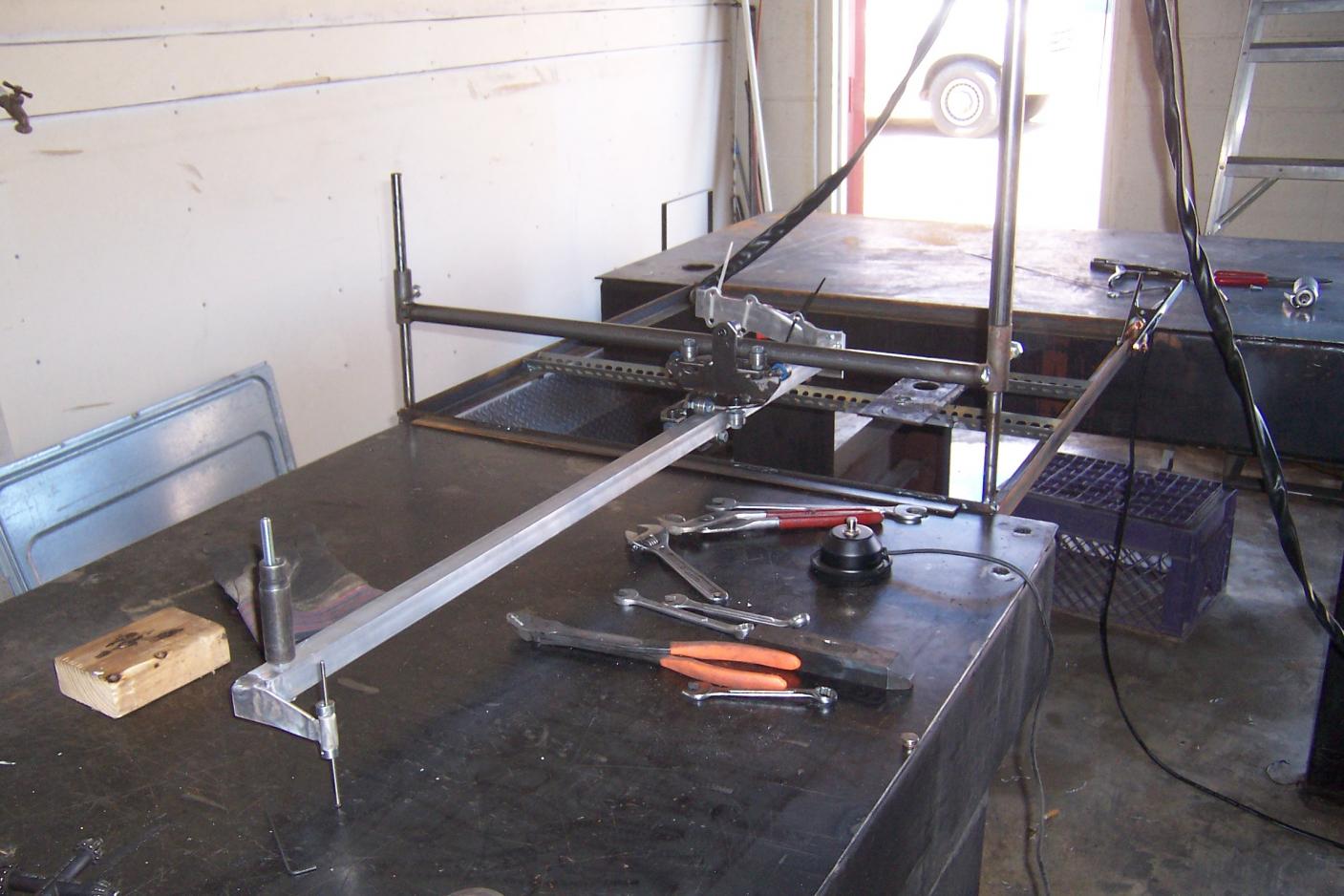

    Here are some pics of my 60C. There's no hook up for a torch switch. I guess you might could make something work with the CNC port.
    Check the Canadian site it shows that input on 3 phase ,,,,normally the breaker requirement on a single phase plasma is 10 less amps that it's rated output,,,a 50 amps plasma needs a 40 amp breaker and a 70 amp plasma needs a 60 amp breaker,,,etc,,,etc,,,

ID:	7231i used a foot switch for my tracing table it is connected to the cnc plug on back of my plasma cutter . the switch is sitting on the bench in pic

    Is that pretty much all the pinout for the CNC port is? On and off operation of the cutter?
    Looks like a few pins for torch height control and verification of cutting signal to the CNC.
    Where'd you get the pinout? Definitely a lot more communication going on than just on and off. So clearly if I want to get into a CNC setup in the future the CNC port is absolute must?
    On this forum
    It helps, but from what I understand it's not a must. If you use a complete torch height control such as the Eagle one Sean posted about, (http://eagleplasma.com/thc.htm) you can skip the voltage divider pins. That can also supply the main arc confirmation, as well, which can probably replace the ok to move signal. If you look around you can even find basic plasma CNC tables that use the normal hand torch with an actuator that just pulls the trigger. Maybe not the most elegant, but it works, and you can go back and forth from CNC to manual without a second torch.
