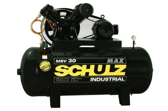

ID:	7227I want this compressor 30cfm would be nice for all the sand blastingClick image for larger version.

ID:	7226 i do , really good price 1500.00 with free shipping, hey just had a brain fart lol forgot buy a refurbished compressor like half price with same warranty here a nice big one for under 500.00 http://www.northerntool.com/shop/too...duct_200396621

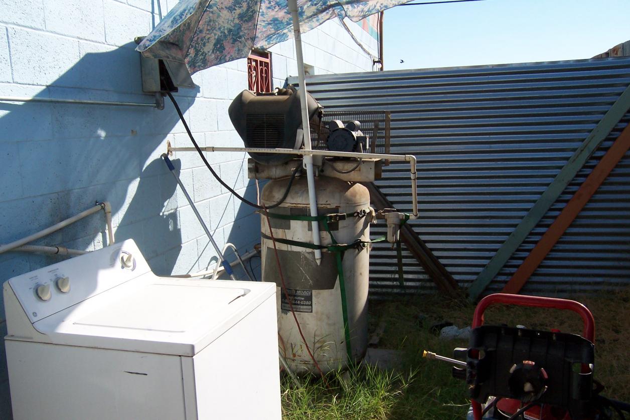

ID:	7228lay a cement slab like i did outside with a over head roof for rain better out side cooler for air compressor and most big compressors are noisy . tell you a funny story when i had my shop in palm springs my big compressor was in the customers bath room . made a lot of women scream when it fired off running in the bath room lol here a pic of the beast out back lol
