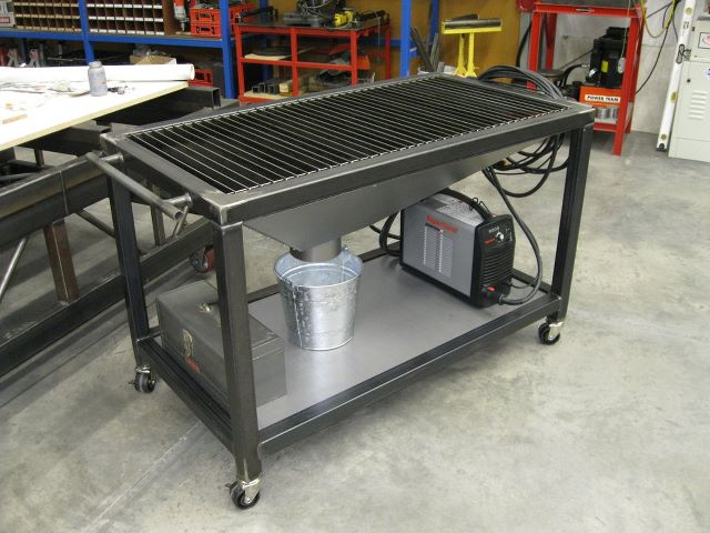

    Just make something like this dont have to be this fancy could just make out of cheep angel iron Click image for larger version.

    Rod that looks like a nice table, is it yours?

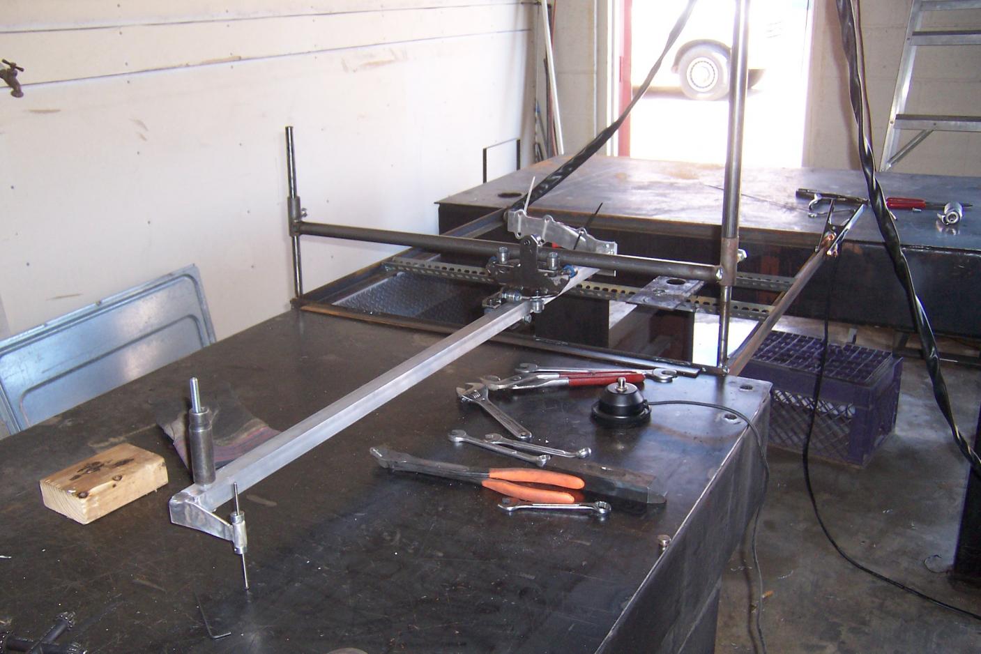

    no just came across it on the internet is a nice table . i made mine so it sitting between my 2 work benches so when not using I can hang on theClick image for larger version.
Name:	engine rebuild and installs 008.jpg
ID:	7225 wall when not using

    That's the Exact one I was looking at to build. I just didn't want to spend the time and money in that thing if I could build a CNC table without all the gantry and stuff and just use it till I convert it to work.
    That is a Nice table in the pic for sure!
    What's a good size for table? I was looking at 2' x ? Maybe 30" x ?
    Question: As far as the poop shoot on that table.... I had planned on making just a box under the grates to catch cuttings. Should I change it to have a shoot or will removing the grates and cleaning it out once in awhile be fine?

    That is nice Rod...very simple. Is it rigid enough for cutting? Probably could make a quickie 2 axis nc with that as well....simple like a printer carriage or vinyl plotter with an end to end belt drive.
