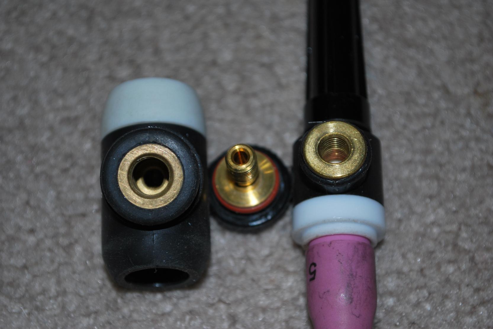

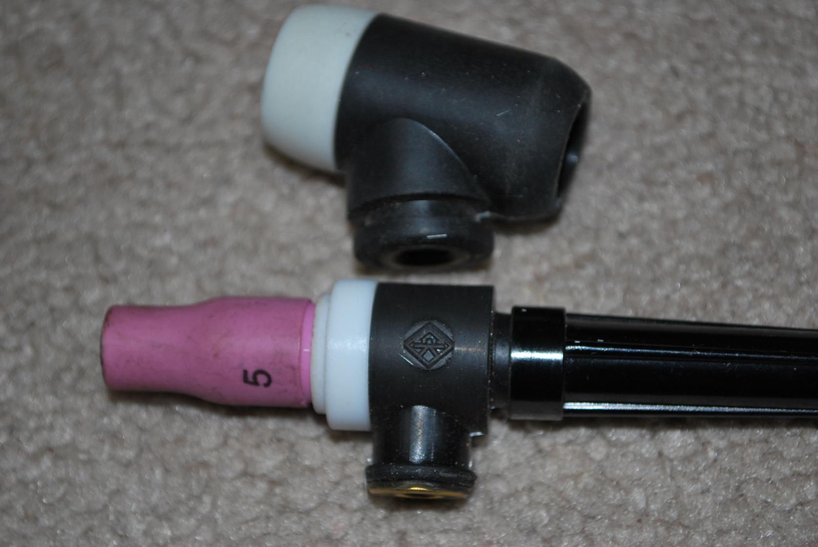

  10. Default What does the larger head go to?
ID:	9862Click image for larger version.
    Oleg sent me this stuff. The 130 head is genuine ck but the suggestive 150 amp head does not thread into the thumb screw. I contacted CK they said both the 130 and 150 amp fit the same thumb screw. SO what the heck is this thing too?

    The 17 series head sure doesn't look CK, I think you have a mixed bag there.
    You are right...The 17 head doesn't have a CK stamp either. I would love to know what this goes to. I wonder....

    Maybe a true trafimet. They have had a flex lock type for a while. Someone may have rebagged a sample?
    I didn't know that Trafimet made those. I went to the website trafimetusa.com and searched the pdf doc TIG section. I didnt see the product listed or any flex loc head. Well if we can figure this out Im willing to give it to whoever can use it. I love the CK flex loc and will buy the genuine 17 style head that I need.

    I sent some photos over to CK. Jeff and Bonnie helped me out. Great folks.
    Jeff says,"Mystery solved. The head that you shown in your picture is not our 150 amp Flex-Loc head. That is a replacement head for a WP150 modular torch system by Weldcraft. The screw on threads that attaches the head to the body is much larger than our Flex-Loc. The part number for the head in your picture is 1726. Our replacement head for 150 amps is part number FL3L. Two different animals altogether."
    If anyone has the torch system described, PM me or reply and Ill send it to you, or back to Everlast. First come first serve!
