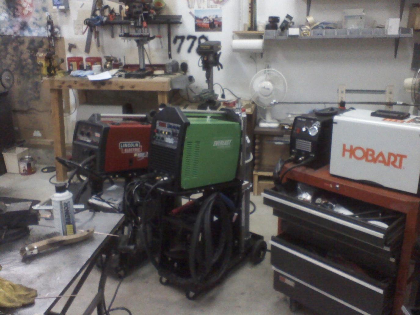

    Fantastic ... thanks ... here is how my welding station looks nowClick image for larger version.

    A 200DX ready to go...I am envious. Nice mix of tools there.

    Fantastic ... thanks ... here is how my welding station looks now. How cool is this?
    Way cool. Nice looking setup you got there. So everything is going OK now?

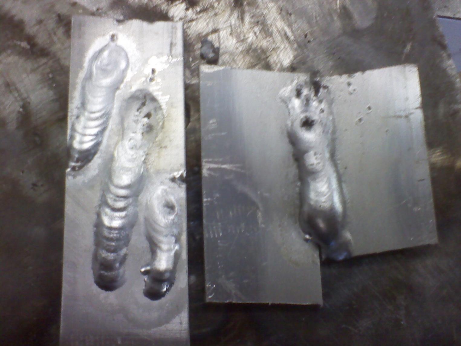

    Here are my first ever attempts at aluminum tig welding ... I know they aren't pretty and I need to clean my aluminum better along with my first beads is my first butt weld ... I'll get it figured out eventually but I must say this machine just blows me away!Click image for larger version.

ID:	7197 My DCEN on mild steel looks much better ... but I've been doing it for a while ... this AC TIG on aluminum stuff is brand new to me.

    It'll come to you, Winky, and will be like second nature once you've got your practice time in. You've got a great machine there. Have fun!
    An old saying, practice, practice, practice. It takes time. And A/O does not always make aluminum come easy on TIG.
    I would bump up the post flow or at least stay over then end of the weld and let the gas shield it at the end of the weld (one you release the power). Looks like you are pulling away when the arc dies.
    You will want many beads to get the feel and see how aluminum melts and flows, not quite as colorful and clear as steel.
    Keep at it man.
