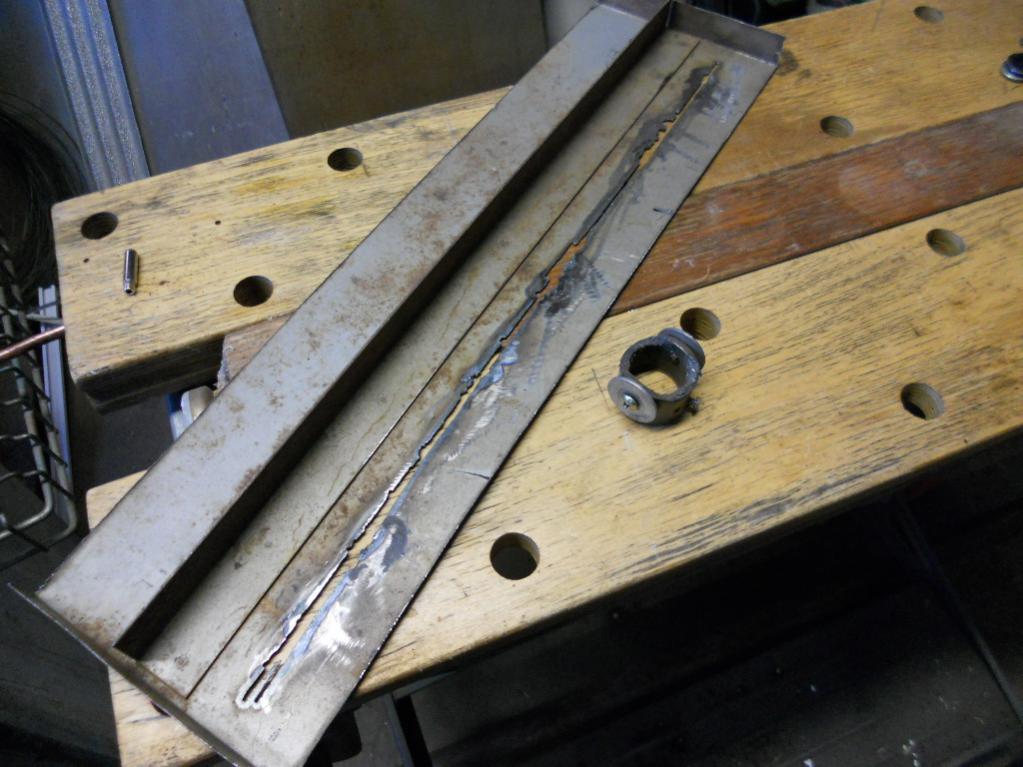

The straight edge:
This handy dandy little straight edge for the roller guide is adapted from a skillsaw guide from either Tommy or Norm on TOH.

I just formed an aluminum pan and TIGged a piece of T stock down the center then made a slit to view where your cut will be. Use the largest tip at the lowest pressure to get a nice wide kerf.

Lay out your cuts with soapstone, line it up and cut. It works quite well for cutting slots with the end serving as a stop, and beats the heck out of freehanding a corner clip (at least for me).
