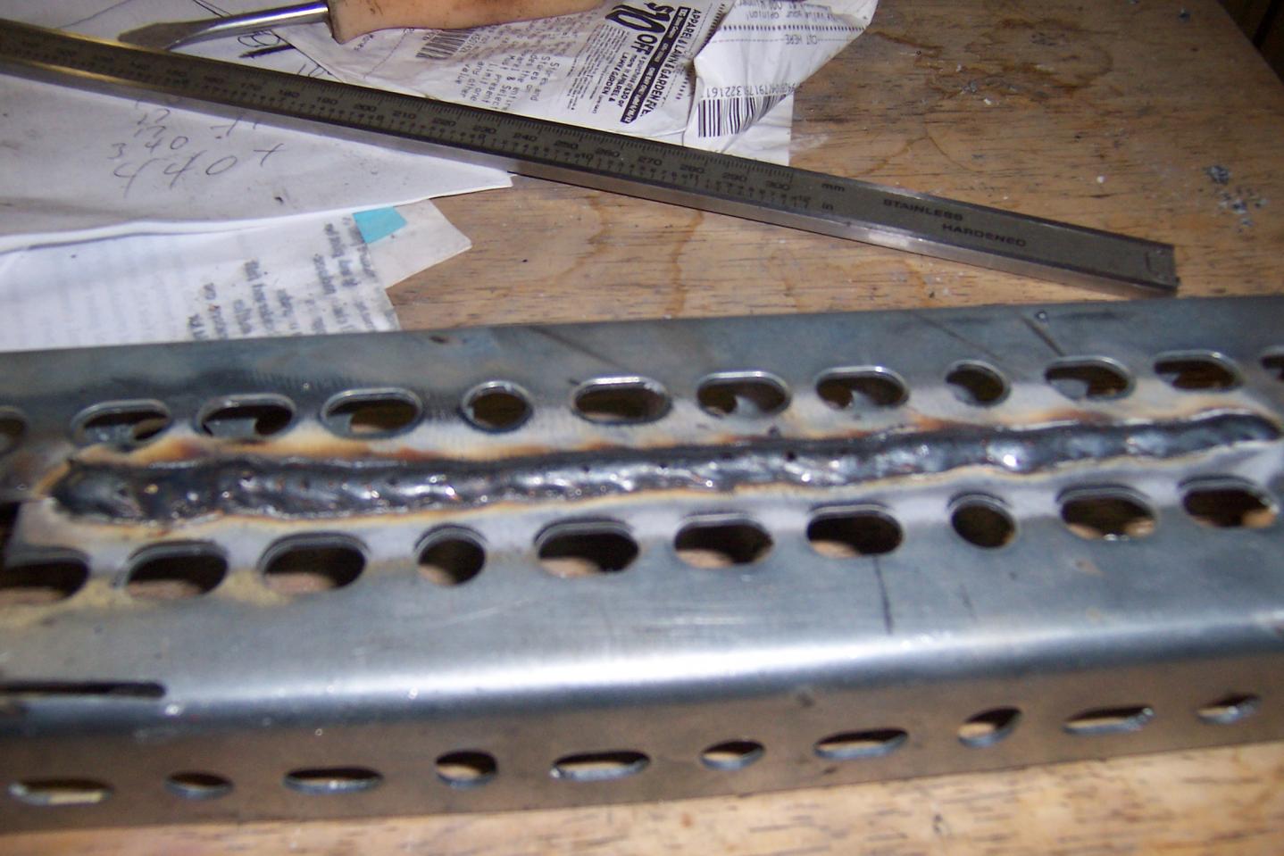

    1/16 welded with .035 on my i mig 205 , Click image for larger version.
ID:	7108 for exhaust and thin stuff i love .023 . .030 just seems just a tad thick for exhaust tubing welding but works ok .

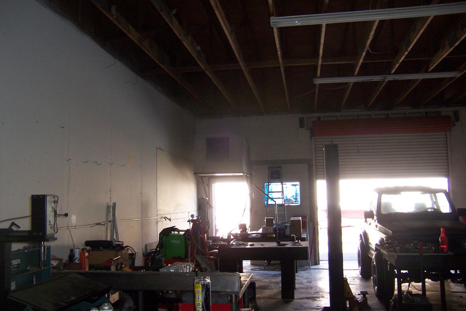

ID:	7109its the 2 big swamp coolers running lol big boys 8500 cfm coolers should of saw me getting that big cooler over my door way lol
    Too funny. I see where the draft is coming from there. I have the same setup but smaller.
    yey have it ducted in the back to draw fresh air from the door way , it was darn hot today need to put some roof vents in to let the hot air escape in the ceiling area
