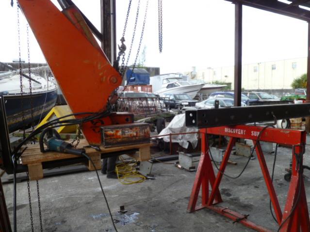

    i was asked to fabricate some new sticks and connect to damaged telehandler. no picture of weldout of connection.
    done with 7018; sleeve and two sides welded together with root pass. stick was done with NR 211 MP. one pass

    i always called them lulls (a mfg) but telehandler is correct; they are used for moving just about anything. no this yard contains a lot of goods that will either be sold as scrap or repaired and shipped to south america or the islands. i am working on three (when the owner has the money, just fabrication) of them. in december i went to chicago for the guy and arranged for shipping a jlg 135 aerial lift. it is in pretty bad shape. it appeared someone was tied off while fully extended in a rock quarry, they began moving the unit and tipped over. couldn't get anyone on the site to give me the whole story. probably covering for a union bro.
