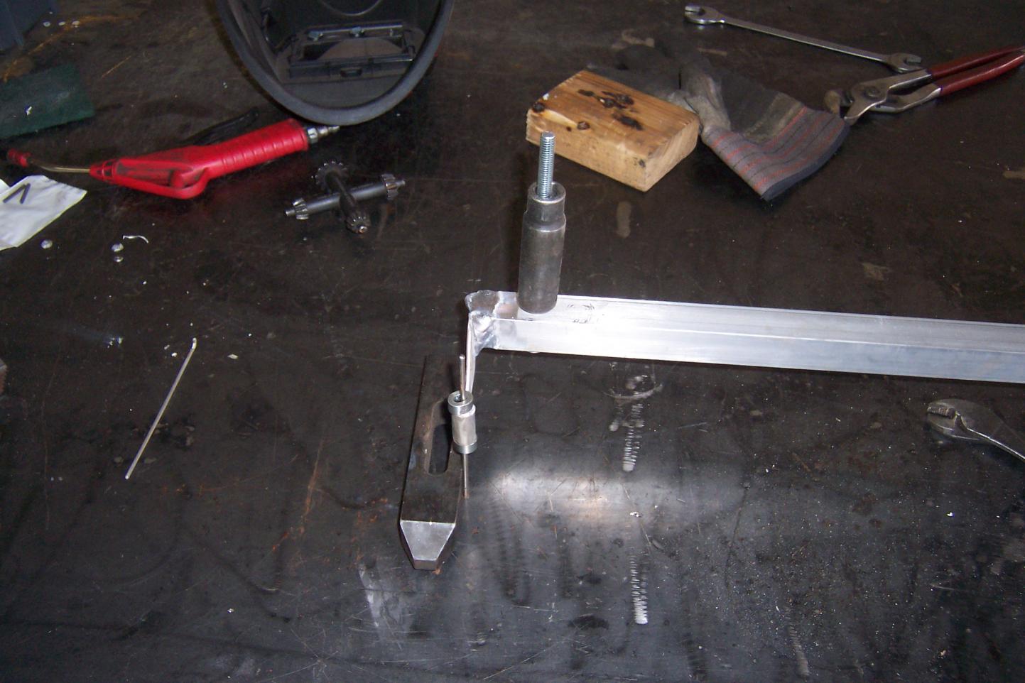

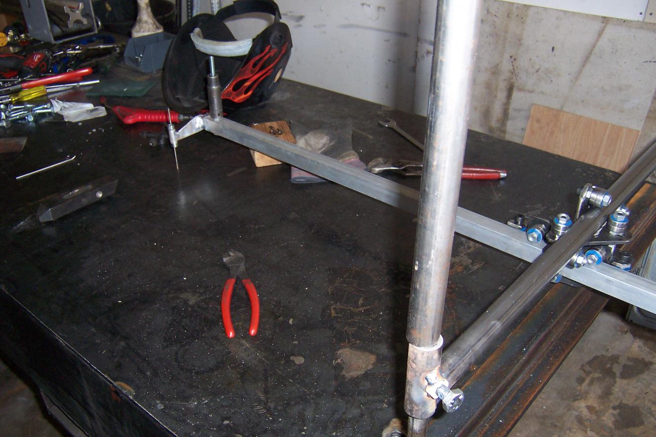

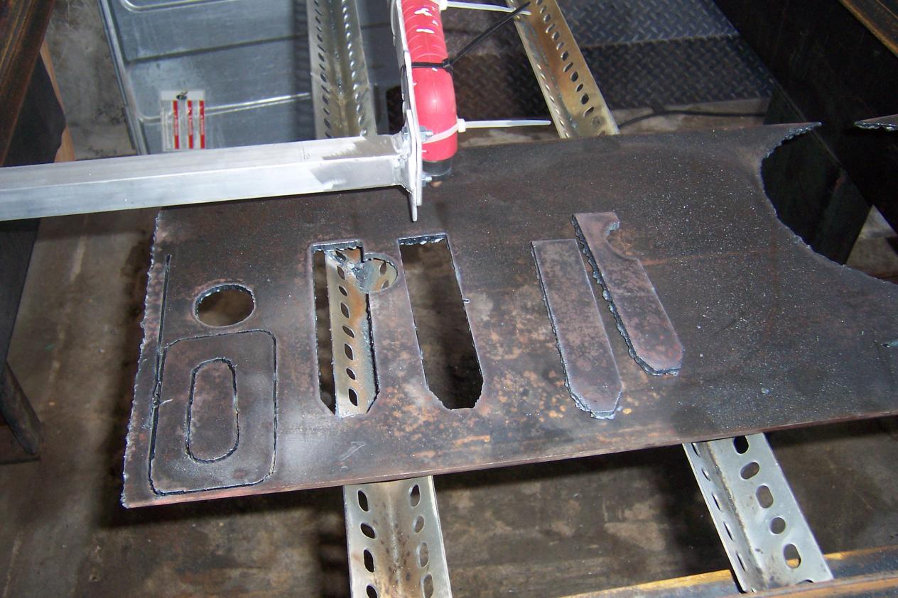

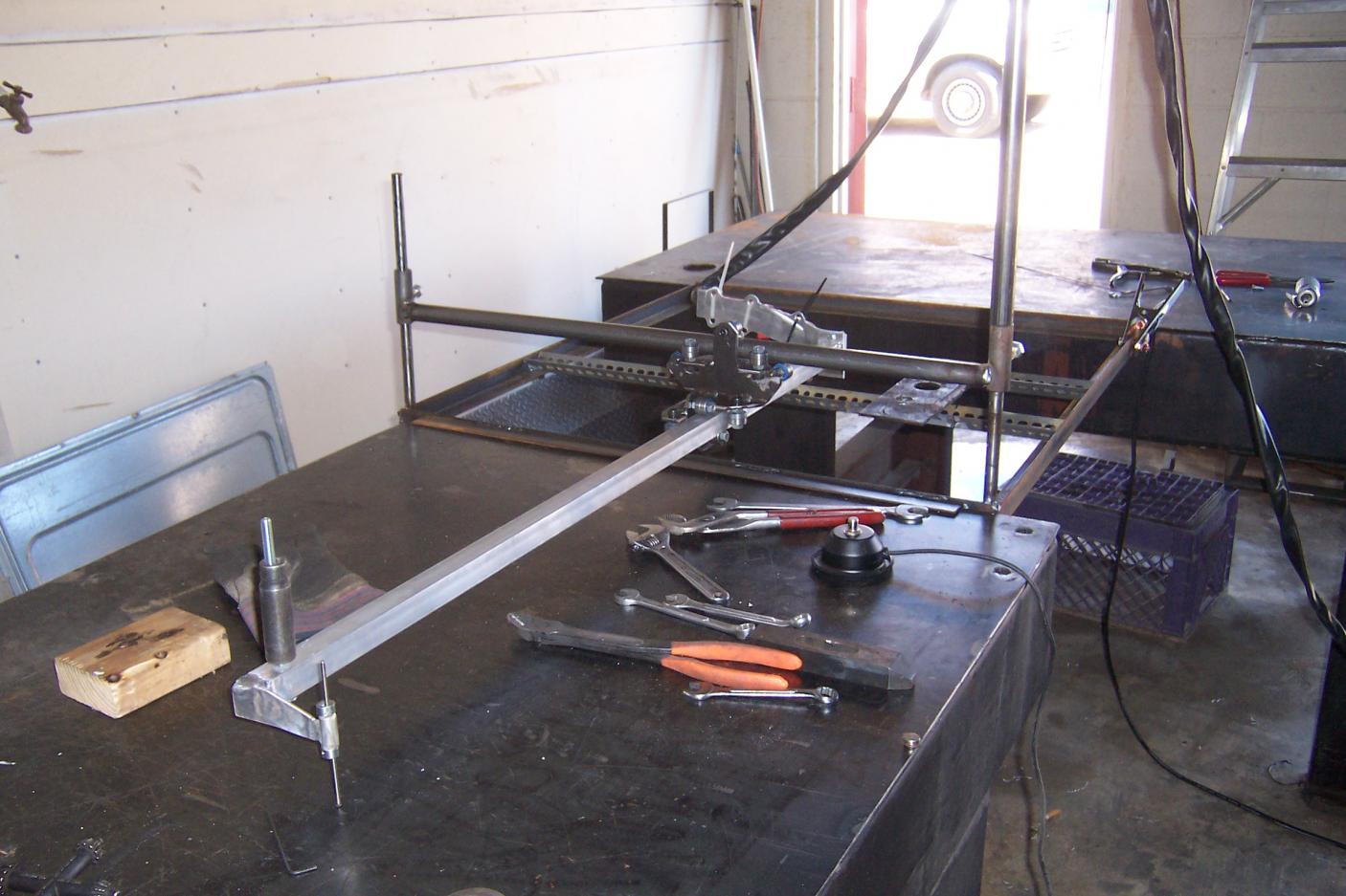

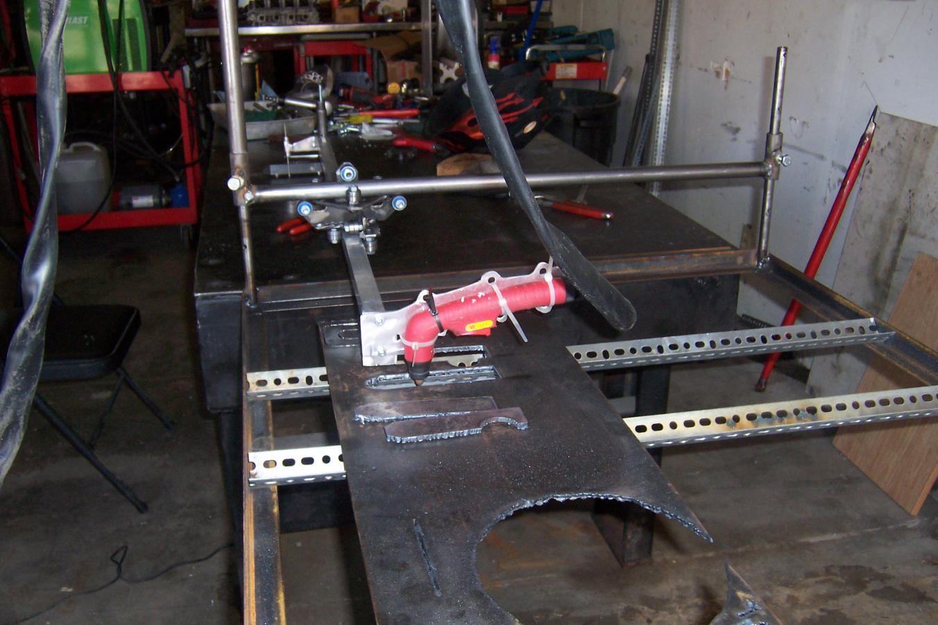

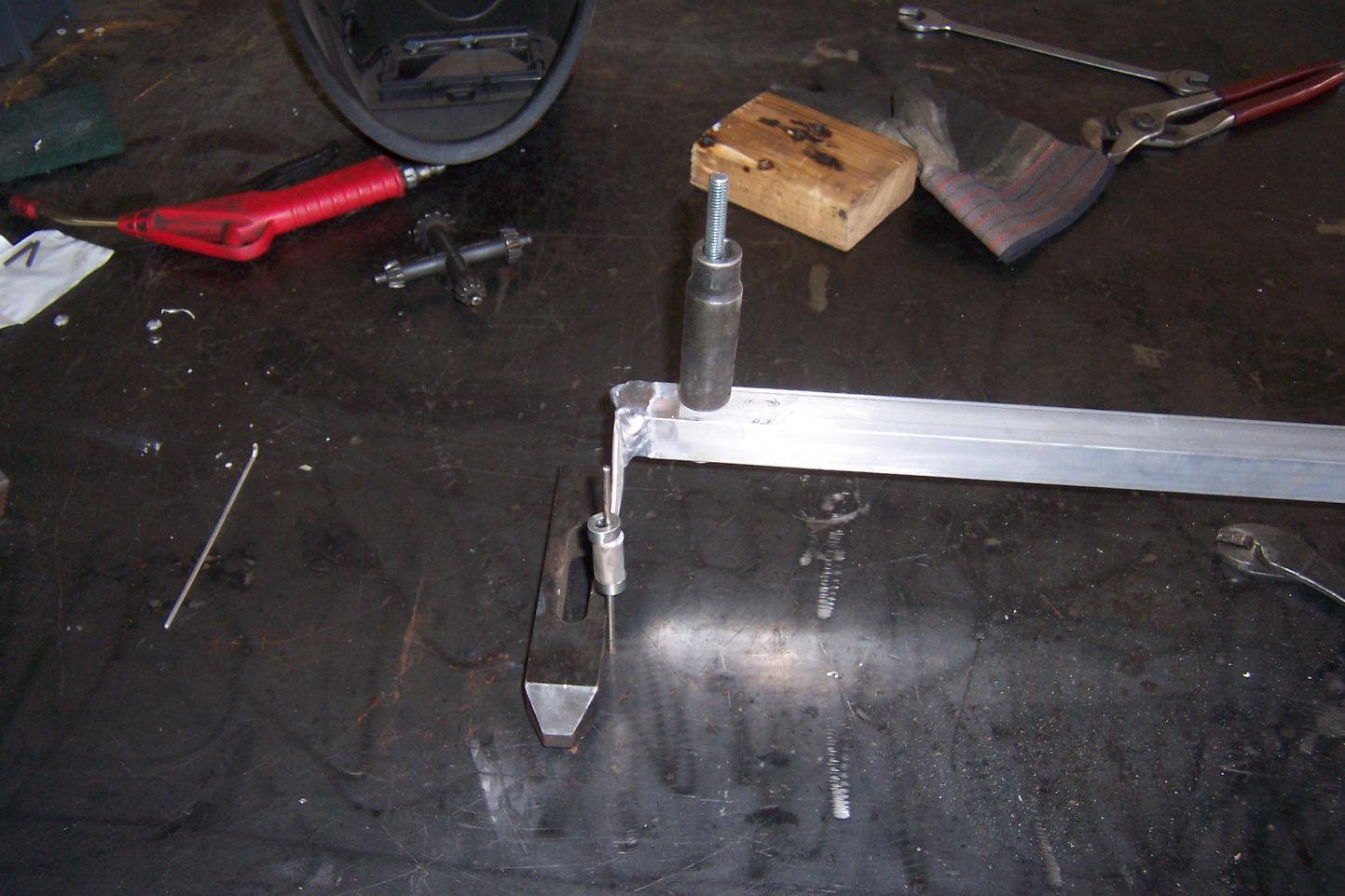

    this is 1/4 plate it is cutting -well got my aluminum i needed and my foot switch . works great all need to do is get a flat piece of plastic to lay what i am tracing on since got darn welding spatter on my table and gouges kept snagging on the stuff while tracing . traced a piece and turned out exactly the same .installed a long bolt at one end as a counter balance weight holder , have some strap steel coming to do the slats for the table . the tracing piece at the end will be replaced with a shaft with a roller ball on the end here is the pics Click image for larger version.

    Oh yeah, that's what it's all about. You've got plenty of range in your setup to trace a very large piece too. Everything working smoothly for you now?
    yes works great only thing i need to do is put a bolt with a nut at each corner of plasma table since my bench's are not level the farthest bench is like 1/4" or more lower than the closer bench in pics . the only thing i wish i did was make it over 48 inches one way so could rip cut 4x8 sheets

    What is the gap height you are cutting? I think you need abigger one to reduce the dross.

    Looks good. Do you think using one of the wire standoffs would work for this to keep your torch at a consistent distance?
