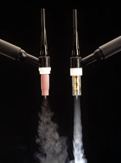

    40% saving in gas, is that over a standard tip or standard lens? Do they really weld better? Worth buying?

    I was wondering what the difference is between the standard lens, gas lens and gas saver lens. I want to order a CK 130 amp torch (like Zoama’s) and don’t know the differences in the lens. Anyone have some explanation?

    From what I have learned the standard lens works, but it has air current ripples that dissipate the gas quicker. The gas lens has a screen (or a couple) that act as a filter to smooth out the air currents so the gas comes out like a straight tube. At least until outside air disrupts it. Seems to work better for extending the tip out to see what you are doing better. Also the gas lens take a different ceramic cup.
    Not sure on the gas saver.

    Brian thanks for the info. I remember seeing the picture on CK's website with the standard lens and gas lens although I thought it was the gas saver.
    PowerPro 205
    9" South Bend Lathe
    Enco Mill/Drill
ID:	7064 this pic shows difference

    Picture is worth a thousand words. Really does answer a lot of questions. Would like to see how the heat from the tungsten arc affects the gas flow, though.

    I am still curious how they got the Argon to smoke like that???

    Where you would run 7 to 8 lpm on a regular collet, you can cut back to about 5 lpm with the gas lens.
    Probably just piped in steam or something for the picture / video marketing spot. Shine a light from one side to light up the particulate.

    I did some research... It looks like it can save you 40% over a standard tip. You just have to remember to turn your gas flow down to compensate for the better coverage a gas save or gas lens will make.
    From what I have found the gas lens, like what I described above, has several screens near the tip of the torch to make the gas flow less turbulent. Now the Gas saver is a little different. It has the screen closer to the top of the torch. It is a little different design to make the flow better. They both tend to use a larger cup so they are tighter to get into corners. That is why they they went with the pyrex cups. so you can see closer into the corner. Kind of a give and take. You need to remember to turn the gas down to see the savings. It looks like you get more of a savings with the saver than the lens, but not a large amount.
    Personally I don't think I will be using the torch that much to make that much of a difference. Heck I am more likely to forget and leave the tank on.

    They all work the same in using a screen to straighten out gas flow, so IMO brand wouldn't make much difference. All I can say with certainty is that the combination I outlined in post #10 works very well.
