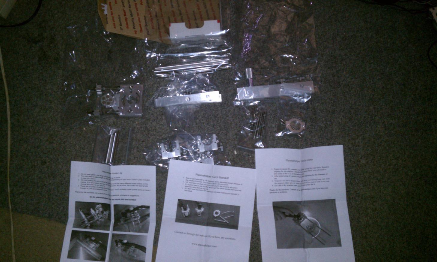

    Well, I bought all three products at plasmahelper.com. I was going to pass on the stand-off, but figured for the price, why not.
    Working with DeWayne was great, all email though. Confusion delayed the order a couple days but not a big deal (email). Make sure you know you torch measurements if you order something.
    Shipping was cheap, $5 range, they pack boxes like Everlast China (there was no room left in that box and no way I could put it back in there after I unpacked it).
    As I unpacked it, it took a couple minutes to match the bags up, but I did not need to call them, but first glance I was going there goes a couple hours.
    The pictures with the instructions for someone of age, did not get it so I went to the website. There, they are big and in color.
    I put the rip tool together first. Very impressed. Went together fast, if the torch locks down (since I had to give him my specs), I am sure I will be happy with it. Design was solid. Looks like I can get down pretty tight.
    The ripper has wing/allen screws. The wings get in the way a little when I went for smaller rip size. I myself would forget the wings and ship an allen wrench in place of them.
    The stand-off. Only as the A81 has issues with the flat containment nozzle, I bought it hoping to make that last longer than the stock wire stand-off. And it was machined and looked nice too. Sure I will use it when teaching kids to cut.
    The Circle cutter. Got it all together, had to look a the pictures online again. Not sure how well the design will work with the A81. The flat nozzle... The S45, WG60/LG and 80, etc will work fine as it's not flat. So I am sure it will well for them. But I will email DeWayne a question on it or just try it and see.
    All good quality, takes a little thought and the online pictures for me to put it all together quickly.
    So far, very happy. Love to rip square tube for channel as I get a lot of it free/cheap.
    All this in that box.. $5 and some change for shipping.

    After I put them together. You see the spare rails and all now. See above bags of parts. Sort of like building a model as a kid.

    OK an update.
    EMS, the Plasmahelper.com stand-off was like $20, so your call on the time vs money. But it had wired and threaded studs you can make whatever height you want. So I am happy here and it was a last minute add to the order. But worth it if you need a stand-off and do not have a mill or drill and the free time.
    The circle guide I thought was going to be a problem.. Same as other Mike. NOT A PROBLEM AT ALL, PERFECT, the ring locks to the nozzle, and you open the bottom forks to hold it. So circle jig was simple. Took some tweaking to get the standoff right though, 10-15 minutes. Picture attached at the end if I remember. Not cutting, but running it on some plates to check clearance. And the pegs scribed the metal so you can see the path. Very nice.
    On the ripper. It fit my one torch, but not the one I bought it for so I can use it. It did not fit the Trafimet A81 hugh neck. It fits all the torches I can name, but not the darn Trafimet A81.
    I emailed DeWayne this weekend. He emailed back today (Sunday) and will have a solution end of this week. Seem Trafimet A81 torch are over achievers on the neck of the torch. There are slots in the clamps on the ripper and I could zip tie it, but I will wait on Harlow Ind. to get back to me on that.

    Yes, it turned out the circle and stand-off work great with the A81 as is/advertised, and any other torch I am pretty sure. On the circle guide I meant to say the nozzle ring rides on top of the forks, you open them so the nozzle drops between them. Ring and forks do the work. See picture above to see the lines the stand-off made. Not and clean.
    The only real issue was the fact I had the A81 trafimet torch, it seems to have a fatter neck than all the other torches.
    He said he had two ideas but would be the end of the week, as they had a lot of commercial (dealer) orders to fill. I can wait for a custom part.
    If I had to wait a couple days, it is probably made in America at his shop. He did not mention the second idea for the clamp, so I might be a beta tester for something it sounded like they were kicking around.
    Either way. All products are safe (well A81/PP60 people in a week). If I ever get time, I will post pictures of results.
