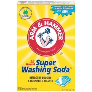

    its like baking soda but stronger safe to use . Click image for larger version.
ID:	6960 you can get it at your local super markets . I use it for getting whites clean when washing close safer than bleach on whites
    its like baking soda but stronger safe to use . you can get it at your local super markets . I use it for getting whites clean when washing close safer than bleach on whites

    Washing soda is sodium carbonate, baking soda is sodium bicarbonate. Washing soda can be found in market among the household cleaners and laundry detergents. It is more caustic (has a higher pH) than baking soda and is pretty aggressive. However I prefer phosphoric acid if you can get it. Driveway cleaners made for removing rust stains from concrete contain phosphoric acid. So does Naval Jelly. Best if you can heat it while derusting. It leaves a flat gray-ish colored iron phosphate deposit that is a good surface for accepting a primer coat if you want to paint over it.
