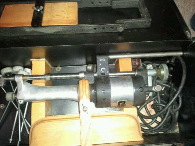

    Biding on this tool on ebay what is it . I know its a reallyClick image for larger version.
ID:	7066 cool tool for car engines
    is it for honing cylinders. it looks like a miniature line boring machine.
ID:	7067its a tool Winona van Norman use to make made . its a tool to regrind crankshaft rod journals in the car but can be mounted on a lathe with a mounting bracket made by van norman ,

    How does it get all the way around the rod journal with the crank still in the engine and doesn't it sling abrasive and metal chips everywhere inside the block ?
    I was thinking the same thing. If it leaves a lot of metal inside the engine wouldn't you have to tear it apart to clean it??? I always have a rough time keeping thing meticulously clean. I have to keep my son from sweeping the floor when engines are open. He is a clean soul!!!!

    the one end is open and spring loaded you hook it over the journal it has rollers on the end that hangs on crank then there is a knob that adjust it up to touch crank when grinding . it has micrometer readings to see how much you are removing .they had to set ups to turn engine over when grinding it was a electric motor with a small pull with belt you ran on the lower crankshaft pulley also had to pull all the spark plugs so no drag when turning over engine . i have used one once way back when it worked good . as for stuff in engine after done would wash inside of engine block with engine cleaner and wipe down till rag was clean . I have another way i am going to use the tool , i am going to make my lathe table flip up so lathe is on its side . so then can chuck crank shaft in lathe and use crank grinder out of the car . My shop specializes in 4 banger engines so a 4 cylinder crank is small and would fit in my lathe . also would make a rail on the lathe table to mount the tool side bracket . if it was a stick there was a motor assy that turned the rear tire with in gear to turn engine over . Click image for larger version.
