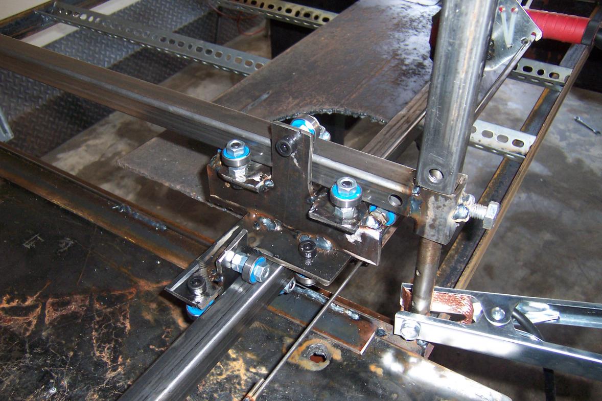

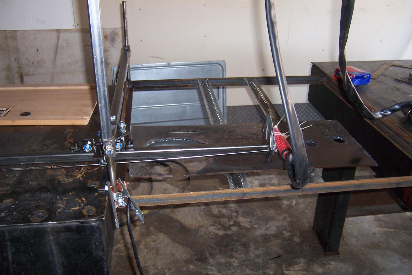

Well got it up and working works good just need to wait fro my foot pedal switch to turn torch on and off , Also going to change the long box arm to aluminum so lighter the the feed rail is fine since is stationary . need to make tracing pen part aluminum since sticks to my work i am tracing since held in place by magnets and the metal pen sticks to the magnetized work. Click image for larger version.
