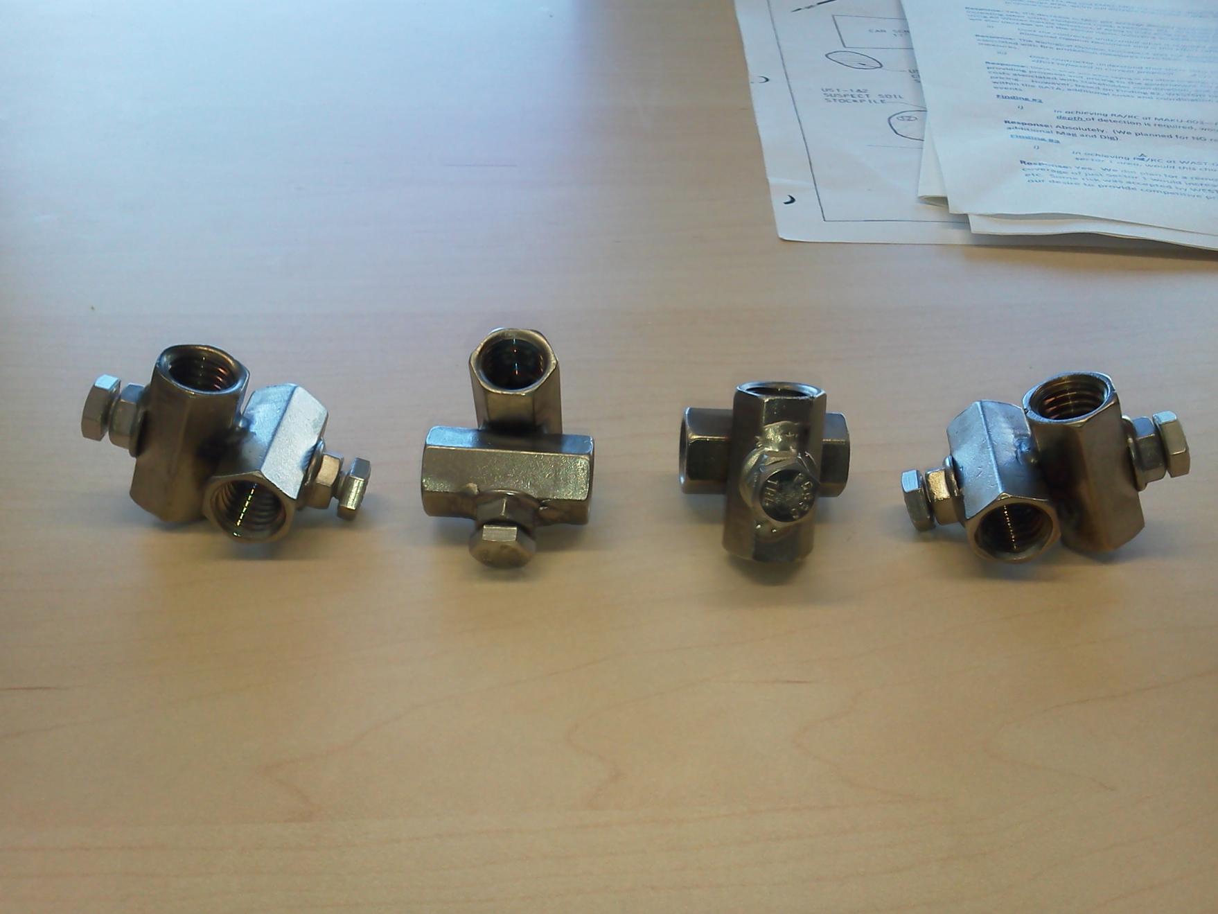

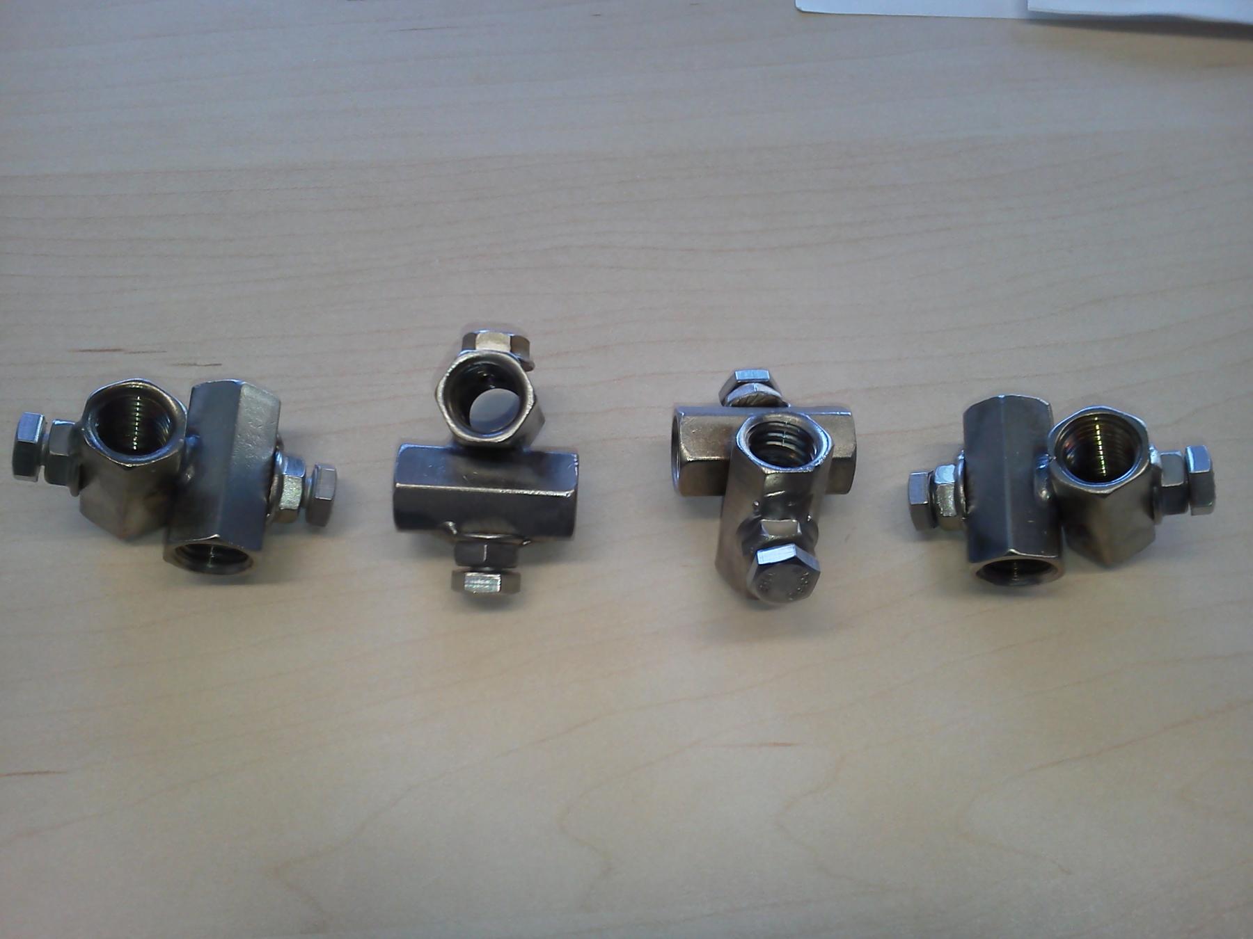

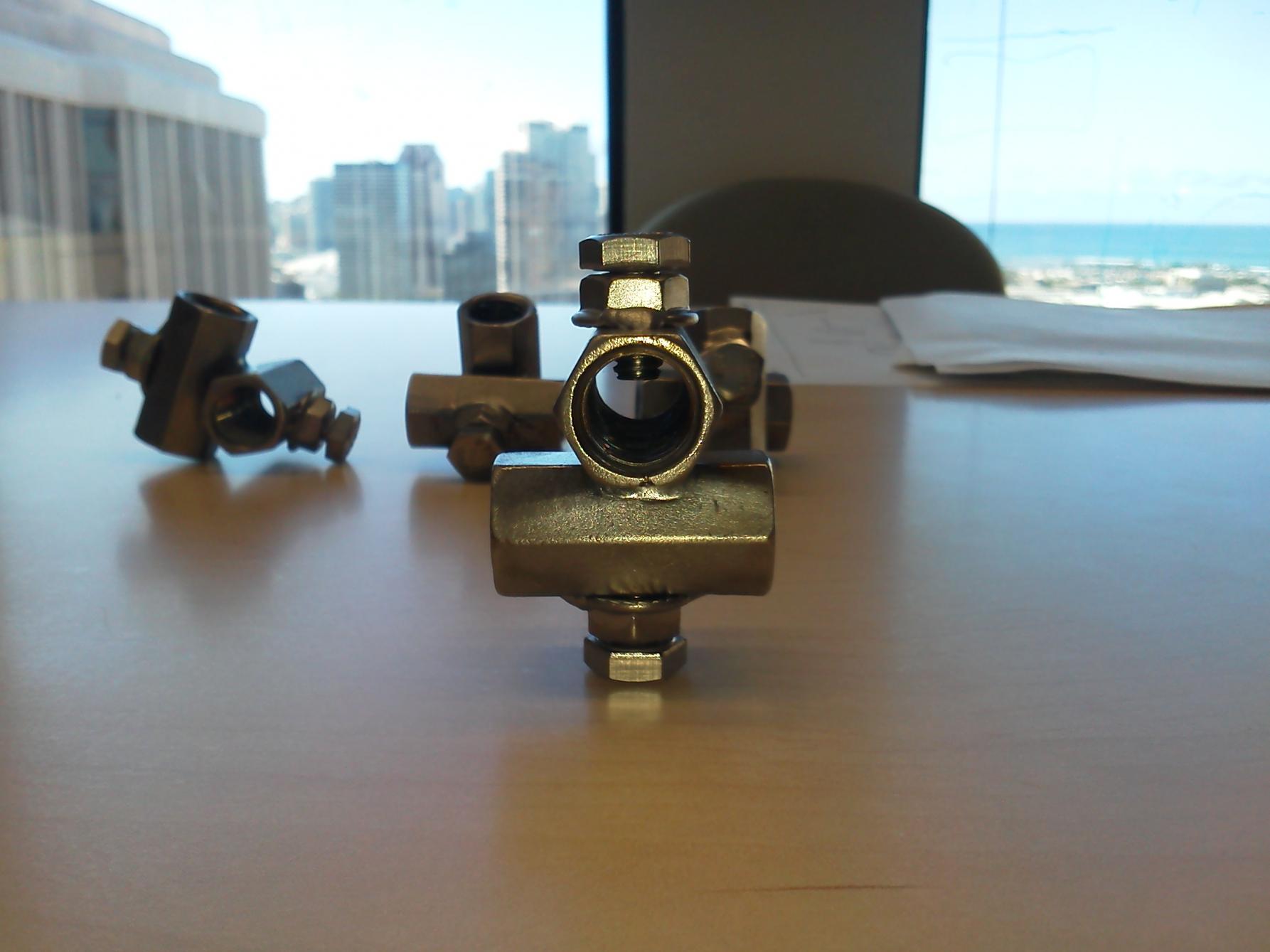

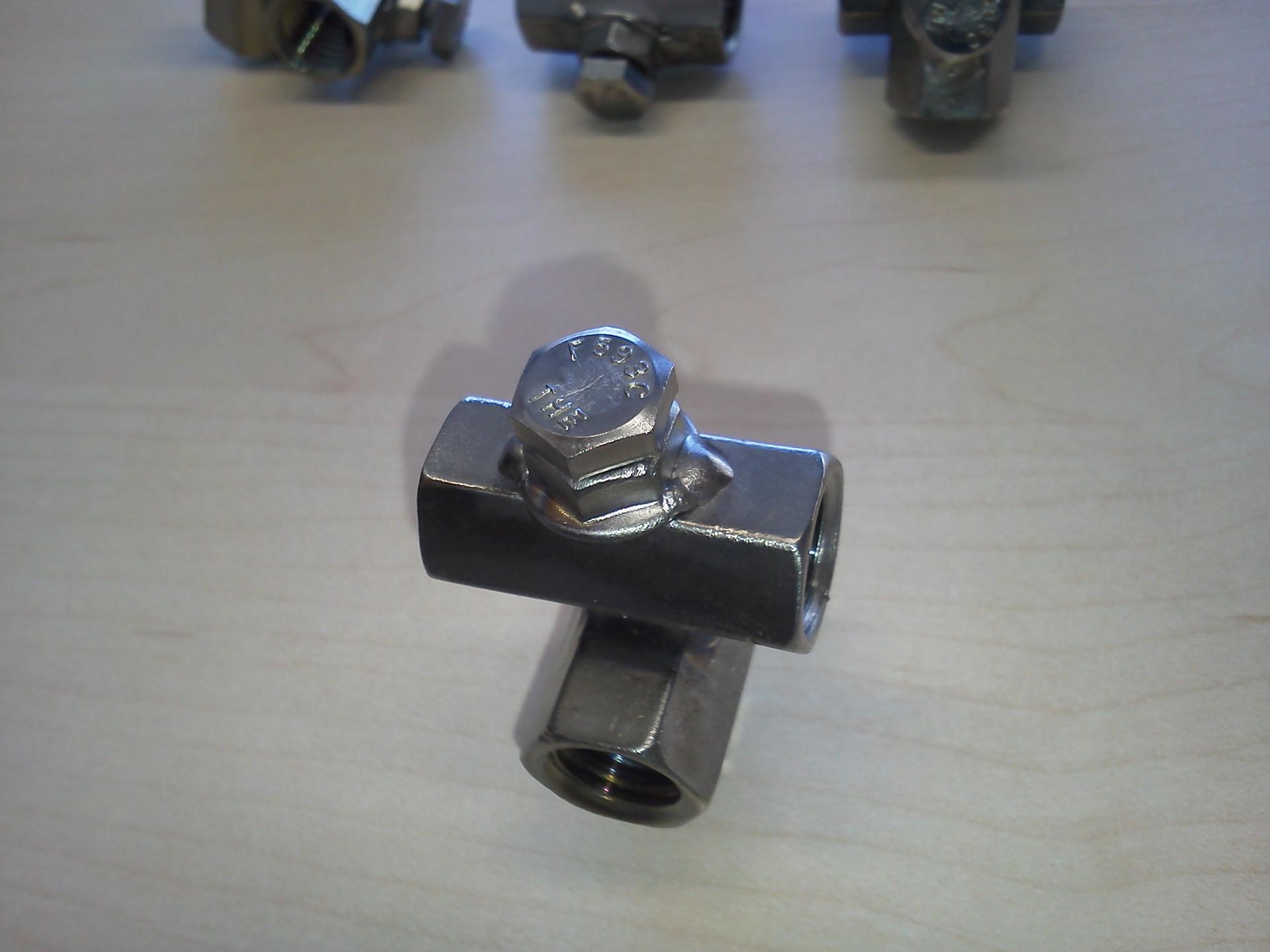

    Here are the clamps (10) I made that needed to have nuts welded onto the flat side of some coupling nuts. It was easier than I thought but I think I should have moved the puddle into the nut a little more. After using the supplied torch for this I REALLY want the CK 130.
