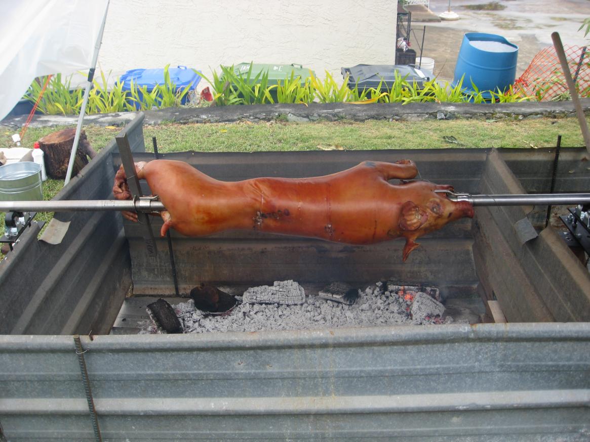

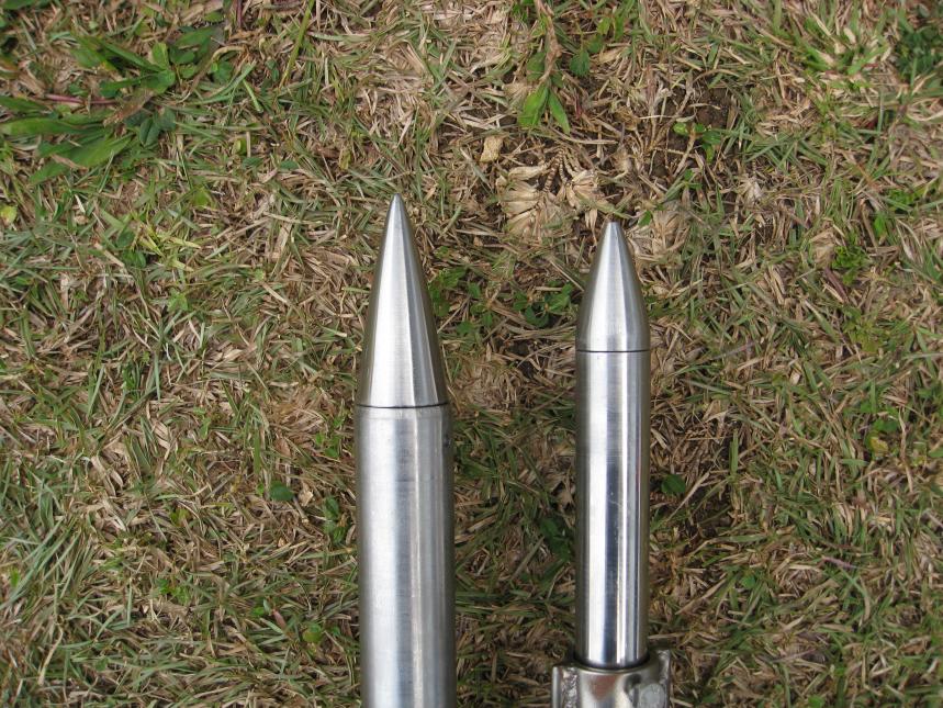

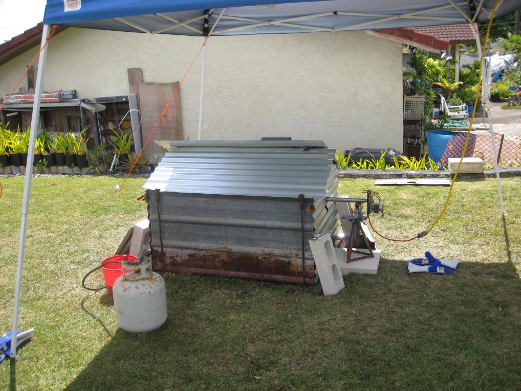

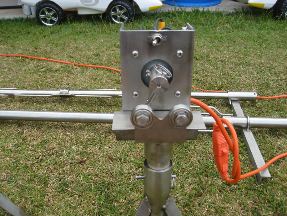

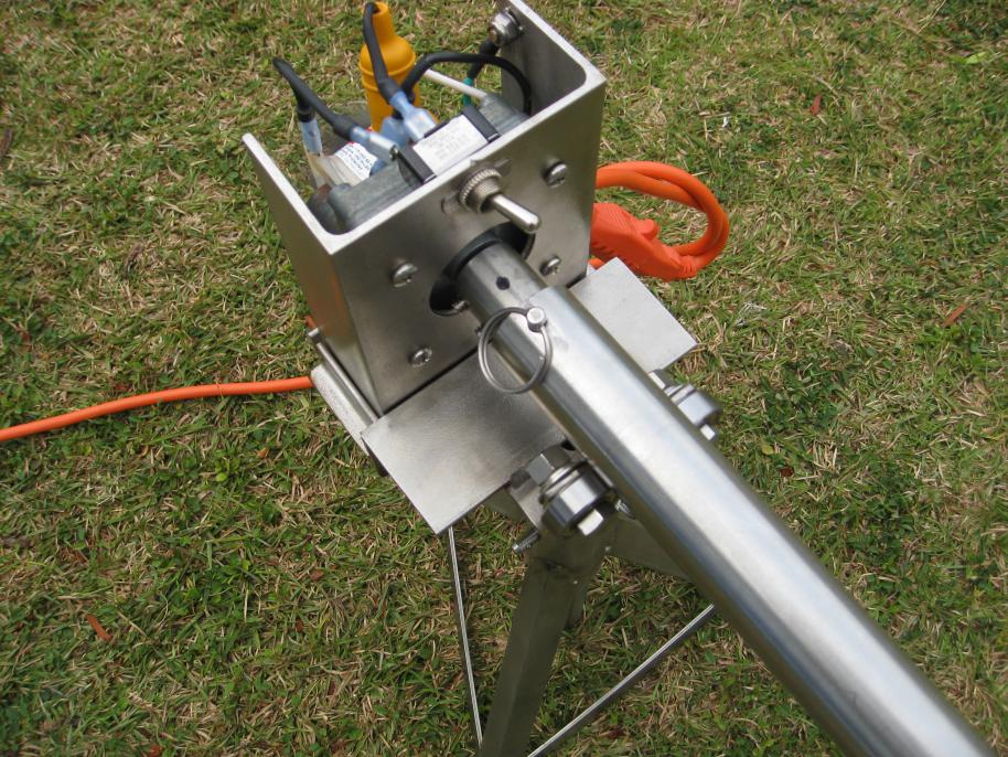

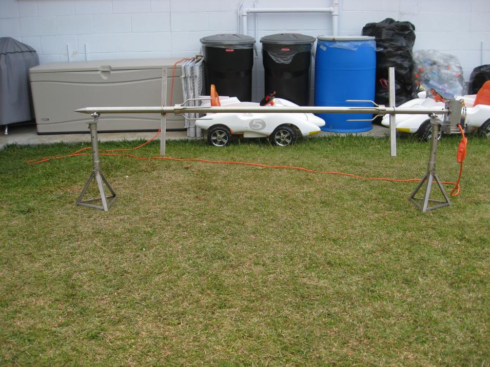

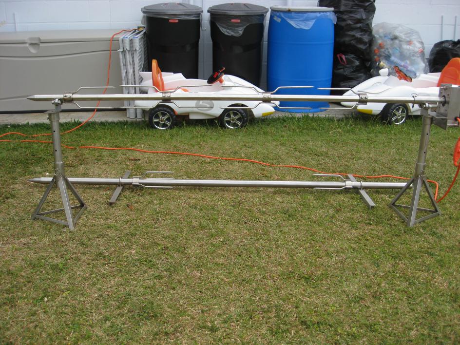

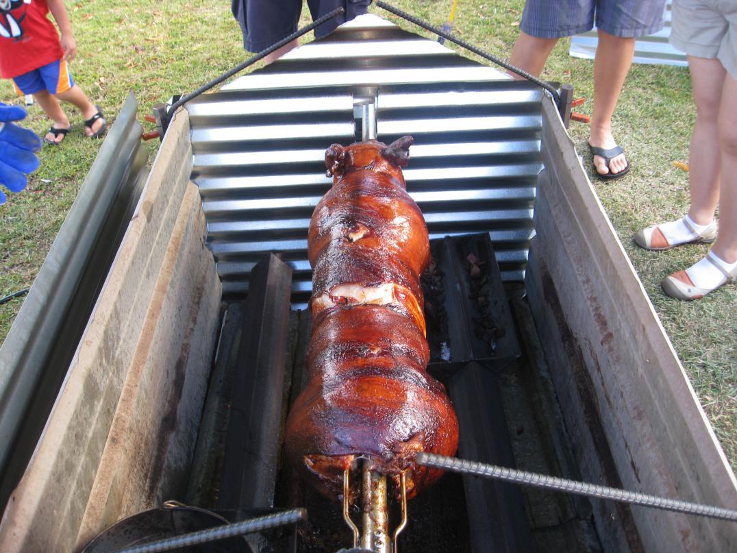

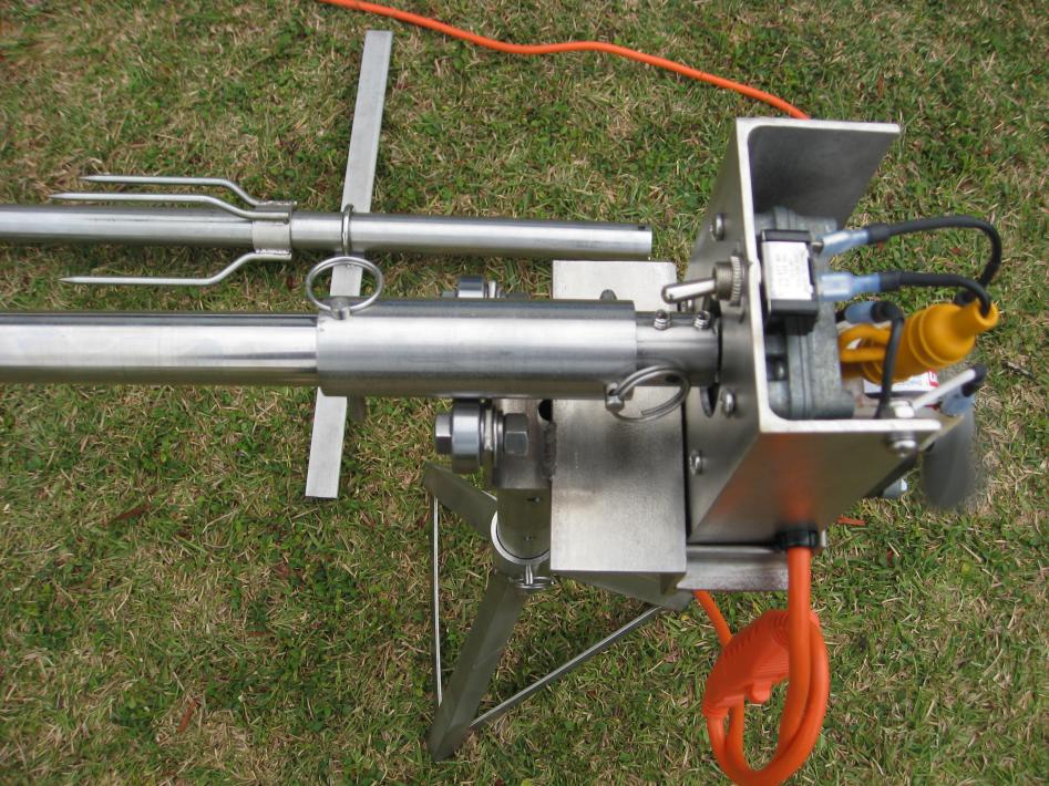

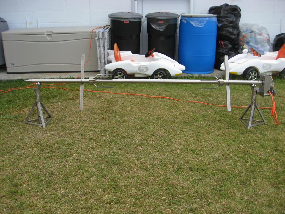

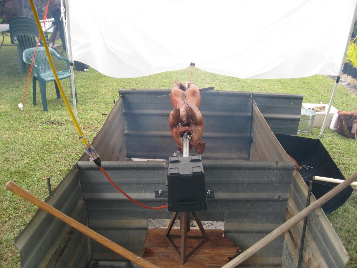

    Here is my huli huli (huli means to turn/rotate/flip in Hawaiian) setup I have been working on for a while. It has come a long way from the first one I made. I use the large spit to cook pigs (40-65 lbs) and the small spit to cook chickens/roasts. The setup is corrugated metal around the spit and the meat rotates in the center. I use kiawe (mesquite) wood or propane just depends what I have on hand. The stands are adjustable from 12” – 24” and I use cinder blocks under the stands.

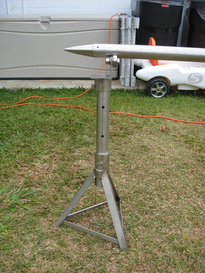

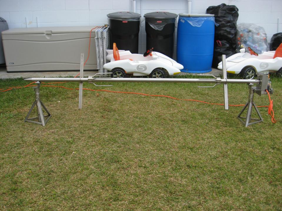

    Pics 1-4 Pig rod, adjustable stands, and the motor,
    Pics 5&6 the Chicken spit and coupler,

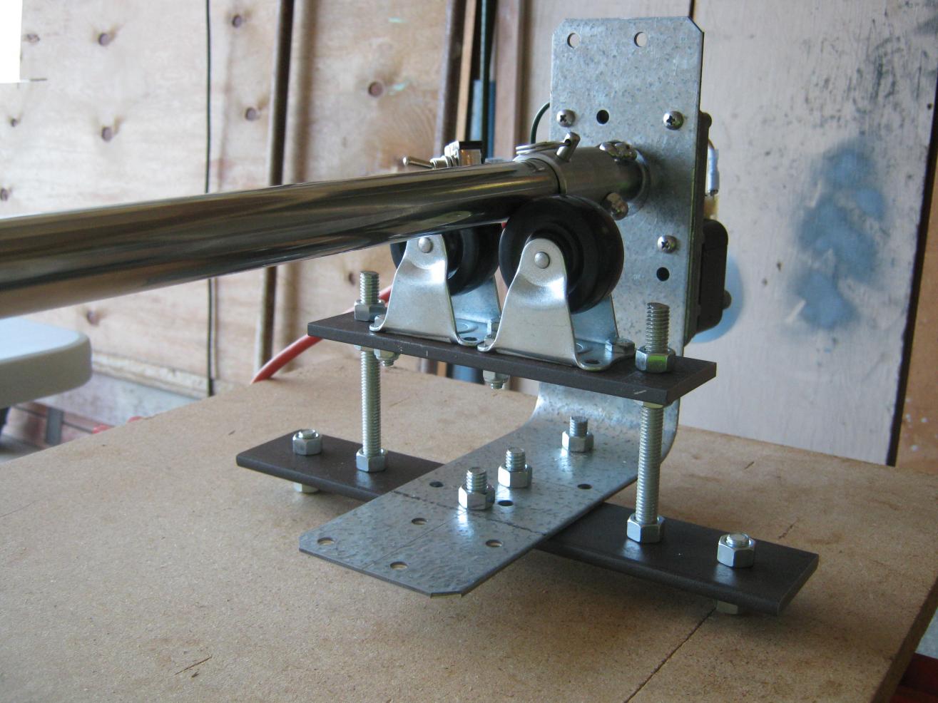

    Pic 7 Motor in the stand
    Pic 8 Spit tips

    Hopefully I will get to huli huli a pig on July 4th and again on the wife’s birthday (happy wife, happy life!).

    That's a fine looking rig you've got... I thought Hawaiians cook em in the ground with banana leaves and hot rocks.

    Oh yeah .... now I'm REALLY getting hungry (in my neck of the woods, it's lunch time now so double threat here) I can see why you mentioned you might want to make the base of the stands wider. Let's us know how they hold up. You can always weld the current stands to a wider plate or weld tabs on the feet of the current base to bolt them onto the cinder blocks(?)
    Nice to see it all together and set up - ready to go!

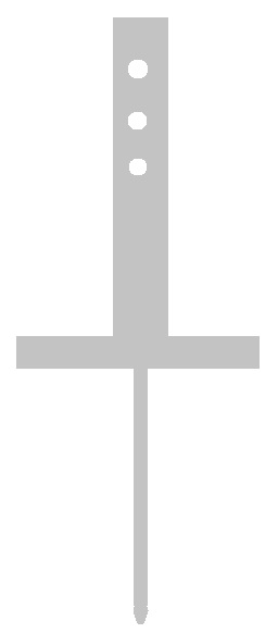

    You could make an extra set of bases with a spike on the bottom so that you wouldn't need the blocks. Click image for larger version.

    Nice setup! It looks like that will hold a pretty big hog.

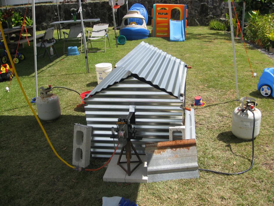

    Ah, but maybe the cinder blocks are also to raise everything up so that larger pieces of meat can be cooked!
    Thurmond kiawe cooking is great, from the meat to how the house smells two days after.
    Zoama/Undercut the cinder blocks are to raise the stands but more importantly the provide a level surface. Once I deciede where the dedicated cooking area will be in the yard I might use a setup like Zoama suggested.

    That's the purpose of the holes... pull the pins and raise the upper half to the desired hight.

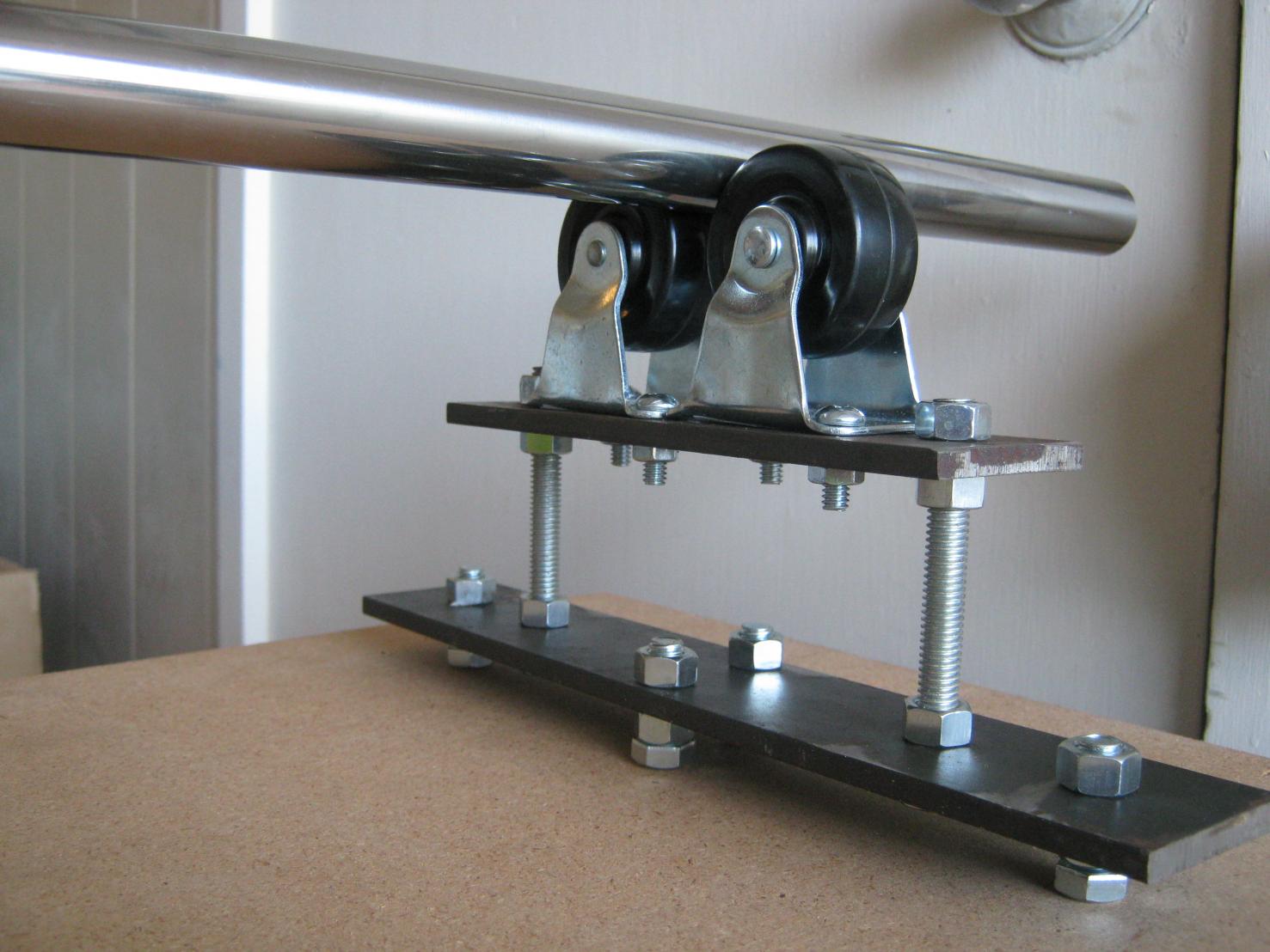

    Pics 1 & 2 are of version 1 before I had a welder and could weld.

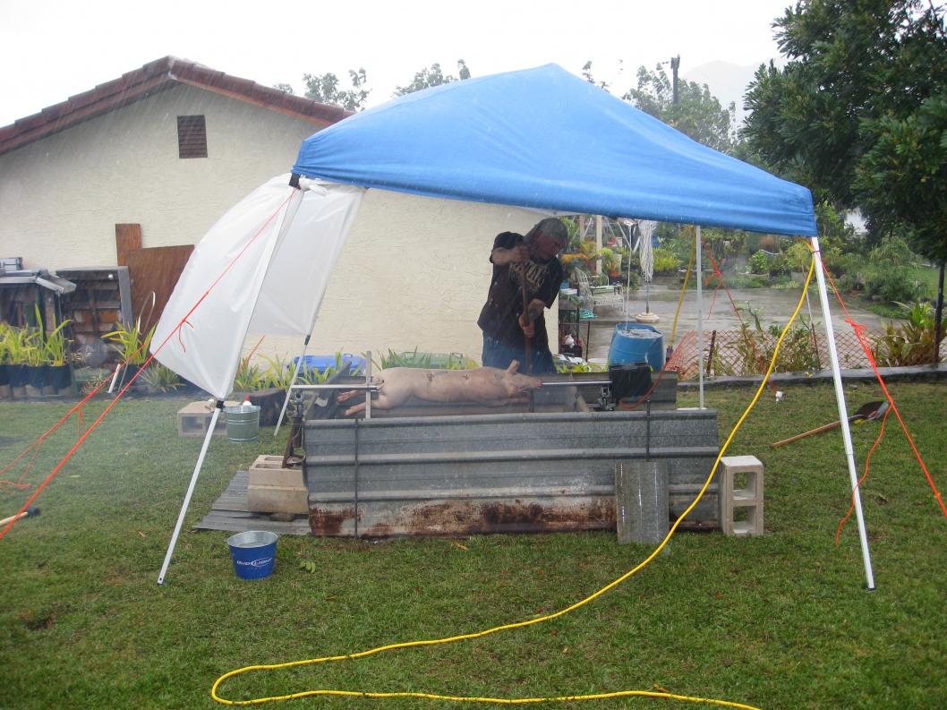

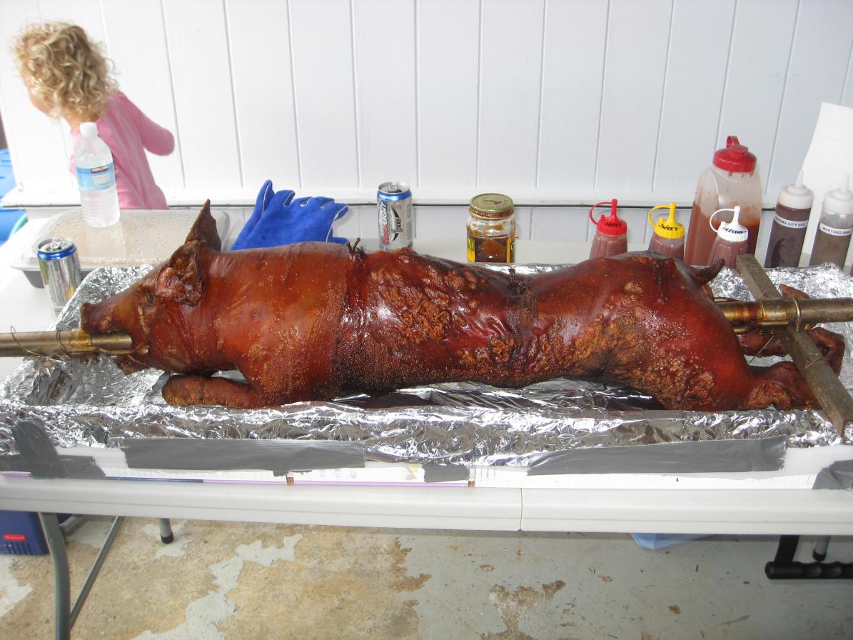

    Pics 3 – 6 is the first roast using Kiawe wood, using version 1. That’s my buddy Fred in pic 3 and that day it was pouring rain that’s why I had to put the box over the motor.

    Pics 7 – 9 is the second roast using propane, a new corrugated metal setup and version 1.

    ...so I had to learn how to weld.
    A great story! Learn to weld to create the perfect barbecue, I like it.
    Thanks for posting the "embarassing" pics, too. I like the idea of inverted casters to work as the shaft bearings, I'll definitely store that away for future use.
    How long does it take to cook a whole pig?
    Bolting everything together was such a PIA and bulky when I was done. Version 1 did work and everybody was happy (including myself) with the way the pig turned out. The inverted casters are such an easy way to doing things my only concern was the plastic/rubber wheels melting. I have seen others that use metal wheels.
    Cooking time is usually 1 hour for every 10lbs so the first pig was 44lbs and took about 5 hours and the second was 60lbs and took about 6.5 hours. The key I’m told, is to keep the temp between 200°F - 250°F and optimum is 225°F. The last 30min or so drop the pig down too really crisp up the skin. Let it rest for 15min - 20min then start carving. When it’s done I like to get one of the crispy pig ears ……….sooooo gooood with beer.
