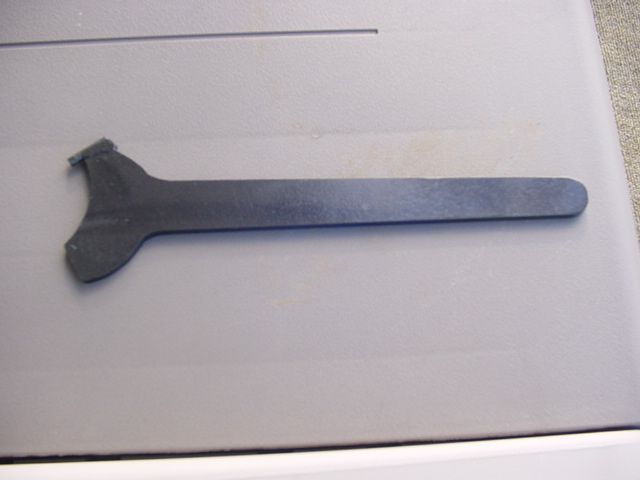

    make your own i did out of some 1 inch pieces of steel and use steel bushing from the hard store to have drill bit fit tight in hole. I make a lot of my own tools at my shop. need a wrench to do carrier bearing preload on a 14 bolt gm rear end wrench was 140 buck made it myself only cost like 3 bucks me making it . cant believe that much fro this wrench Click image for larger version.

    You know, Rod, you could probably write an entire book about all of the tools you have either created from scratch, improved upon, or replicated ....
